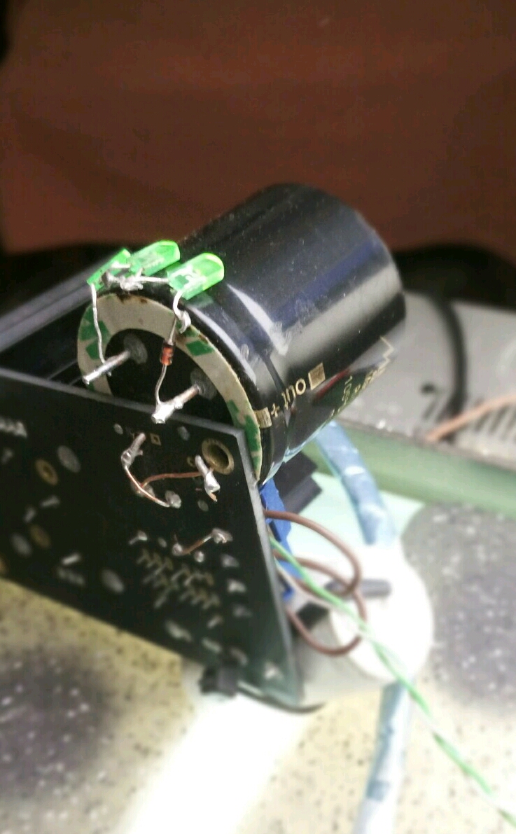

Leds were placed IN to IN, when I found (turning down the 1R wirewound pot.) the best value for R1, the bass, become a true wooden cello instrument, with same focus, air and everything found on any of the others upfront instruments.
It is time to try leds OUT to OUT.
I think remember, I did'nt notice anything in first, It was only when turned back to IN to IN, when I notice an evident downgrade. Not saying that anything is sounding bad, just ... boring! I wants return again OUT to OUT! It was enough! how to tell... less dark... more... tactile!
I was not hesitant, but repeat one time more, just for you to confirm.

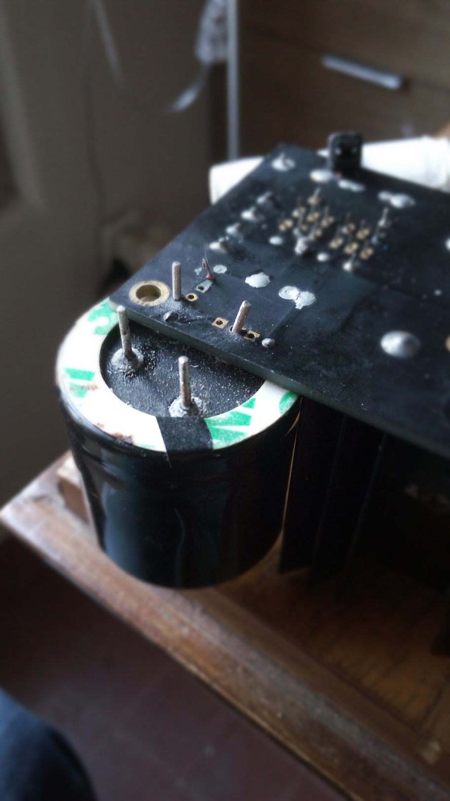

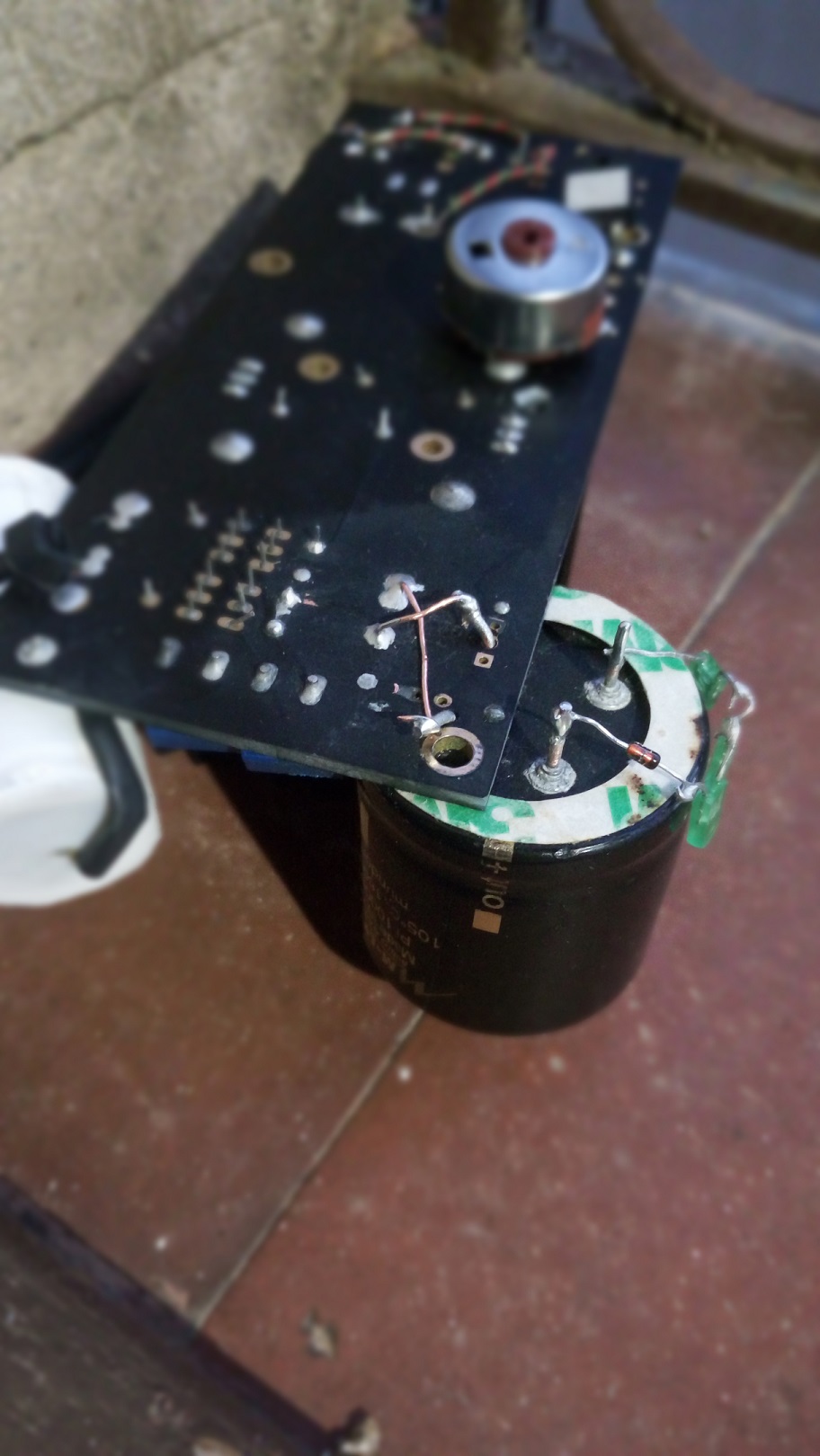

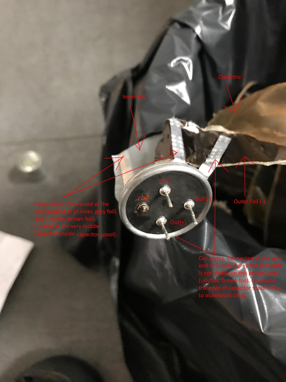

Today I place the Mundorf 4 pin properly on the board, my leds wiring, please see pics bellow, go from capacitor pins OUT+ to OUT-.
Now again music on play, it works like a charm, I strongly believe that expense in C2, is well rewarded, the quality performed is far, far beyond any of my expectations.

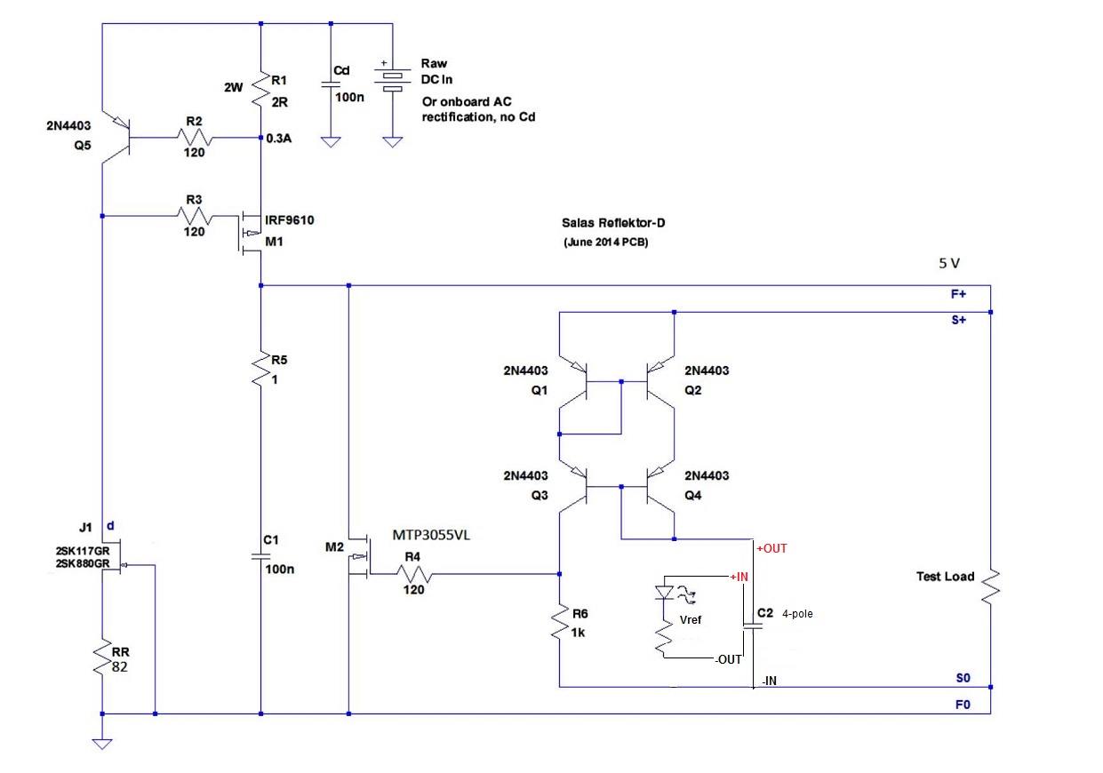

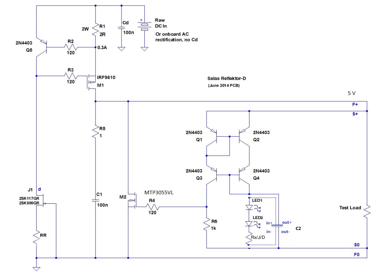

So you're saying:
Out+/- >> In +/- (image 1) >> In+/Out- (image2) ?
