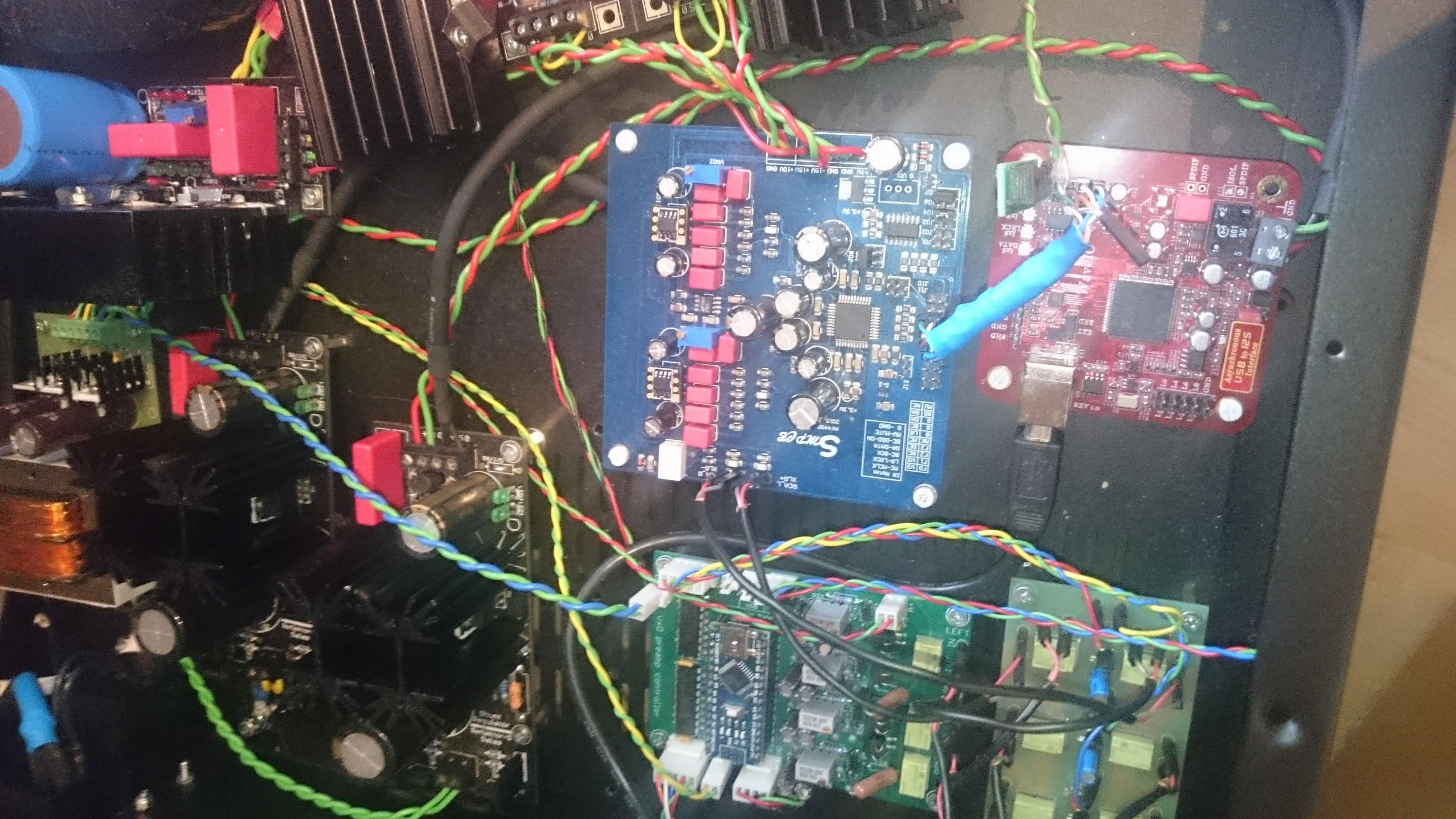

hi ... i have used a ref-d to power my waveio board. Problem is, with remote sensing i only get 4vdc. I checked the ref-d with a 20R dummy load and it outputs 5vdc nicely. Wire length is about 25cm ( quite long, but i couldn't find a shorter way to do it ;-) ) For sense wire i used a shielded cable as suggested. Force wires are awg 18.
Any ideas where i could have gone wrong? Is the wire simply too long? Would love to hear you oppinions. Attached is a picture of my build. Will try to make a nicer one soon
Any ideas where i could have gone wrong? Is the wire simply too long? Would love to hear you oppinions. Attached is a picture of my build. Will try to make a nicer one soon![]()
If your voltage is dropping then possibly your device is drawing more current that you predicted. Try 1R resistor (600mA) and see if this works.
Thanks for the reply Tio. I am using 1R resistor already, and have powered the waveio board with the ref-d before successfully. Maybe it draws more current in I2S mode 😕 .Will try bridged mode tomorrow and see if that makes any difference.
Try to short f and s to ground right on the ref d board then. I used to have similar problem with long kelvins in salas bib -/+. With kelvin I got higher voltage indifference than I got from shortening f and s to grounds right on the board.

yep, did that and the bridged mode works. I assumed ~20cm length and a shielded wire should work but apparently not ;-) anyway, got my targeted voltage but the waveio still isn't working *lol* well, i guess some more stuff to figure out is also a way to spend my time ;-)
There are two ways to miss some voltage. One is to eventually load it heavier than your load thought would be and it needs higher CCS setting, or oscillation does that. It depends on the load characteristics, sometimes it won't take remote well. Solutions are to try it with more CCS and/or without remote in two wire mode. As you did.
Yeah, it works flawlessly in 2 wire mode. I'm sorry to say I have no way to check for oscillation, but that's probably the problem. Will have to get an oscilloscope sooner or later 🙂
