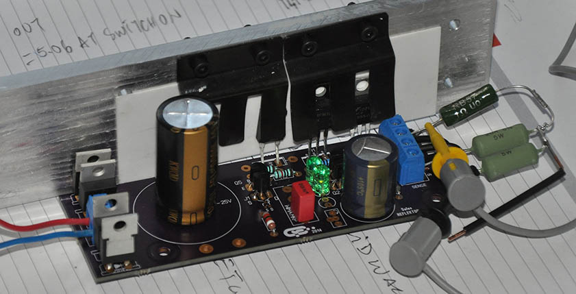

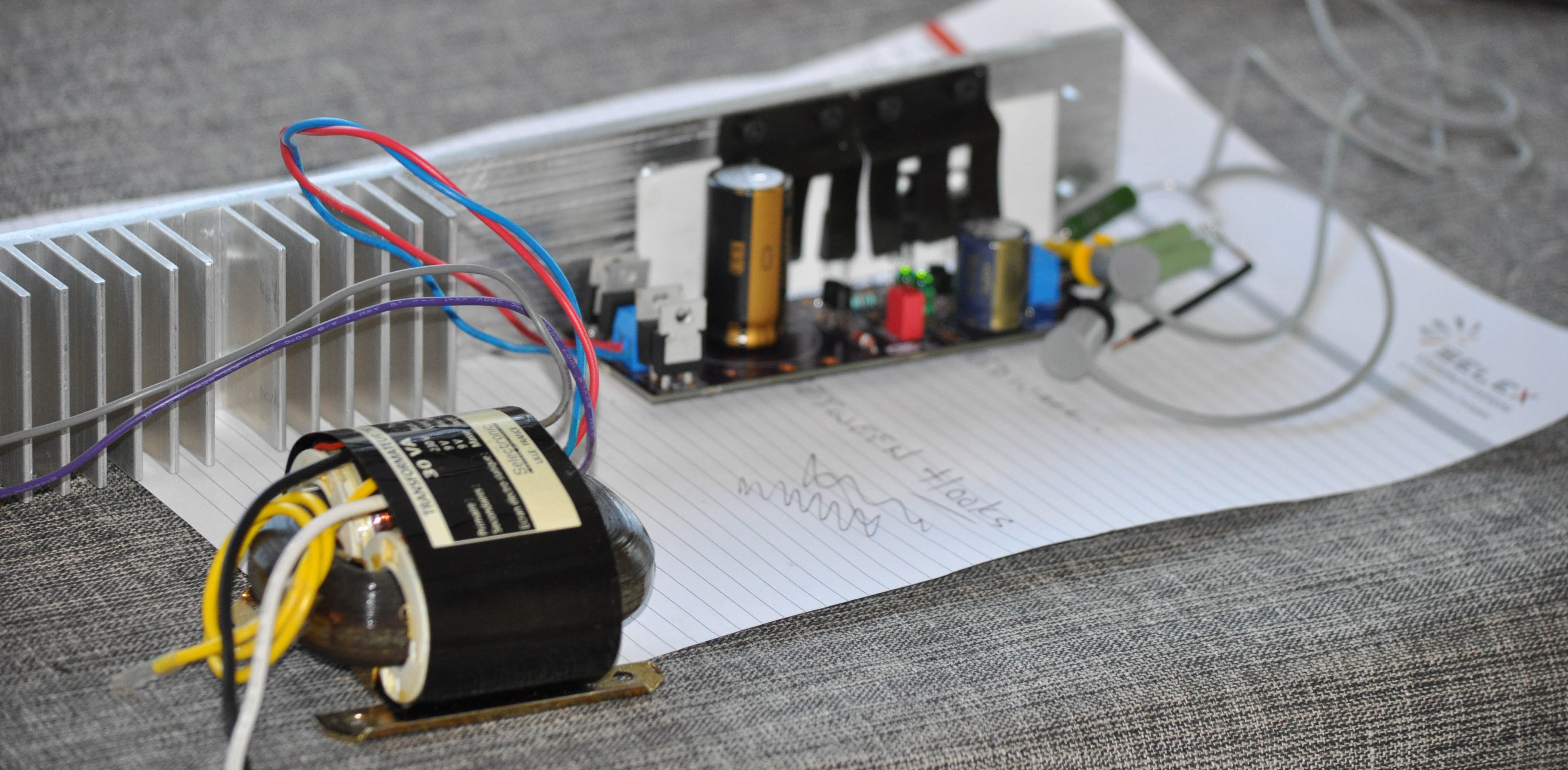

Ok here goes my first test:
I made my own PCBs for this one because i needed power transistors on the side and because i needed a more compact layout.
2SK117 GR - idss 5.1mA
R1 - 1ohm Caddock MP915
RR - 82 ohms
Filter cap - 10000/16V Nichicon
2 green leds ( 1.90V each )
Rectifiers - MUR 820
Transformer - Selectronic R core 230V primary, 9+9 secondaries.
measurements with load:
Load - 11 R ....for 450 ma load current.
AC in - 11V
DC at Filter cap - 12.3 V
Output - 5.06V at switch on, 4.99V after 10 minutes, 5.00 V after 45 minutes
So i guess it is stable after 10 min!
Heatsink - just a little warm.

Those Selectronic are always happier for secondary than nominal. But no big deal when on external sinking. Drift is very small. Success.
