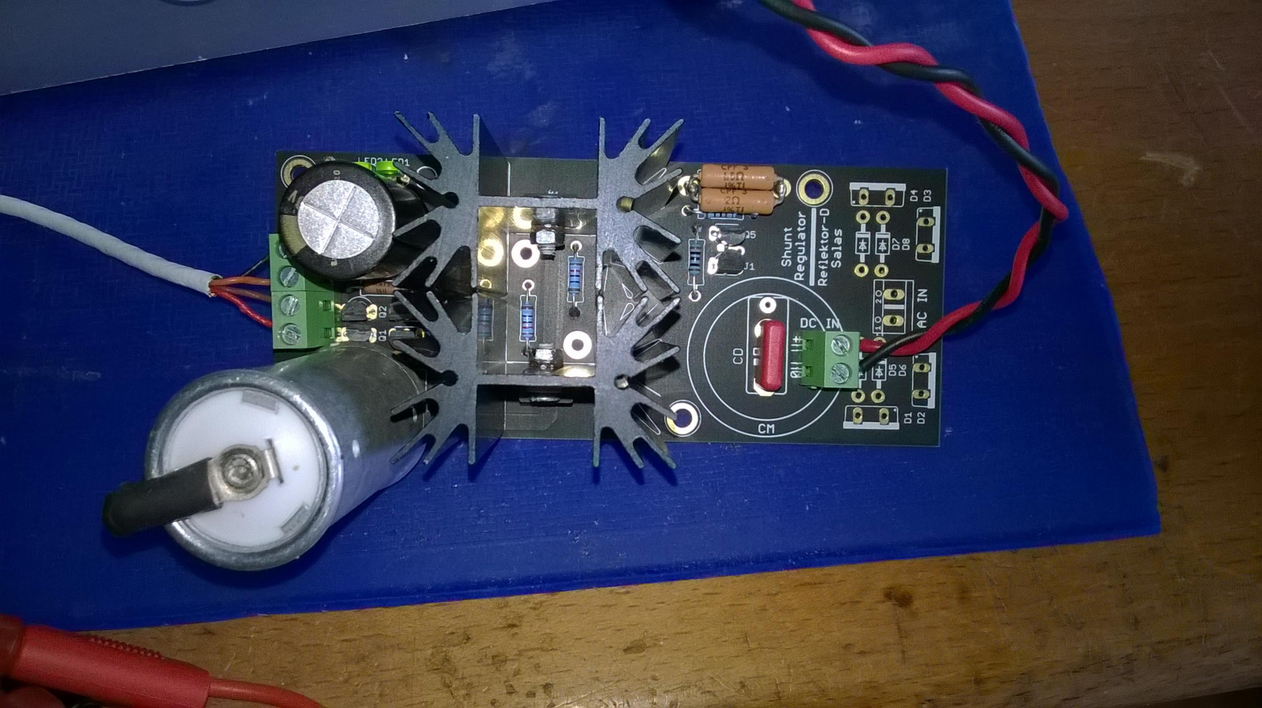

Attached pics.
Matte black does not glare when shooting a photo.🙂
FT-3 CCCP cap doubles as a side-sink to aid cooling.😀

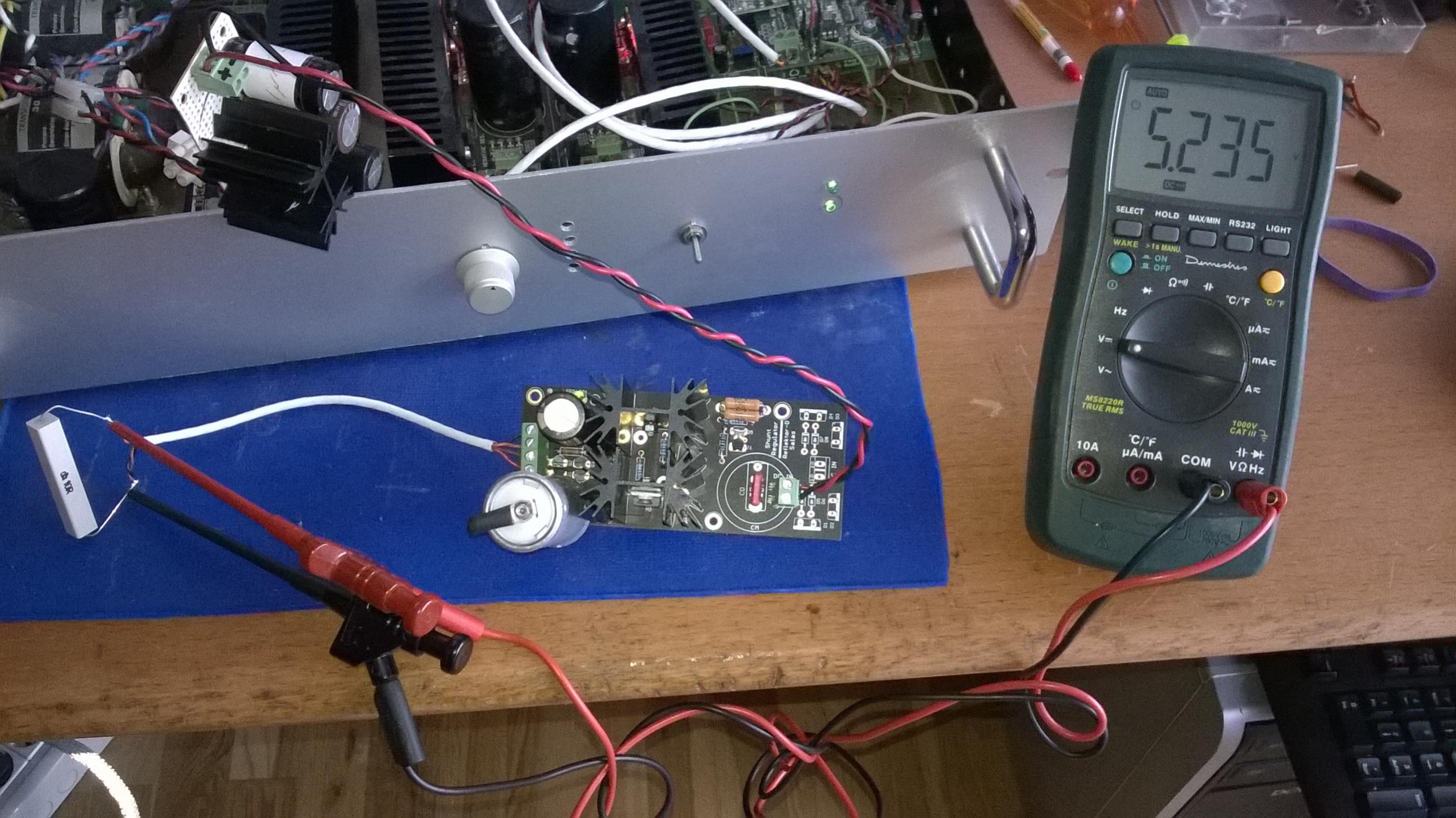

9V battery & 3K3? I don't know if needs exactly 5.25V but is the only value write in the manual pdf.
BIII needs 5.25 V optimum recomended , absolute max is 5.5V but will work at 5V as well.
