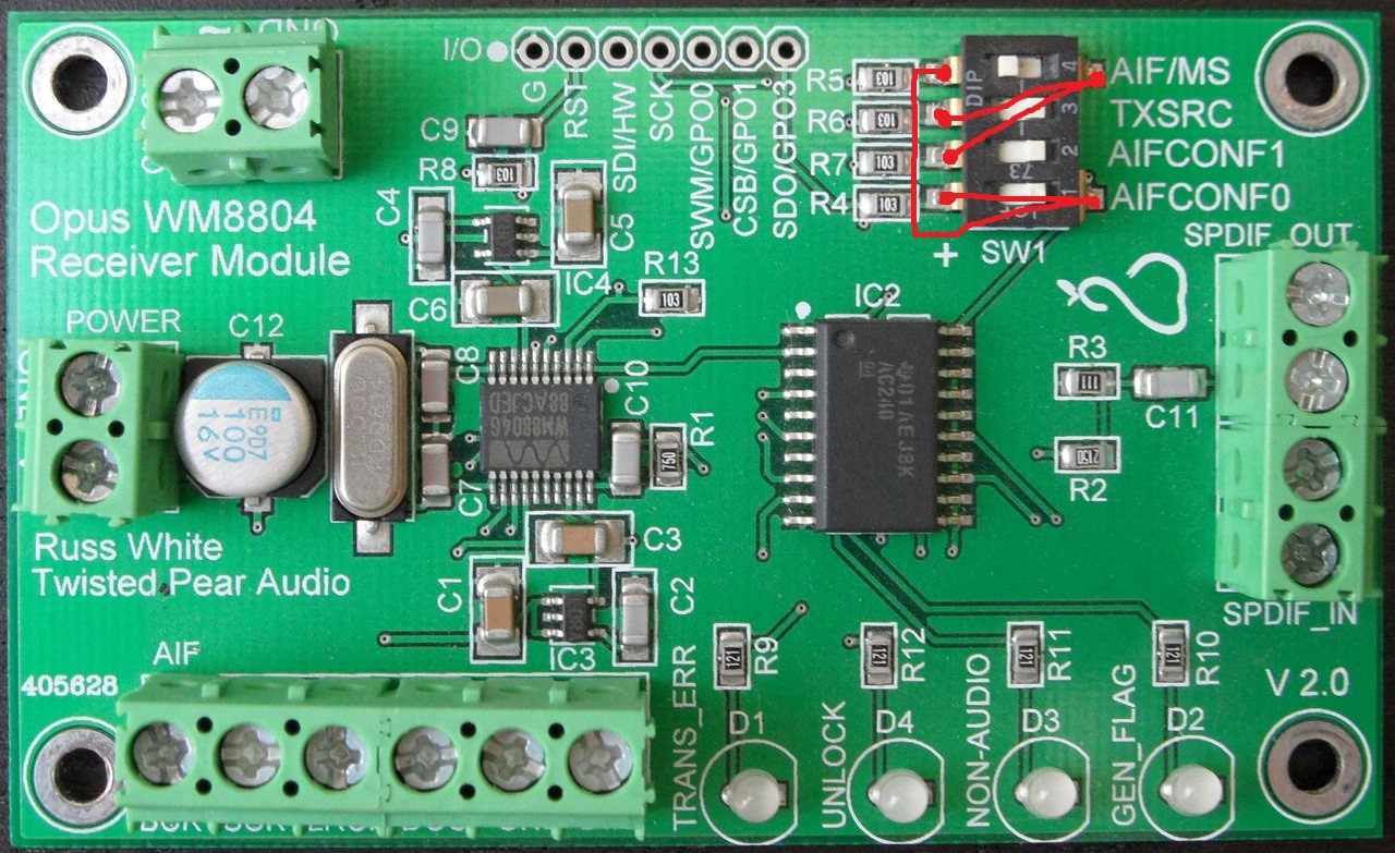

hello again,
a question most likely to Oliver or anybody who's used twistedpearaudio's spdif receiver.
I'm unable to find the tristate dip switch and according to the manual and Oliver's post here it should have AIF/MS turned on.
Frankly speaking I didn't get the idea how the damn switch works from the manual. Could anyone please assist, should it be wired as on the pic below?

hello again,
The DIP switch config on your photo is correct. Witch Red Baron version did you have?
thanks! It's v3.0 configured to 3.3v and almost ready now, just need to solder the pins of spdif receiver and add 4 i2s lines.
