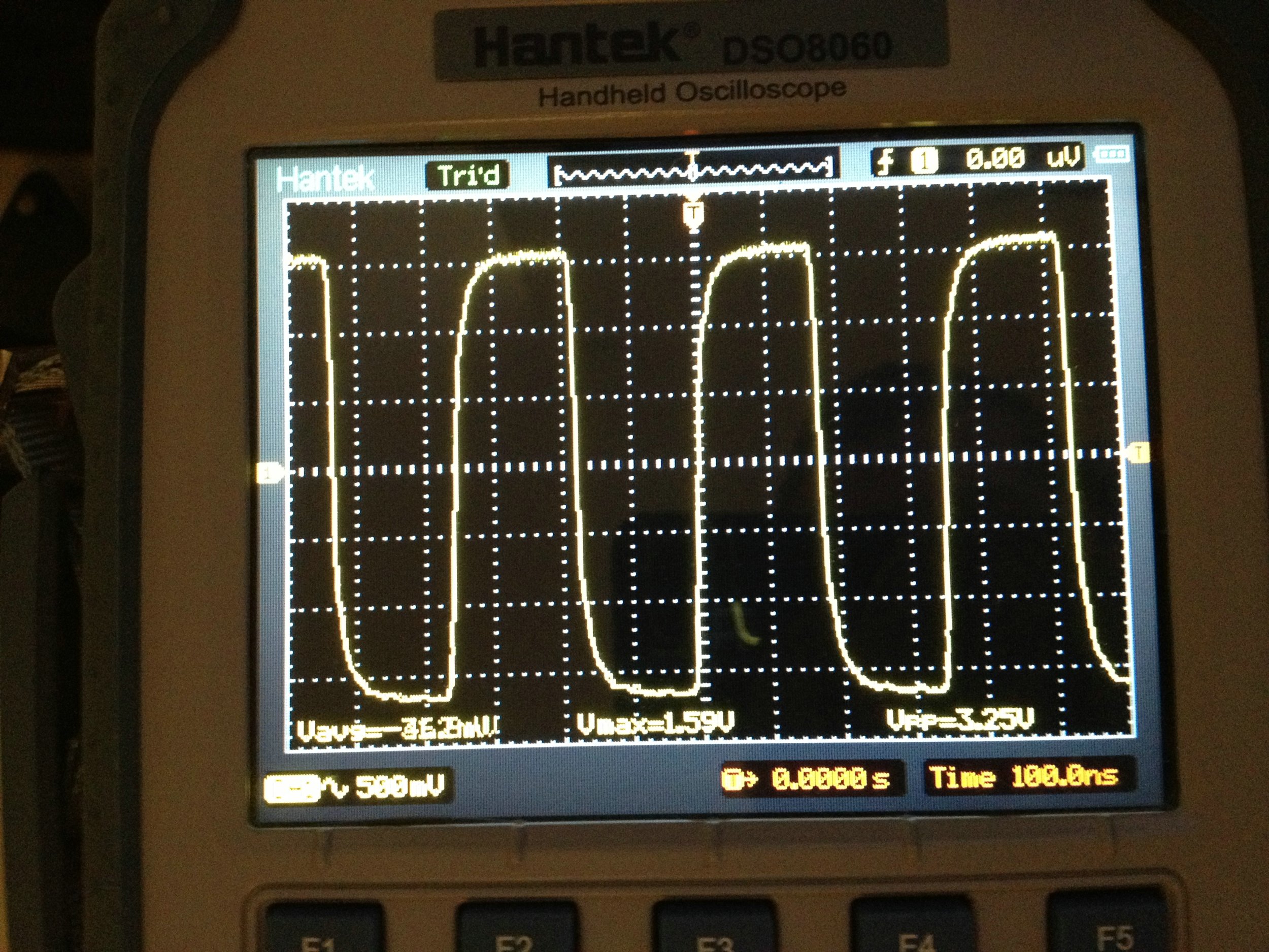

Yesterday I fired it up finally for the 1st time 🙂
Wow... I even got some music at the output 😀
Bad point is that there is so much noise/ hiss/ digital distortion (?!) and it's very loud!
Checked all the power supply, the voltages are correct.
The settings on spdif transceiver are soldered as on the pics 2,3,4 (tried setting AIF/CONF0 to "-" but that didn't change anything, same noise).
I2S is connected in the following way:
BCK -> BCK
LRCK -> FS
DOUT -> Data
GND -> I2S GND
should be correct I suppose?!
Tried with a scope:
-square wave on spdif output of toslink converter
-BCK & LRCK showed square wave as well
-DOUT showed something weird (should it be square wave as well here?)
Would appreciate any advice!🙂

Twisted Pear SPDIF to I2S module with Red Baron
Hi Jorge,
with the Twisted Pear SPDIF to I2S converter you must do the 3.3V I2S mod., or insert the UHS-Buffer module in bewteen.
I would recommend to do the 3.3V mod!

It is already done...by you...
Hi Oliver,
Glad to hear you...
My Red Baron 4.0 is one I bought from you with the 3.3V mod already done. Don't you remember? It should be working fine as it... I do not know what is going on and I need a BNC SPDIF input because I do not use USB audio. If I can not have a solution, could you sell me a UHS module?

Ahh sure... 😱
Did you power the Digital in with 3.3V ?
Yes...perfect & stable 3.3v
Yes, I did...
Also in a previous purchase, I bought from you the power supply's and the salas shunt modules. I modified as you told me, the +5V to 3.3V and the modified salas shunt module works perfectly and stable at 3.3V.
The TP module is powered from the +5V line. In its manual states a power supply from 5 to 7.5, the later preferred. Could be this the problem?

hi guys!
made another few test and think I found the problem, it's spdif transceiver!
I forgot I have the Amanero board that I've just connected and the DAC started to sound properly! Then I checked the toslink converter I use before TPA's board and it's working fine as well with another DAC.
I've tried to start the dac first then the source, but was unlucky again unlike jcastellano.
Could there be some issue with the three position switch that I substituted with wires here?! though it looks fine I assume...
I've connected the scope to BCK pin and here is what I got.
Also I double checked all the joins on TPA board and it looks to be fine...😕
