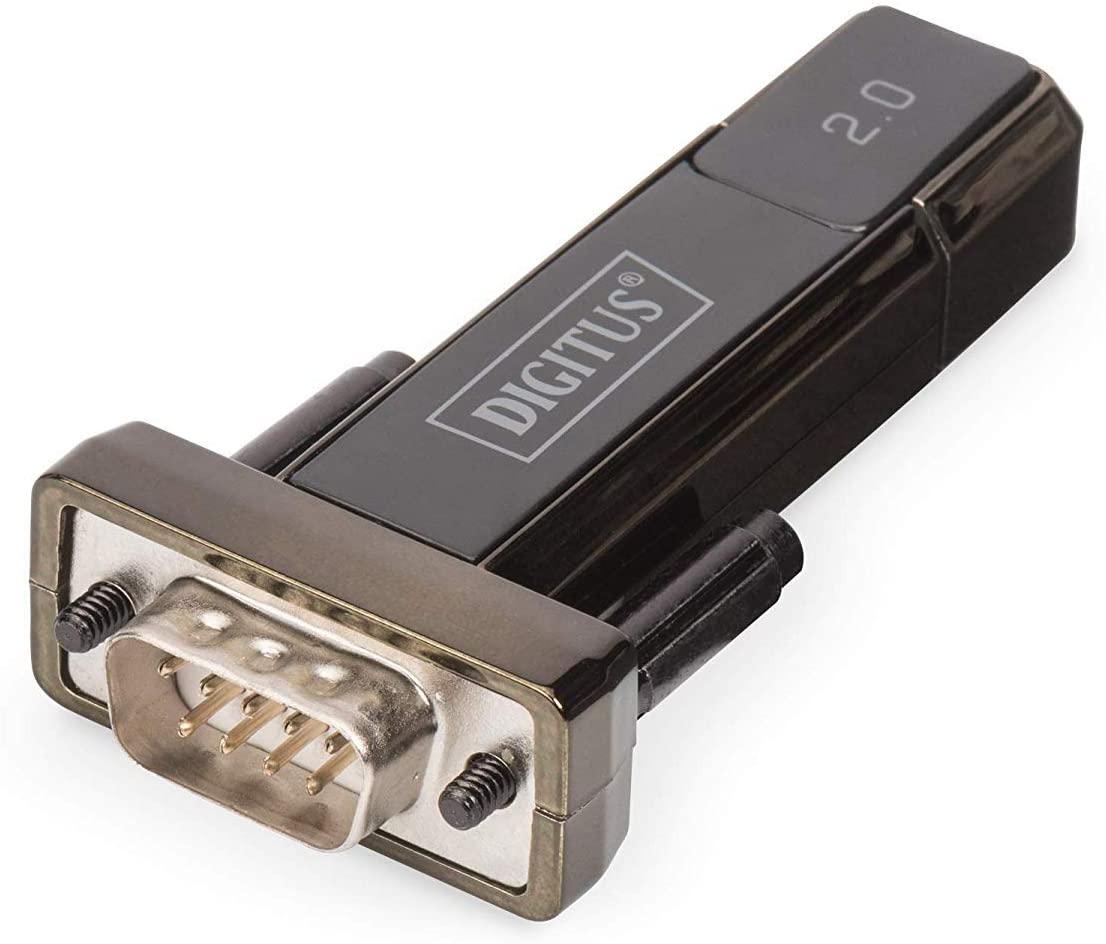

I tried two different USB solutions. For me it only works with an ancient laptop that has a serial port build in.
Which site did you get your info from?
Here is from randytsuch's audio page: Soekris R2R Dam DAC
To update the filter, you need to connect a RS-232 port to this DAC, but these days most PC's don't have one. And early on, people had problems establishing a connection with different 232 adapters.. It seems there are certain adapters that work.
I use a ATEN USB to Serial RS-232 Converter, Model UC-232A. I found this one on ebay
To connect
ATEN Pin 2 goes to J10 pin 3
ATEN Pin 3 goes to J10 pin 2
ATEN Pin 5 goes to J10 pin 5
I made a little adapter. One side of the adapter is a 9 pin female DB9 that plugs into the ATEN. Then about 6 feet of wire to make it easier to connect, and then some pin sockets that plug into the pins on the DAC.
This adapter needed drivers installed. Drivers for this adapter are here
Aten drivers
Go towards the bottom, and click Support and Download
There are drivers for Android, Linux, Mac and Windows, so pretty much anything.
I also used extraputty for my terminal program
extraputty
I looked in the windows Device Manager page to see what the serial port number was. Go to Control Panel, System then select Device Manager (this is for Windows 7)
Setup the comm port as follows:
Baud rate: 115,200 (This is pretty fast. Use a good, short cable)
Data bits: 8
Stop bits: 1
Parity: none
Flow control: none

@TNT you nailed it.
I just was obfuscated reading stuff too fast.... The FTDI I pointed out is valid for @&€1xxx, and I read there dam1xxx.... Bit it looks like @&€ means exactly dac1xxx so I bought the indicated cable by Soekris, yes, but for a different board.
Sometimes you just need some eyes to help you. As @TNT mentioned "which website" I just thought "come on, the official one...." And next though "wait, if @TNT does not know that maybe I misread something"
Thanks guys, will look different option and keep you updated.
@MvonB thanks for that one. Will order it and try it.

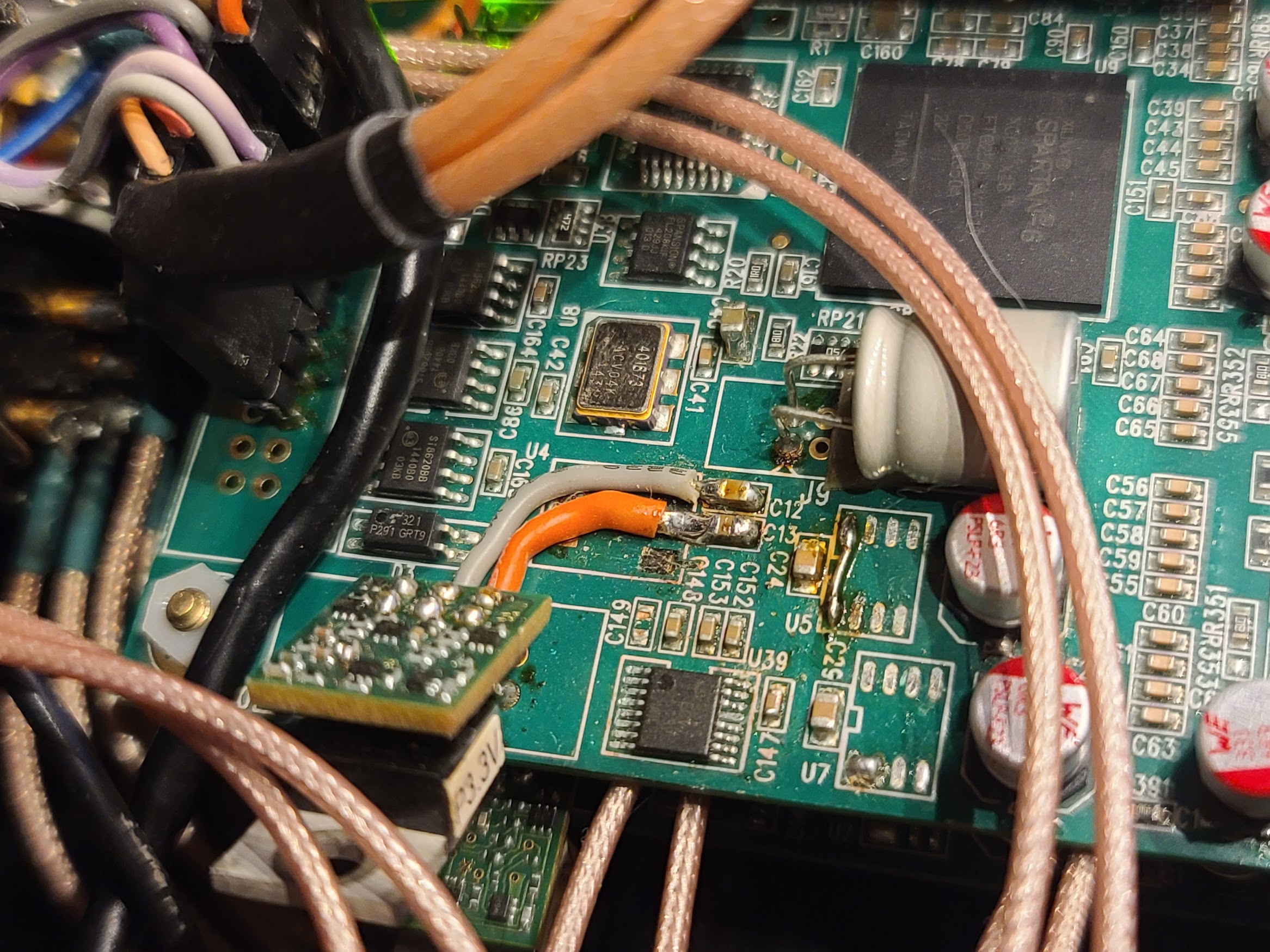

This was the solution I settled on 2 years ago, I found it made a significant difference at the time, especially with the stereo separation between the two boards in a dual-mono config. The original ldo regulator config I found to be rather noisy on the scope, and moreso during sample rate changes/syncs.
Adding the caps (both polymer+stacked ceramics) is probably sufficient but I went with sparko discrete for the 3.3, haven't modded the switching regulator at all. I reused the serial port pads to give it some rigidity + ground pin and disconnected the serial pin it shared with. Since its dropping from 5V (dual LT3045 based) it doesn't dissipate much heat.
Still happy with my setup its the one thing I have that I haven't felt the need to upgrade to the latest & greatest version. Diminishing returns will greatly apply.

Interesting! Where are the added ceramics? C40?
