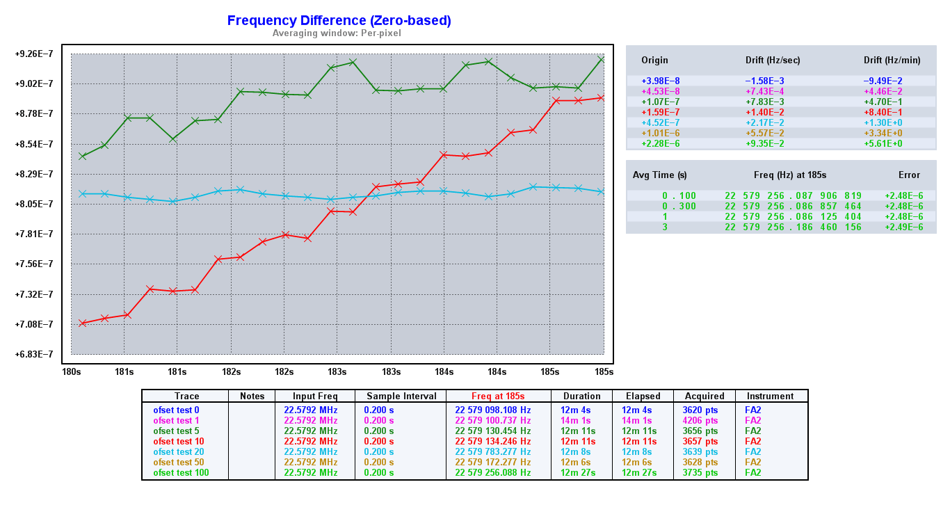

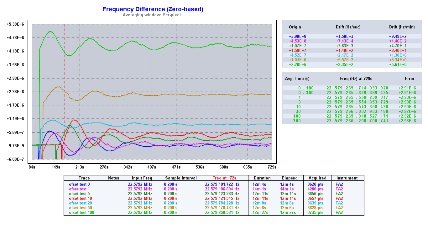

Here some measurements on how the offset of the I2S clock to the DAM clock (before locking) influences the clock adjustment of the DAM.
I measured the DAM clock with no signal locked to the DAM first, then adjusted the I2S clock to that frequency plus an offset, then played an signal. I did that for offsets of approximately 0Hz, 1Hz, 5Hz, 10Hz, 20Hz, 50Hz and 100Hz.
Well we see that the magnitude of the oscillation at start as well as in the stable phase later differ, but the offset seems not to be the determining quantity.
For offsets of 20Hz and bigger there is an instant adjustment at the start.
Thanks! Is it a correct interpretation of your measurements that the average frequency deviation is the greater long term, the greater the initial offset (with the red 10 Hz deviation being the exception)?
No. The very short line in the beginning, with y=0, is the frequency of the DAM-clock before applying the signal with the offset clock. The plots are thus showing the difference to the initial frequency.
The "big-picture" jump up and staying up there is the tracking of the offset. The jump up is thus bigger the bigger the offset is but this the desired behavior.
The interesting thing is how the jump up and stabilizing to the offset frequency happens in detail. E.g the plot for 50Hz offset (brown) oscillates less, as well in the beginning, as in the "stable" phase than e.g. the 100Hz or the 10Hz plot.
Mmm, the Q value of the circuit seem to differ depending on the circumstances... odd for being software only... But I'm sure Sören will improve this soon. Or I hope he will at least.
Sören - any plans? Please share.
My current hypothesis is that the effect could be due to limits in resolution of the frequency measurement of the DAM. So if the DAM-measurement matches the reality well then we see less oscillation. This could be tested by offset measurements in finer steps ... but I assume Soren can verify this. I want to re-assemble my DAM for listening music with it again 🙂

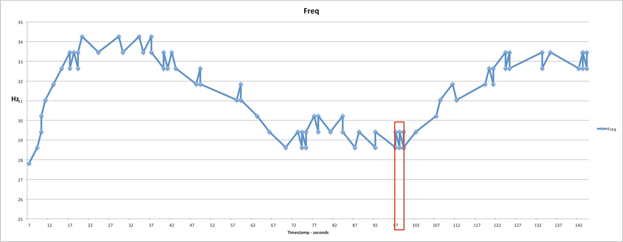

Well... just one change will probably be hard to catch if not impossible. But if its ongoing constantly.... well... it makes the clock "unstable" on a music listening scale... I don't like it. I'm not worried so much about the size of the clock change as the intensity of poking the clock.
zfe - can you extract some change intensity figures from your last tests? I.e. average clock adjustments per second, most intense second, longest time between changes etc?
I have the attached data but I'm a little bit uncertain of the correctness.... it source comes from a Si i2c trace.

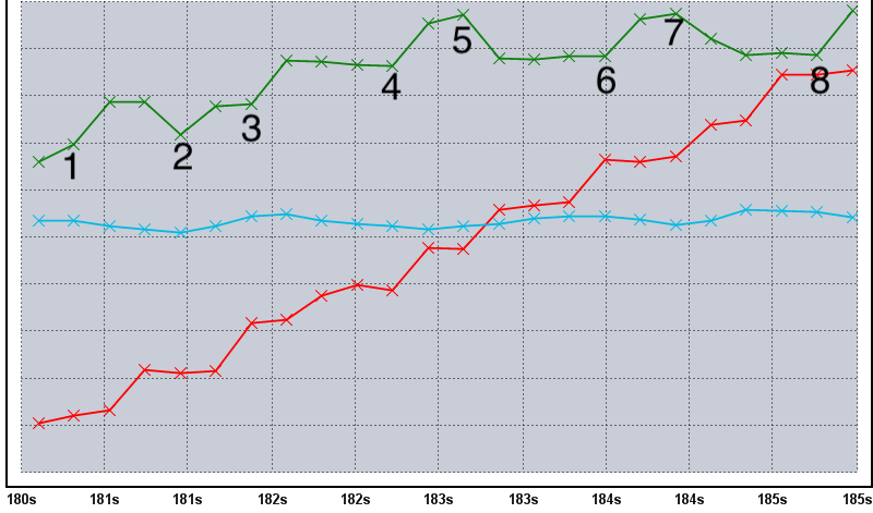

Well there is a scale on the y-axis 😉
E.g. for the red trace the first maxima is about 10^-6 (of the nominal frequency of 22.x MHz) so about 22Hz. In the stable phase, the swing is about 1/3 of a grid, so around 0.2*10^-6 = ~5Hz.
The measured clock was the FPGA-master. The SI514 runs at double frequency.
Would you think it is correct to assume that we see both clock drift and changes combined but at the places I drew numbers, are the actual occasions where a i2c order to change clock was made? That would jive with my findags of about 2 changes over i2c (traced!) per second when most intense.
