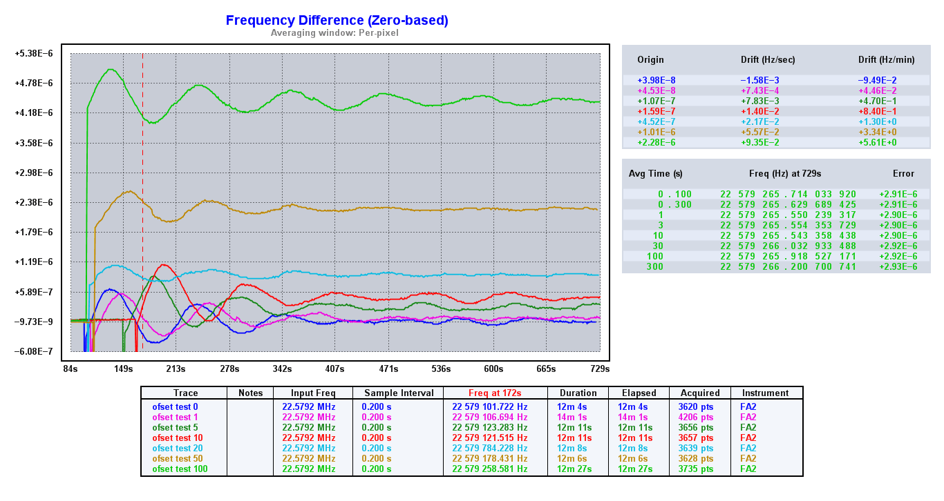

Here some measurements on how the offset of the I2S clock to the DAM clock (before locking) influences the clock adjustment of the DAM.
I measured the DAM clock with no signal locked to the DAM first, then adjusted the I2S clock to that frequency plus an offset, then played an signal. I did that for offsets of approximately 0Hz, 1Hz, 5Hz, 10Hz, 20Hz, 50Hz and 100Hz.
Well we see that the magnitude of the oscillation at start as well as in the stable phase later differ, but the offset seems not to be the determining quantity.
For offsets of 20Hz and bigger there is an instant adjustment at the start.
