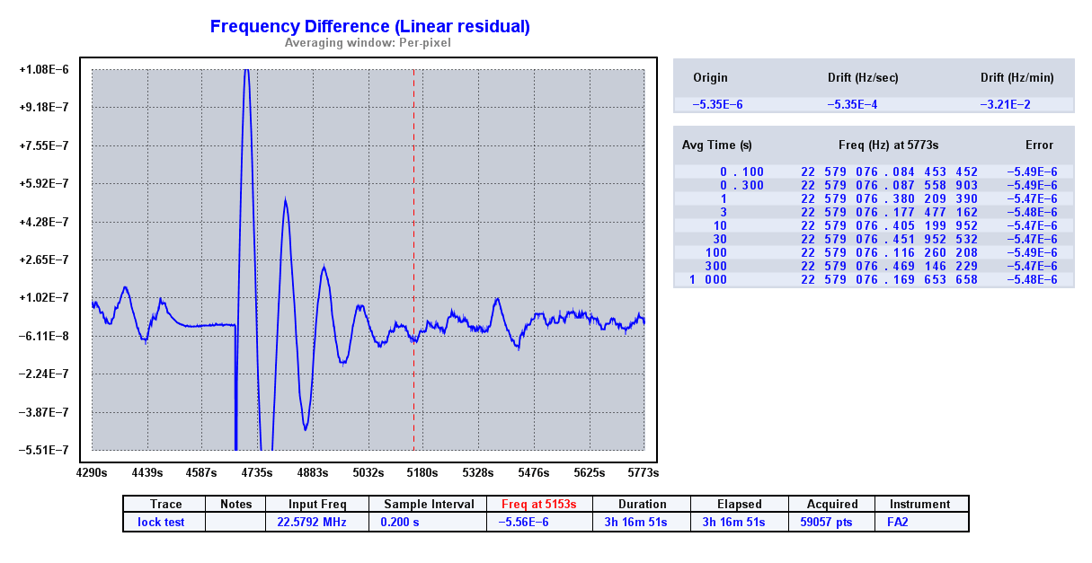

Does does confirm my observations that the DAM1021 over- and undershoots over time within a rather broad range.
Since the i514's clock itself looks stable and within parameters of other crystals, in theory either
the accuracy of the measurements of the incoming clock or
the accuracy of the measurements of the DAM's build in clock or
the deviation caused by resetting the DAM's clock or
the step size of the corrections made by the DAM
would be the biggest contributor. Hope it is primarily the latter.

I just made a measurement over a unlock-lock of the source (by stoping and resumeing playback). You see after unlock the DAM stops changeing frequency, after lock it goes wild again.
This recalled me a observation I made in the past: If you stop/restart playback more or less when the oscillation has a zero crossing, the osccilation seems to be less afterwards. I tried to confirm this with frequency measurements, its some trial and error, but something in this direction is visible after the initial big oscillation
The opposite works also, if you managed to get the oscillation less and stop/start when the oscillation is "far" avay from zero you can increase the oscilation again.
I will see is I can explore that more systematically - next weekend probably.
