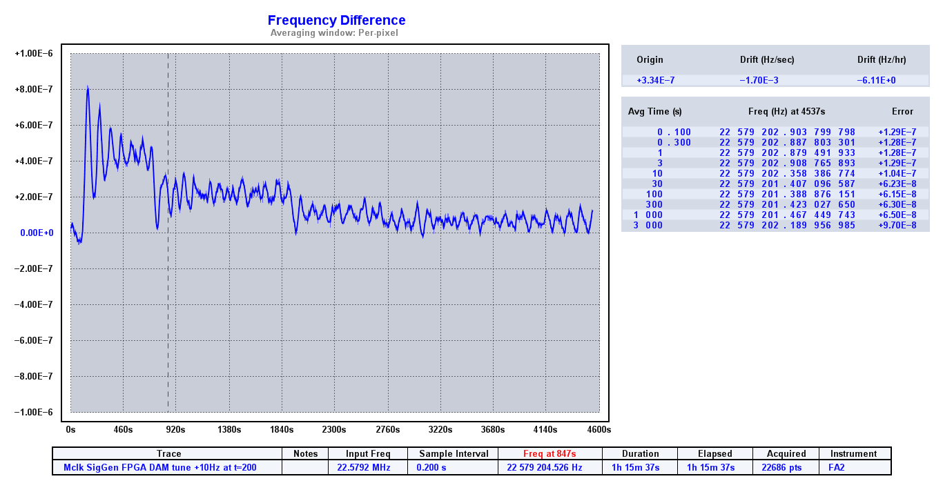

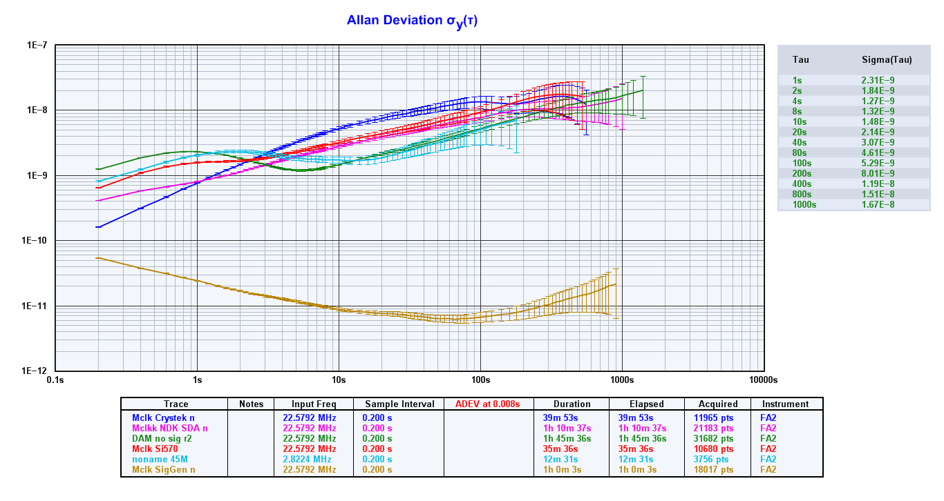

I finally did some measurements in context of the frequency adjustment of the FIFO of the DAM 1021.
The measurements were made one after the other. So if there are multiple plots in one picture, a bump at a certain time in one has no correspondence to the event at the "same time" in the other plots.

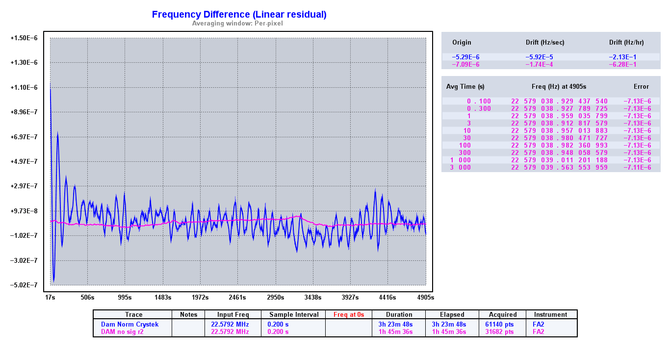

Lets start with a measurement of the DAM FPGA master clock output (this is the frequency of its SI514 oscillator divided by 2).
The blue plot is the measurement with a signal at 44100 kHz sample rate feeding the DAM, thus the DAM here is doing frequency adjustments. The pink plot is the measurement when the DAM is not locked to a source. In this case the its clock just keeps running with the last frequency, thus here we have a measurement of the clock where the DAM is doing NO frequency adjustments. Second picture the same zoomed in somewhere in the "middle".
The plots show the residual of the measurements from the line fitted to the measurement points. Loosely speaking we see the deviation after removing offset and (linear) drift (the numbers of these are given in the tables on the right).
We see several things:
The big oscillation at the beginning of the blue plot is caused by the removal of the frequency offset. The adjustment approaches the aimed value in an oscillation (over and undershoot) and needs about 3 oscillations of a period of about 100 seconds each to "do its job".
The adjusted clock never reaches the "stability" of the unadjusted clock, we see that there are all over more or less strong "100s-oscillations" thus "slight" adjustments all over the time with this over-undershoot behaviour.

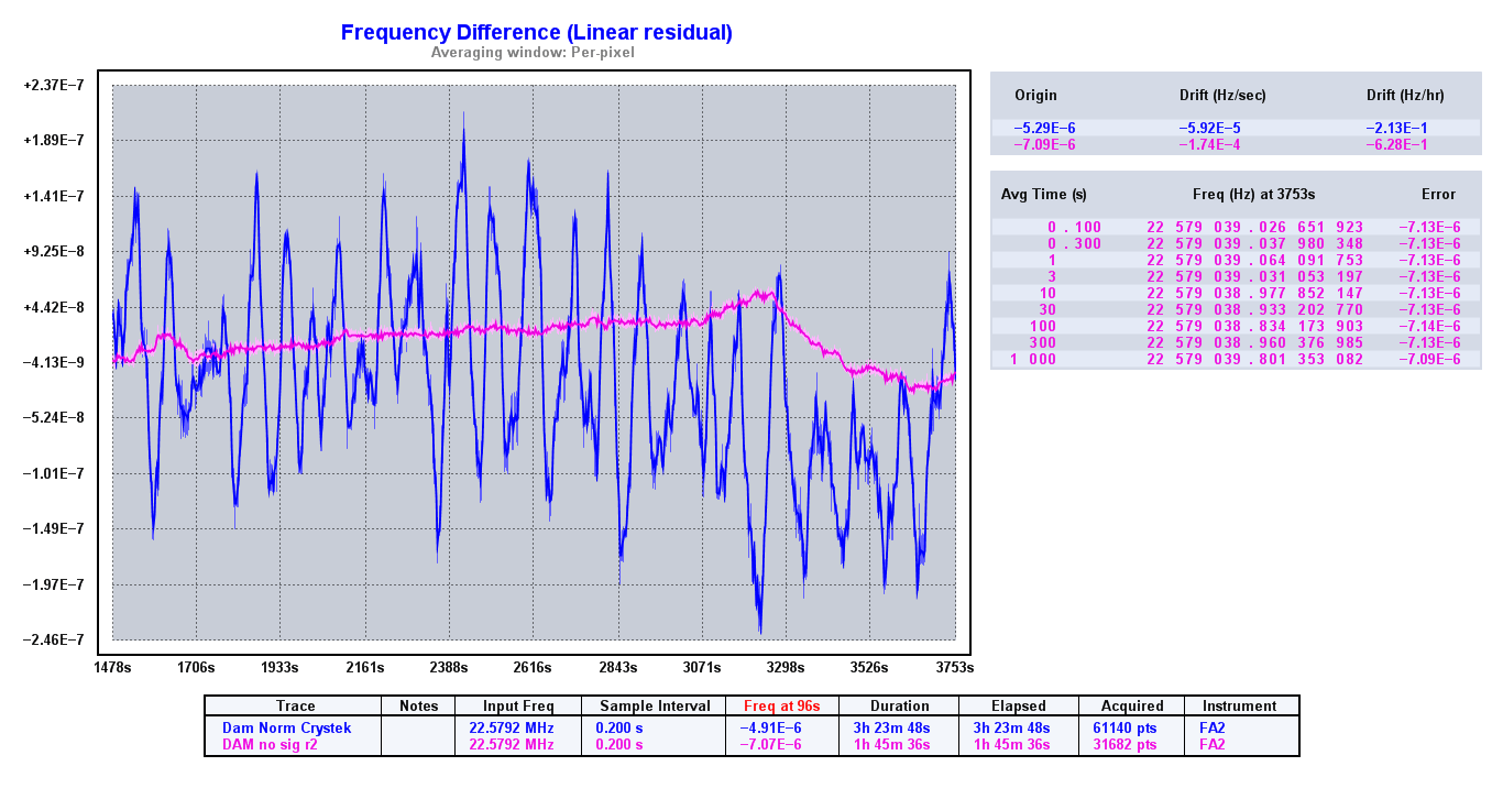

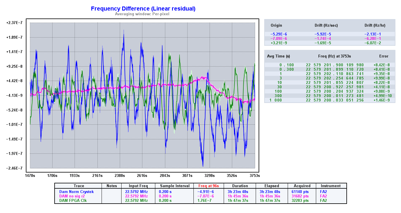

The next plots are to illustrate that this issue is not really caused by instability of the signal fed to the DAM. The DAM is fed by an I2S signal. We measure again the DAM FPGA master clock. Again the blue plot is for the I2S signal clocked by a Crystek CCHD-957 (stability plots of several clocks are shown later). The green plot is for the I2S signal clocked by a signal generator which is much more stable - surely stable beyond the measurement capabilities of the DAM.
While we see a slight improvement, the situation is essentially the same. Although the input is "perfect" for the green plot, the DAM measures with its own clock as reference and thus must do adjustments to compenstae the drift and frequency noise of its SI514 (pink).

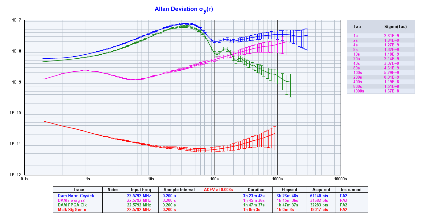

Perhaps more informative is the plot of the Allan deviations.
The blue plot is the DAM master clock with the Cryteck input.
The green plot is the DAM master clock with the generator input.
The pink plot is the unadjusted SI514.
The red plot is the signal generator.
We see that the DAM master clock plots look alike up to 100 seconds. After 100 seconds the plot with the generator input starts to follow the generator itself due the PLL. While the Crystek plot follows the Crystek - which behaves essentially like the SI514. We also see that below 100s the DAM master clock plots are worse than the SI514-plot.

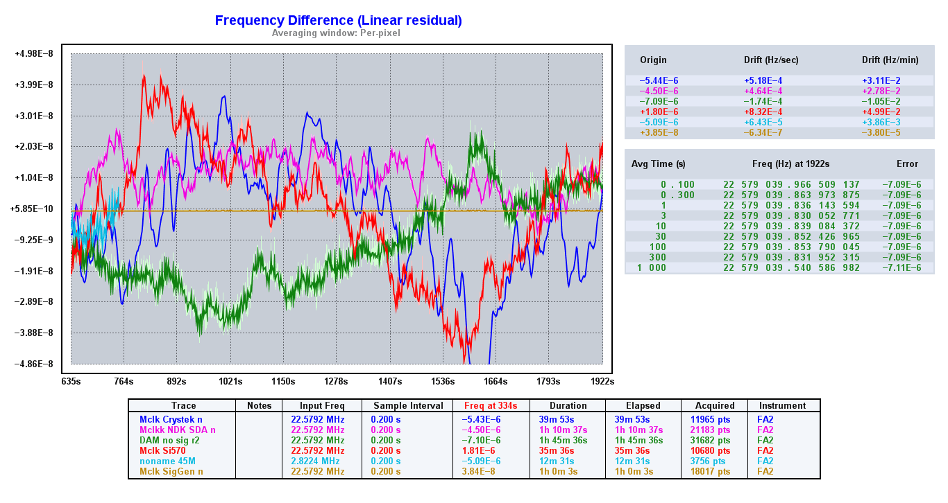

To conclude stability plots of several clocks, a Crystek CCHD-957 (blue), a NDK NZ3225SDA (pink), a SI514 (green), a SI570 (red), a cheap no name (light blue), signal generator (brown).
Although the clocks have individual shapes, in a big picture approach all the clocks perform, in terms of stability, more or less alike.
OK - some questions for clarity.
- Not one single trace is from the same period of time - not within chart or between?
- By "first 100 sec" - is this just after a lock or maybe power on?
- I suppose a "new 100 sec" would occur after; power on, ->lock, Fs change - more?
- What is your external frequency ref? Did you try to listen to using this on the Amanero?
So all of this is about frequency stability and not jitter - just to clear that out. Jitter is yet 1000 times smaller aberrations. So why is it interesting - well, for user 'living sounds' its might be the cause for a multi DAC sync issue. All these frequency adjustements of the Si may have a negative effect on SQ - some reports say USB sounding better on DAMs with built in USB where when used, clock adjustment don't take place acc to Sören.
The frequency alteration themselves are hardly noticeable as they are in the region of mHz. Only Furthwängler would catch that 😉
Every measurement is from a different period of time. I have only one single channel frequency counter. However some different plots are from the same measurement. For one you can do the frequency deviation, zoom of that, Allan variance, all from the same stored measurement. Moreover the same measurement, e.g. the free running SI5i4, appears in different charts.OK - some questions for clarity.
No all measurement were made after everything was powered up for at least an hour. After power on the clocks drift like hell. A lock/unlock was made by starting/stoping to play a music signal.- By "first 100 sec" - is this just after a lock or maybe power on?
The heavy oscillation in the beginning of the plot (if that is what you mean by first/new 100sec) is due compensating the offset. The offset arrised by either measuring a other clock than in the previous measurement or by a long delay between the measurements due to drift. As sample rate change would have an comparable effect.
The "first 100 sec" in the Allan variance plot have a very different meaning:
Allan variance - Wikipedia
A "slightly" dated signal generator of one of the big brands in measurement equipment 🙂- What is your external frequency ref? Did you try to listen to using this on the Amanero?
No I did not listen music with it - the thing has loud fans. Moreover as typical "boat anchor" it weights over 20kg and I do not want to carry it around the house.
Yes. I thing frequency stability is what affects the frequency adjustments of the DAM. The DAM frequency measurements take their time. Jitter affects the sound due to other "channels" than by effects on the frequency adjustments, I would say.So all of this is about frequency stability and not jitter - just to clear that out.
Yes the mHz changes in music is most likely no issue by itself. But as e.g. my recording of a square wave (in some earlier post) showed it has well measurable effects. Probably 'living sounds' knows better what can happen.
