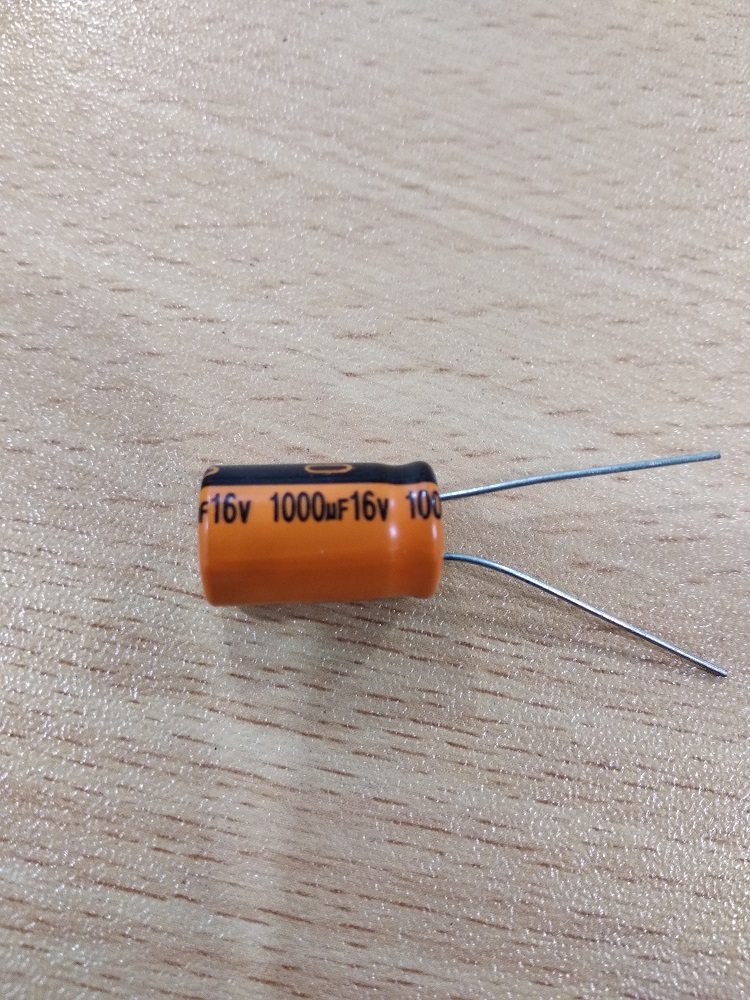

I have bought dam1021 v5 very recently. Should I implement the vref mod. I don't have any experience on this. As I have gone through various posts, I found that e 12 pieces of 1000uf 16v capacitor can be used for vref mod. I have 1000 uf 16v capacitor (ESR 7), can I use those? Is it all that I should do for vref mod. Need your kind suggestions.

Those seem to be fine caps. Put them on and you should hear a big difference. But before you do that, if you can record the outputs and post them, many people including me will be very grateful.

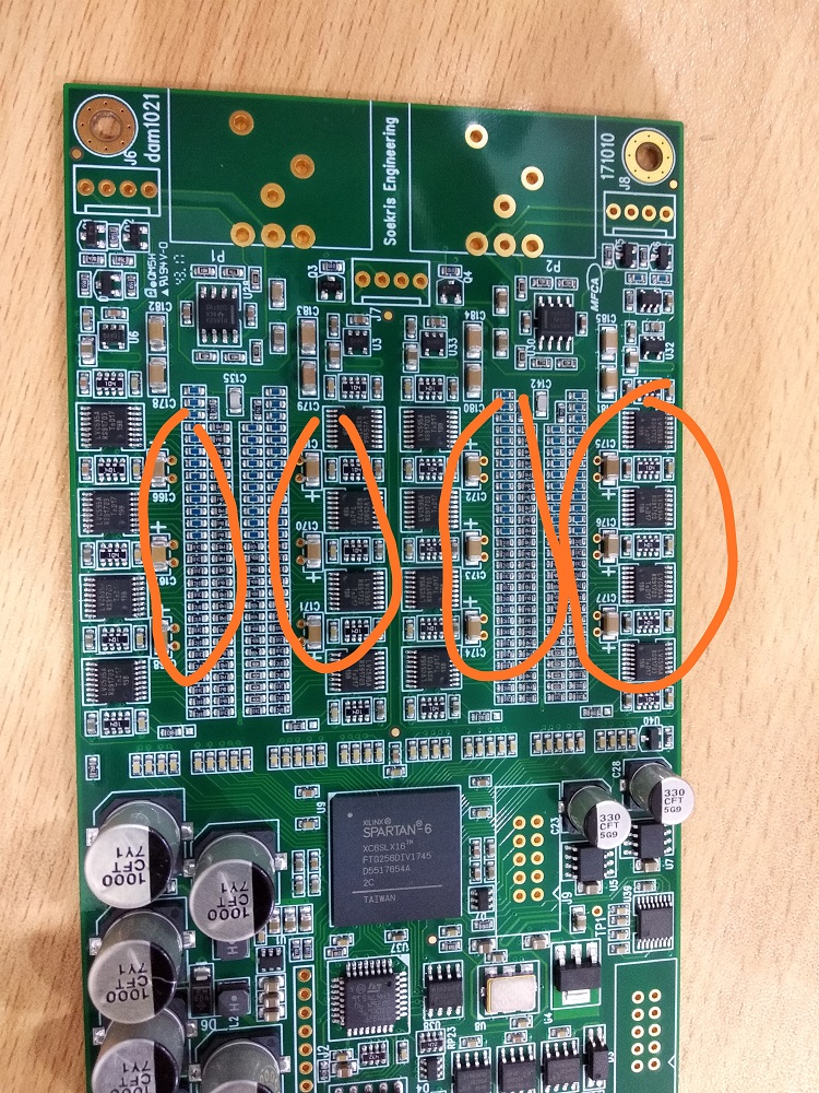

Your picture revealed that Soren improved the vref circuit on rev5 to match his commercial products. They dont have the load resistors any more. Can someone with an actual background in electrical engineering explain what benefits it might have? And whether it’s possible to mod on earlier revisions? 🙂

Yes, add them through the vias,
for the leads that go through the vias: don't cut them short, so you can use those leads to add some additional caps on the backside.
Also add a cap for the clock, you can also use the available vias, see this post.
