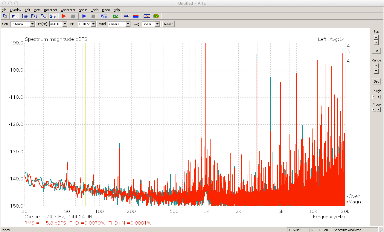

Somewhere in the dark depths of this thread I once suggested to correct, to some extent, the nonlinearity of the DAM, due to the resistor tolerances, by software in the FPGA. There was mostly skepticism if that could work.

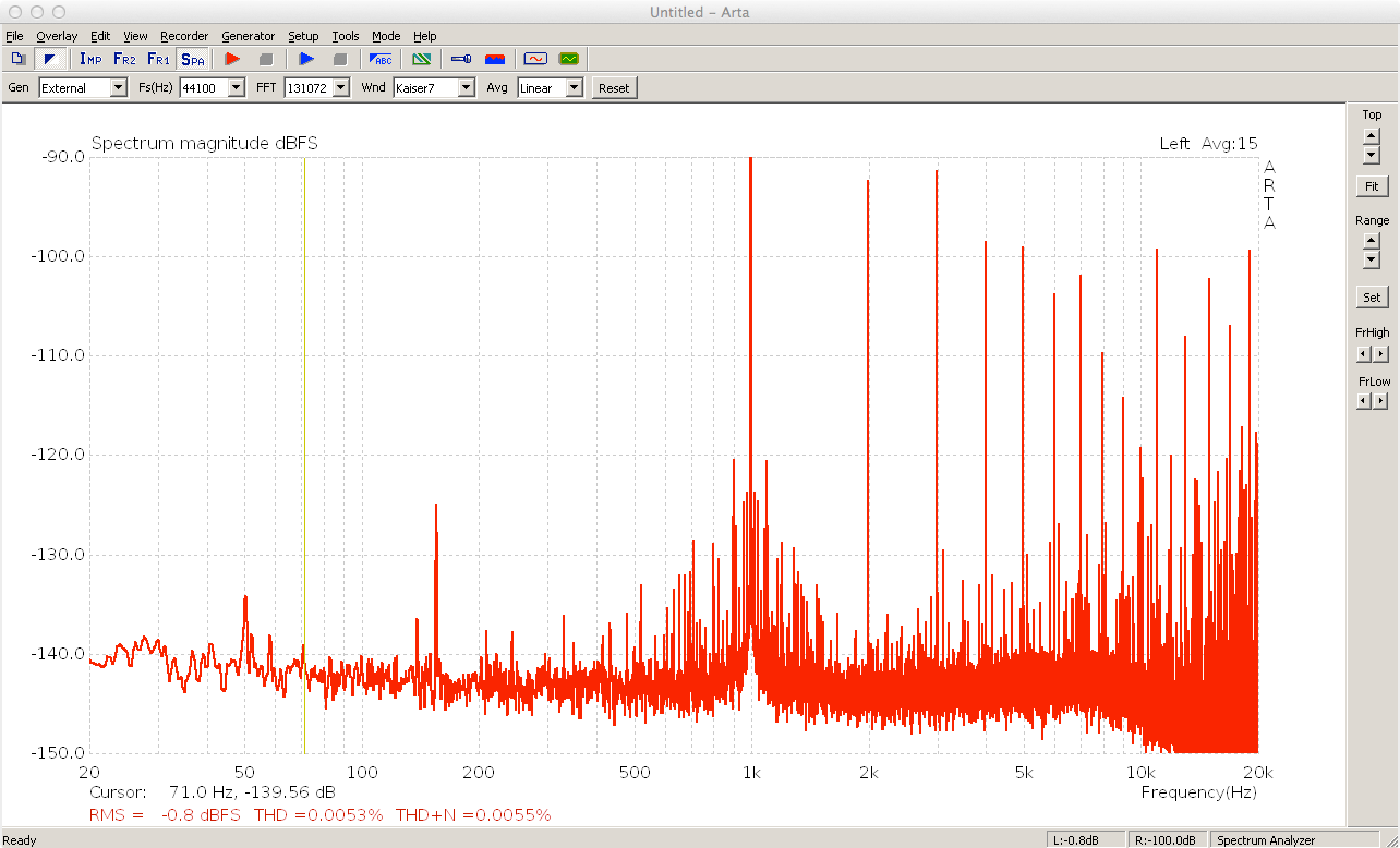

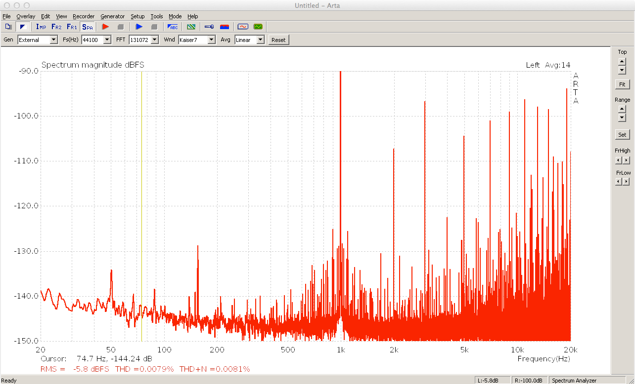

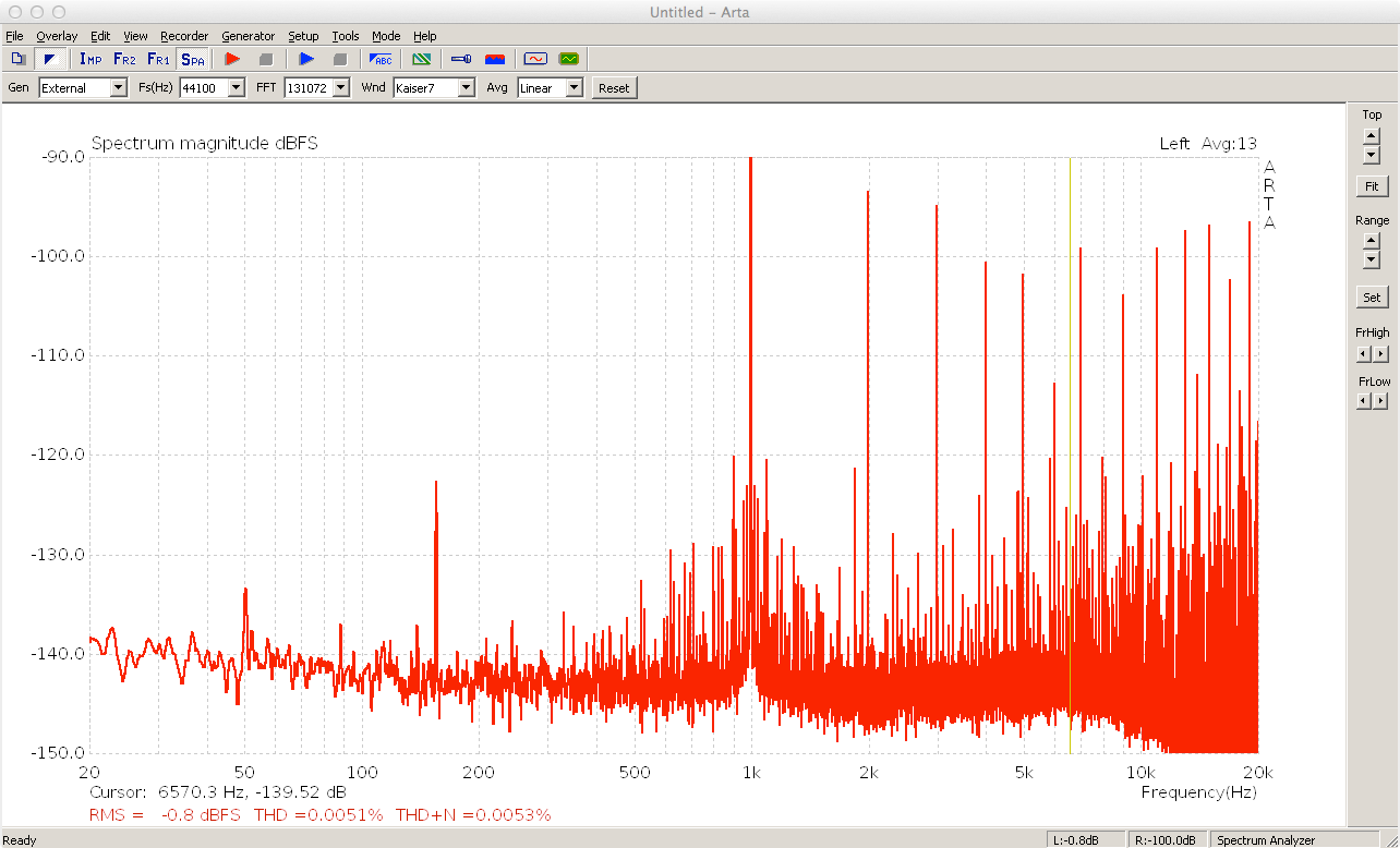

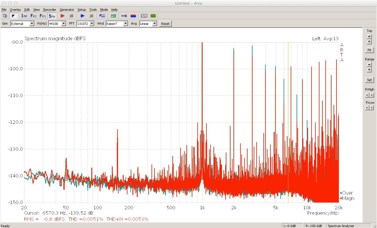

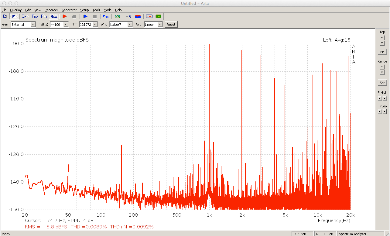

I now got my hands on some chinese 6.5 digit multimeter and so had the opportunity to some basic tests myself.
I measured the output voltage, with only one bit set, for the most significant bits. Then I used the lower bits to correct the errors.
Here some measurements for a 997 kHz signal.
First at -1dB: First picture uncorrected, second corrected, third overlay.
View attachment 553643 View attachment 553644 View attachment 553645
Second at -6dB: First picture uncorrected, second corrected, third overlay.
View attachment 553646 View attachment 553647 View attachment 553648
One sees only a slight improvement of the THD, but looking at the harmonics in detail, reveals that the low order harmonics are improved, whereas the higher get slightly worse.
I hat to modify the input signal and bypass the DAM filters for the test, as the correction does not commute with the filters. The right place would be to correct it in the FPGA after the filters. But only Soeren could provide that feature. I think it looks promising enough to be considered as an option in some future FPGA firmware.
There is a lot room for improvement: in the measurement procedure, the measurement equipment, .... I think the correction could be pushed much further. But as long as the firmware does not support it, I think it is not worth to put more energy in the research.

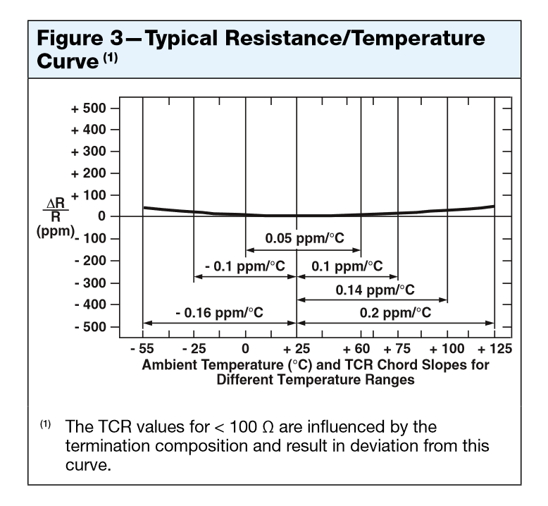

Edit3: This Vishay FRSM series graph seems to suggest that there is perhaps more consistency in thermal drift than variances?
Vishay makes some very good resistors. But note that for most resistors, the temperature coefficient is worst at the temperature limits, not the temperature that a Audio DAC works at. And the resistors usually track each other.
Not sure what you mean. It seems 25C is best for TCR which should be close to the operating temp of the resistor ladders making it more advantageous for dam1021. My point was more about the potential relative consistency (higher tracking precision than the TCR specified?) among resistors and how that would not cause problems for a device calibrated at room temp. Maybe I was wrong...
