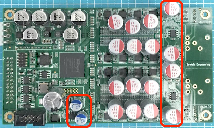

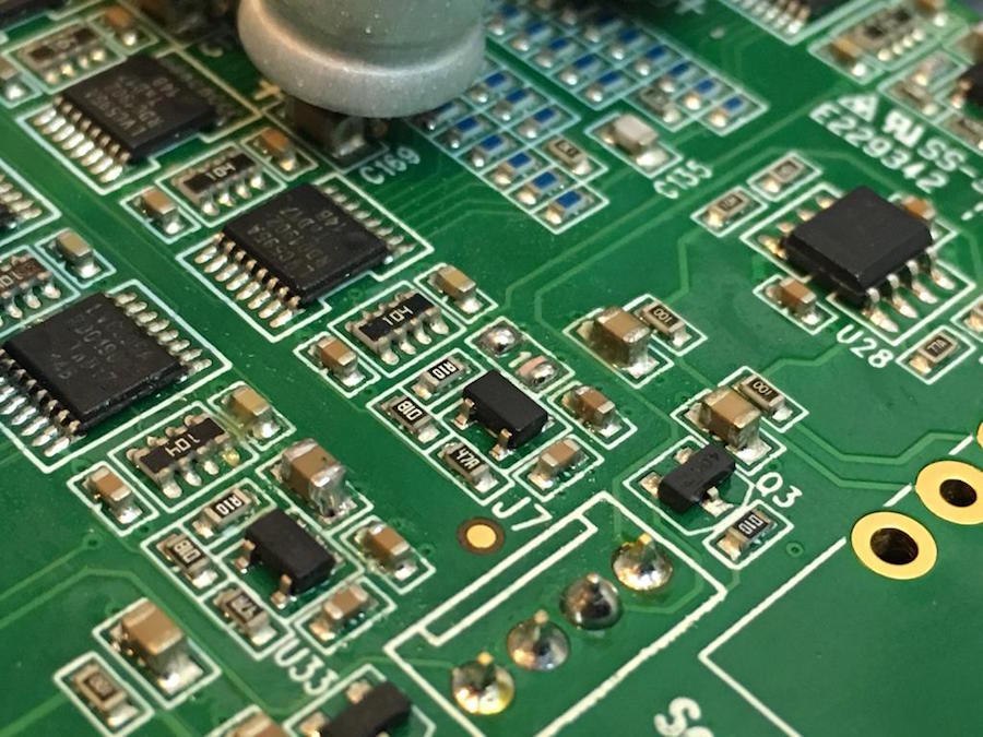

After the successful modding of adding 12 polymer caps, I continued with the extra 4 caps of 2200uF by attaching them to the 4 SMD caps; and also swapped the 2 filtering caps with blue color caps (560uF). I believe the polarity is correct.
It failed. There was a horrible distortion/some popping coming out of the speakers. I tried both SE and buffered balanced output-same problem.
Now I reversed back to the previous state by removing all 4 caps and putting the 2 original filtering caps back in near the clock.
I know I ripped one of the 4 SMD caps so I desoldered it and turned it to other side when re-soldered it. The dac worked as normal with fantastic SQ for a couple of seconds and then severe distortion came back again.
How do I troubleshoot this? Is the board dead forever?
Can I just replace the 4 SMD capacitors? what value are they?
or should I replace the whole Vref section there?
Thank you for your help! Sad weekend.
