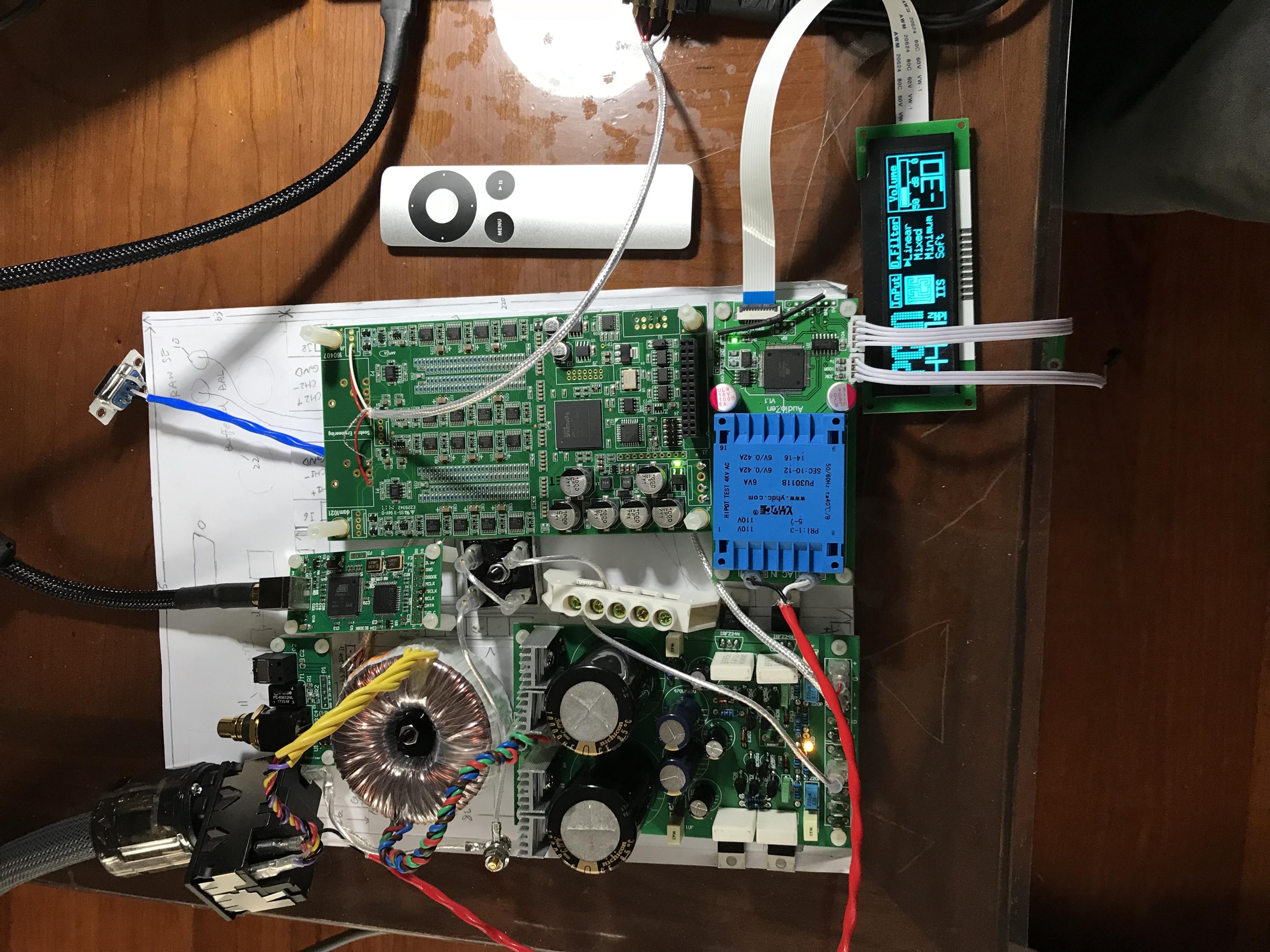

Test Build
Just finished my first build, with one dam1021 SE. Sounds like a good improvement to my laptop‘s built-in dac & amp. 🙂
The enclosure still hasn't arrived... hard to count on a $20 case with CNC included... will post again when I put both dam1021 into the case.
@soekris Just saw your post early 2016 on a potential add-on buffer board for dam1021, sounds very exciting since I plan on using this mostly with headphones directly! Is it still a planned product? Thanks!
