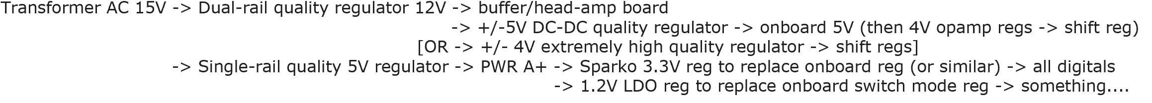

First of all, correcting my last post, the power regulation on the dam1021 is more likely:
AC/DC -> Bridge rectifier -> PWR A+/-
PWR A+ -> 3.3V Regulators-> Digitals (FPGA, oscillator and microprocessor)
PWR A+ -> 1.2V Regulator -> ?
PWR A+/- -> +/-5V Regulator -> +/- 5V DC -> Op-amps -> 4V vref -> shift registers
PWR A+/- -> Output buffer op-amps
[Probably still missing some but better than last...]
With this, now I can answer my own questions...:
(1) Digital/analog separation in the ground plane, or power in general, is probably not perfect. There is no conclusive evidence but the fact that Nigel and friends believe the vref battery mod was the most significant among all the mods which they A/B tested gives some hint. The mod basically provides independent power supply to the analog circuits (with output buffer already removed...).
(2) One could go all out on battery/externally regulated power supplies for all voltages/major components on-board, as a few did. And replace the 1.2V switch-mode regulator which seems to be noisy by an LDO counterpart... Here's my current idea of a reasonable and accessible mod, if the output buffer is not needed:
i. Supply PWR A+ with 5-7V DC, replace 3.3V regulator with Sparko discrete regulator, wire the VCC on the oscillator directly to the regulator for improved performance.
ii. Replace 1.2V switch-mode regulator with LDO.
iii. Supply ~4V (such as 3.3V with LiFePo4 battery) to shift registers, bypass op-amps. If done with batteries capacitors can be left out, but if done with (here I'm very much not sure...) regulators, supercapcitors might be needed. A possible regulated supply is perhaps Regulated DC -> 4* 4V Sparko Regulators. Sparkos are rated at 3uV ripple, 1.5% voltage precision, and 1A output, which should be enough for the shift registers (??).
iv. Supply future Soekris add-on buffer/headphone amp with the same regulated DC as the Sparkos for the shift registers. Or use an existing buffer kit.
v. (optional?) Swap out certain on-board ceramics for better caps / bridge more caps at places if there's room.
This should provide a higher level of digital/analog separation, better regulated voltage for critical components, and doesn't go as far as using battery supplies. Ideally, this should only require one transformer with two sets of secondaries for digital and analog respectively. one dual-rail linear regulator for analog and one single-rail linear regulator for digital. The enclosure would also have a quality buffer/head-amp built-in.
Does this sound reasonable? If so I might consider doing it next year when I have more time... also ideally after Soren releases the head-amp board so I can stack it with the balanced dam1021's....
This is just a naïve attempt at a decent mod... please offer critiques of any kind!

As a summary to my last post, the proposed setup would be along the lines of:
Transformer AC 15V -> Dual-rail quality regulator 12V -> buffer/head-amp board
-> +/-5V DC-DC quality regulator -> onboard 5V (then 4V opamp regs -> shift reg)
[OR -> +/- 4V extremely high quality regulator -> shift regs]
-> Single-rail quality 5V regulator -> PWR A+ -> Sparko 3.3V reg to replace onboard reg (or similar) -> all digitals
-> 1.2V LDO reg to replace onboard switch mode reg -> something....
One would also need to remove the onboard buffer circuits, main filter caps, bridge rectifier and 5V regs.
The problem here without using batteries is the feasibility of providing accurate enough 4V vref and the performance of compromising and only feed +-5V dc to the onboard opamps.
The current vref + and - rails track to 0.01% according to Soren, and a 0.1% difference would result in 12dB increase in second harmonics. So providing two rails of 4V accurately enough is at least something to worry about. Could we do meaningfully better than the onboard opamp approach without LiFePO4, I.e. external voltage regs? If not, it would still be nice to know that the Soekris approach is only second to batteries.
This is somewhat beyond what I can find out with google searches effectively. Some expert input would be greatly appreciated. In any case, I’ll try to document what I’ve found out soon to provide a starting point for the more knowledgeable that may stumble upon this great DAC!
Thanks!!
P.S. as i typed this up it occurred to me that Soren said the vref is already better than any external regs.... still would be nice to have some confirmation since significant improvement was reported by using batteries to provide vref.
P.P.S. The formatting of the first part seems off... attached a screenshot of what I meant..
Thanks!!
