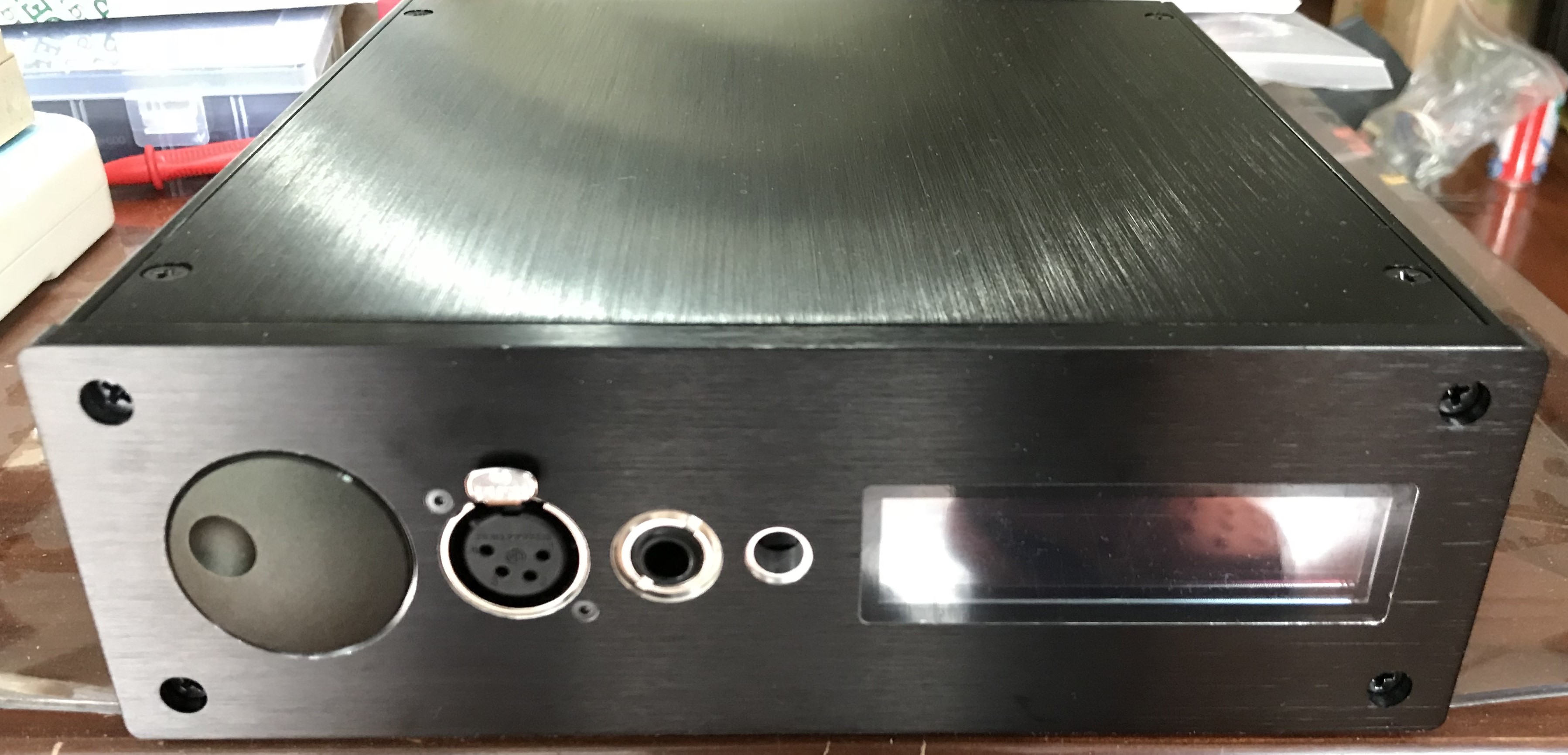

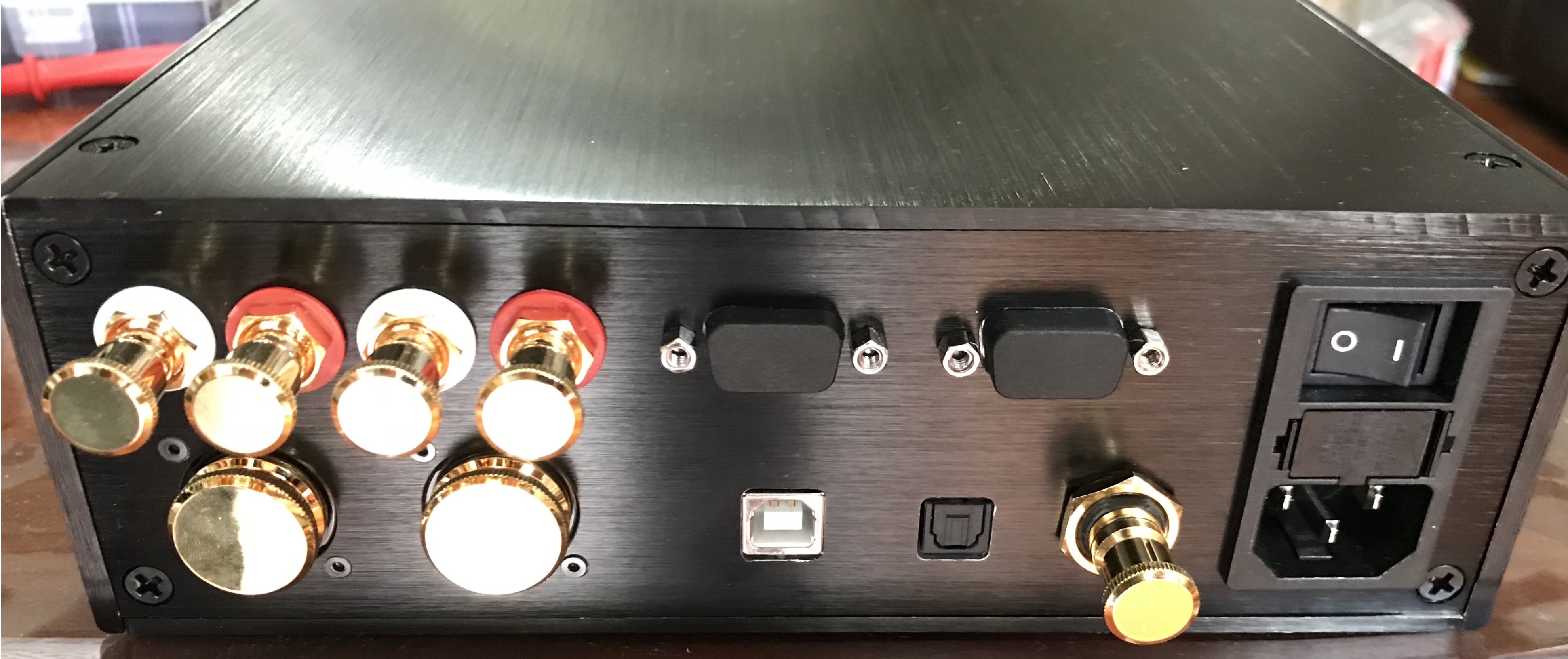

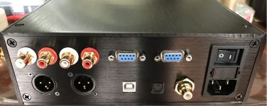

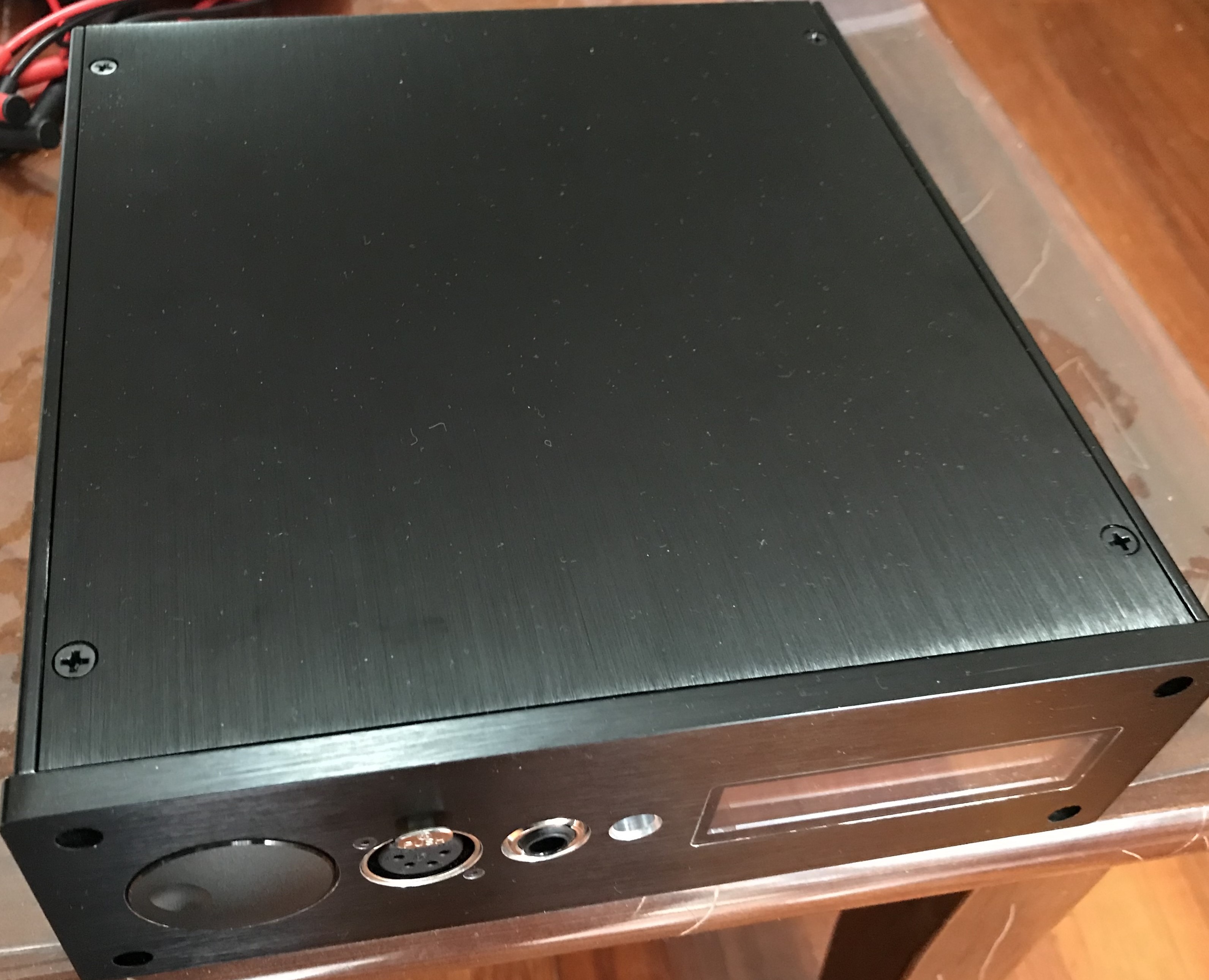

Second build
------------- Build stuff -----------------

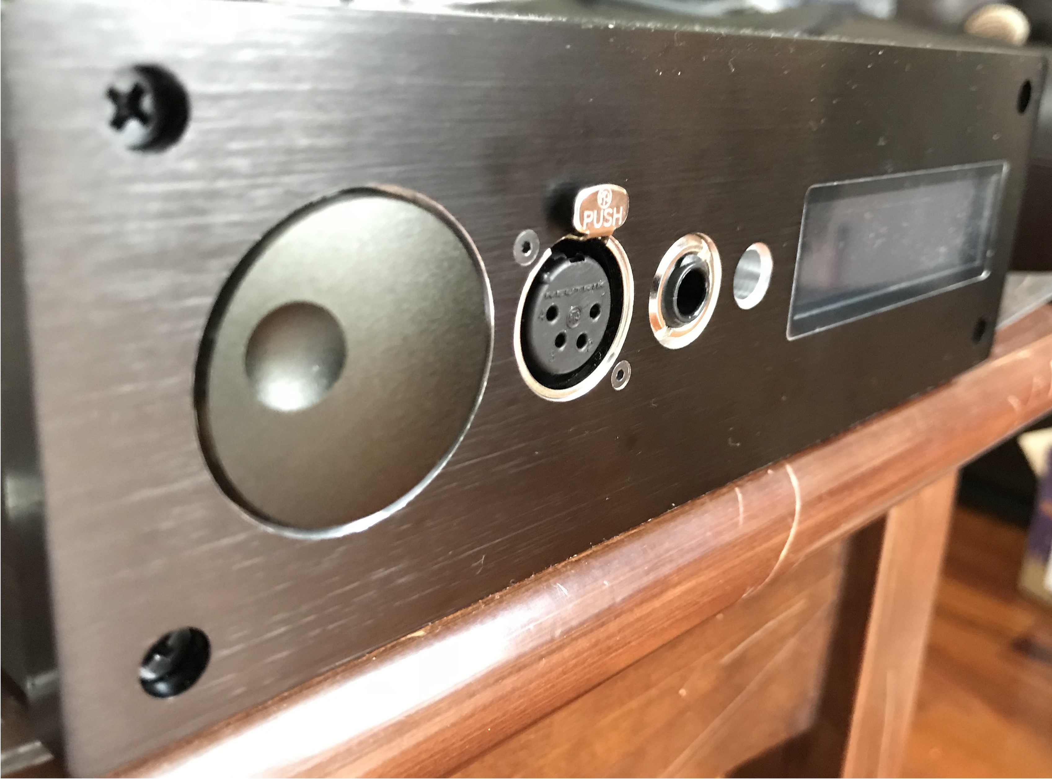

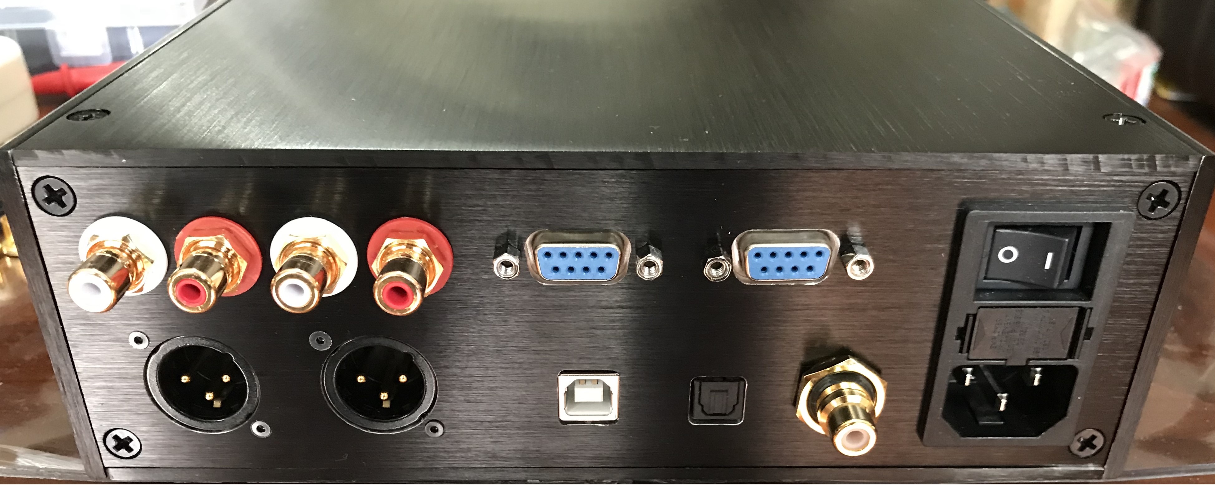

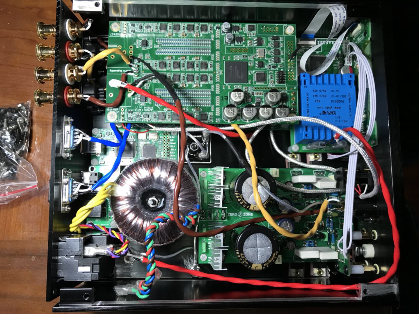

I finally got back to the build after a short New Years trip. Stacked the two dam1021's and paralleled the spdif/I2S inputs with extended (~21mm) headers. It couldn't get a lock at first, then I realized my homemade SPDIF input board is probably drawing too much current from the SK Lite 3.3v reg, so much as to cause the voltage to drop to 0.8v. I then removed the 3.3v power to the SPDIF board and the voltage came back to ~3.6v. I posted the schematics and pcb design of the SPDIF input board if anyone is interested in it. The board was designed to take 3.3v and regulate it onboard to 1.2v for the coax. The dimension is 50*25mm - a rather small footprint that was supposed to fit nicely in my chassis.
However, only the top board was able to get a lock in the first few minutes even after the power to SPDIF board was cut. I suppose it was because the S22 clone was still warming up and the voltage at the oscillator or whatever was causing the problem wasn't quite stable enough. After some time both boards were able to get signal lock without any problem.
My enclosure is 215*228*70mm so everything was really tight on paper. And it indeed took much thought just to fit everything together. Here's some pics to the setup. I'm using a 35w 12v toroidal and S22 clone (HP-X) at 9V DC output to power the 1021s. The USB board is an amanero clone. SK Lite is used for control and powering the ISO section (and the would-be SPDIF input board...) with an independent secondary.
Raw outputs are connected to 3-pin XLRs and RCAs just for convenience, and buffered outputs are wired to 6.3mm SE and 4-pin XLR on the front panel for headphone use. I had room on the back panel for two RS232 ports so I did, straight to the dam1021s - the most reliable and easiest way imo.
I had a small ground wire collector in my first build but there weren't really that many wires in the star ground (only 2 actually), so I got rid of it. Now the ground is just connected to the safety earth with a bridge rectifier in between.
I also attached my front and back panel drawings. I used fusion360 for the front panel but it seems STP format is more universal..

Unfortunately, in the process of moving the system, which didn’t make much use of connectors and has many soldered connections...., I broke the legs of a MOSFET on the PSU. When I tried to solder it back on, I must have burnt it as the PSU is sort of shorting and not working now… For many reasons I will have to hold off repair plans (as easy as it probably is..) until the end of year, but I’m glad to have gone this far. Many many thanks again to everyone here who helped clear things up for me and to those who contributed to this project, besides Soren of course, but he’s probably made enough money out of this “diy project” so I guess it’s fine to be a bit restrained in my gratitude 😉
Also, I might not have as much free time as I’d like now to share my build in full detail which could be of help to those planning a build but don’t want to do everything all over again on his own. To be honest I don’t even know if my build is done right as everything is so tightly squeezed together as to perhaps cause EMI problems. Do I need to shield the toroidal transformers, or it is generally understood to be fine without, especially in a balanced setup? I would prefer to measure the EMI but good measurements can be prohibitively expensive…
Anyway, hope this helps!
P.S. The circle left open besides the OLED panel is supposed to have a black IR pass filter glued on top. Would've looked better if finished!😱

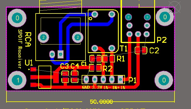

P.P.S The PcbDoc of the SPDIF board is 6mb and could not be uploaded, I'll just include a screenshot for now... would love to hear some feedbacks on it as it's not working well 🙁 have a 3.3V 200ma regulated supply feeding this and two dam1021 isolators, is there enough power to go around?.. Thanks!
