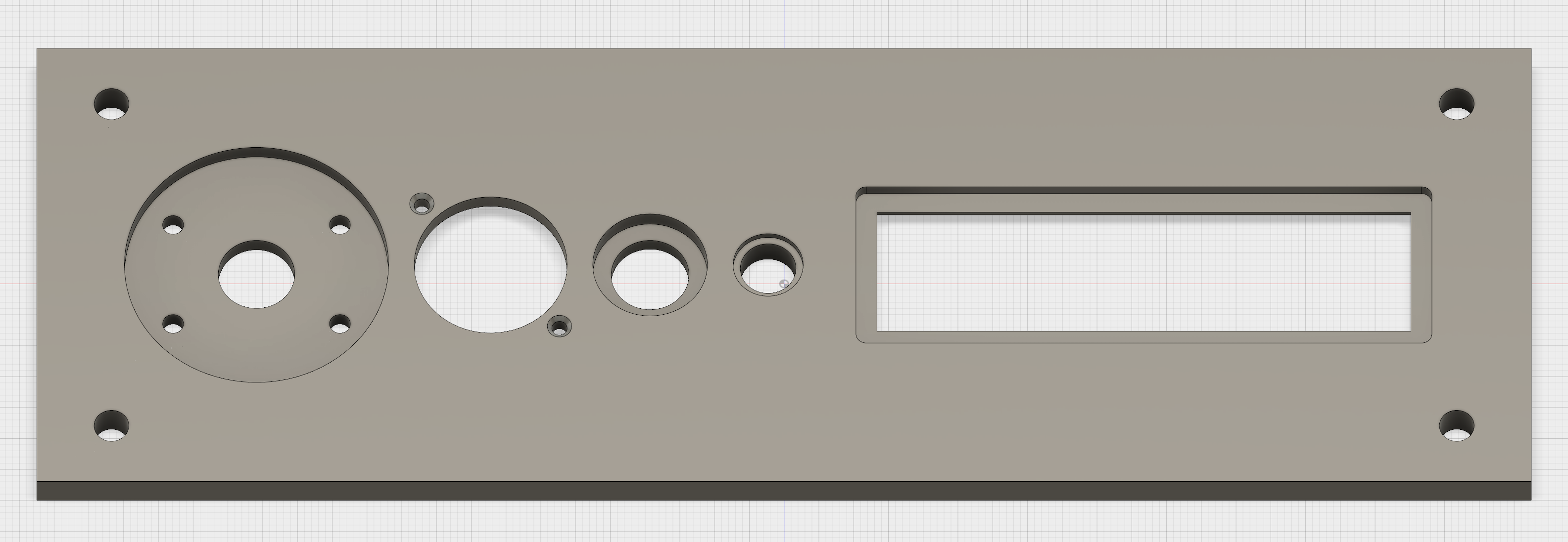

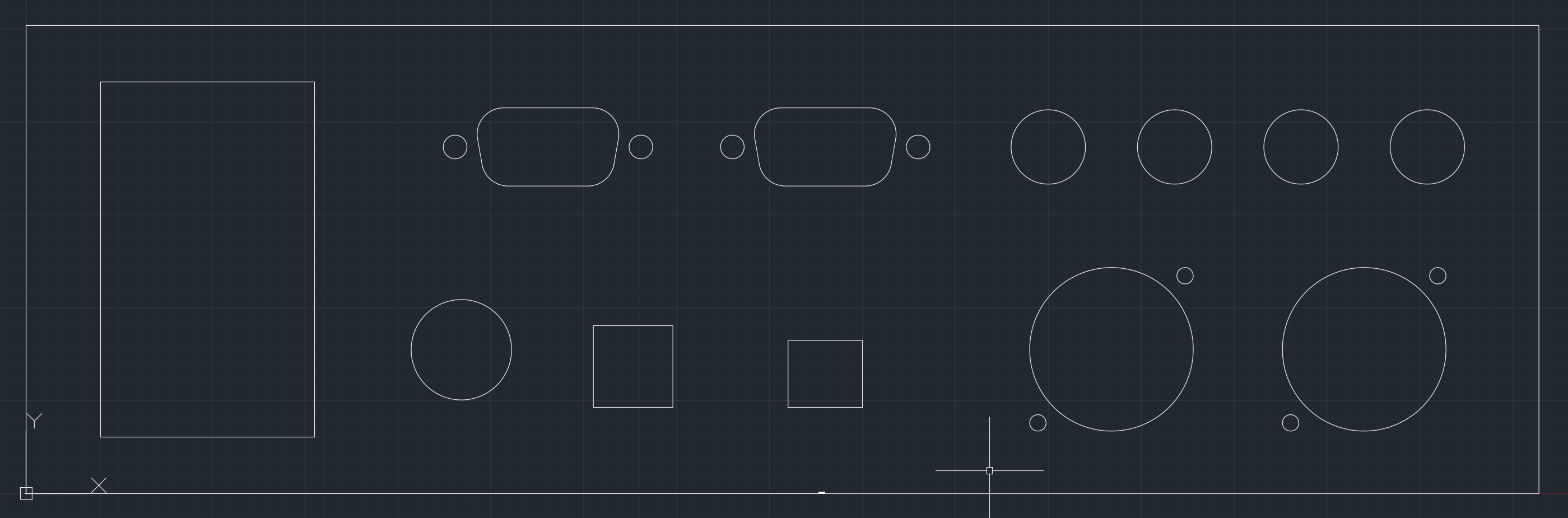

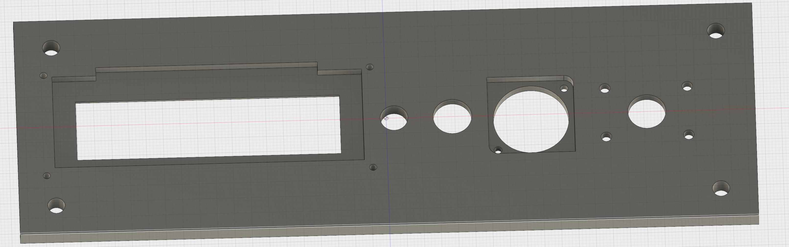

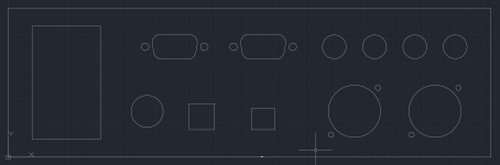

Also, would you happen to know the hole dimensions on the SK Lite encoder board? I measured 24*16, and Audiozen has not responded to my questions... I'm almost done with the front&back panel for the 215*228*70 dual mono 1021 enclosure. Here's a preview :)
Hopefully the case will turn out nice.. as will the sound of the setup. I'll keep you guys updated!
Sounds like your setup is a good candidate for dual-mono. I run raw outputs straight to headphone buffer and amplifier, no longer using the onboard buffers.
Finally ordered my enclosure but realized that to really do everything decently well in a box for hd650 there may be additional buffering required...
My goal is to drive hd650 well from an electrical standpoint, not worrying about subjective SQ for now. Would the onboard opamps suffice in a dual-mono setup or is there additional buffering/amplification required? I read somewhere that to get to the theoretical 120dB SPL of the headphone the peak power should be 12V / 40mA...
Thanks so much!
