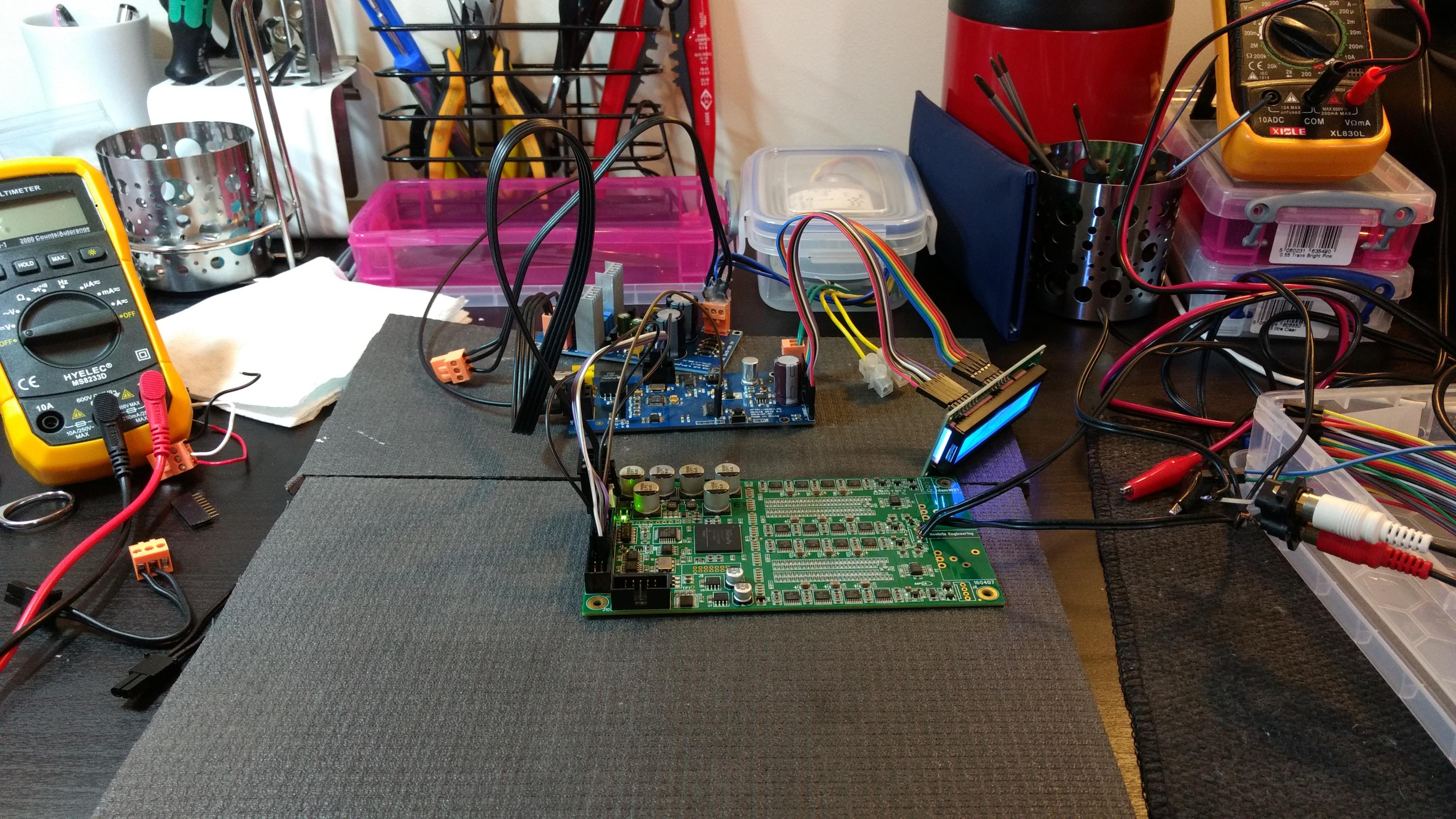

Hi to all ,
I think I need some help : today I tried the Vref mod by adding some MUSE 1000uF/50V at the points marked by soren in his post 3108 . The DAC works (in SPDif) , but every 20 seconds , it looses locking and at this time the 4V Vref disappears also . So I desoldered the caps and the problem still remain .
Any hints ??
Here is a picture of my implementation
Any hints ??
