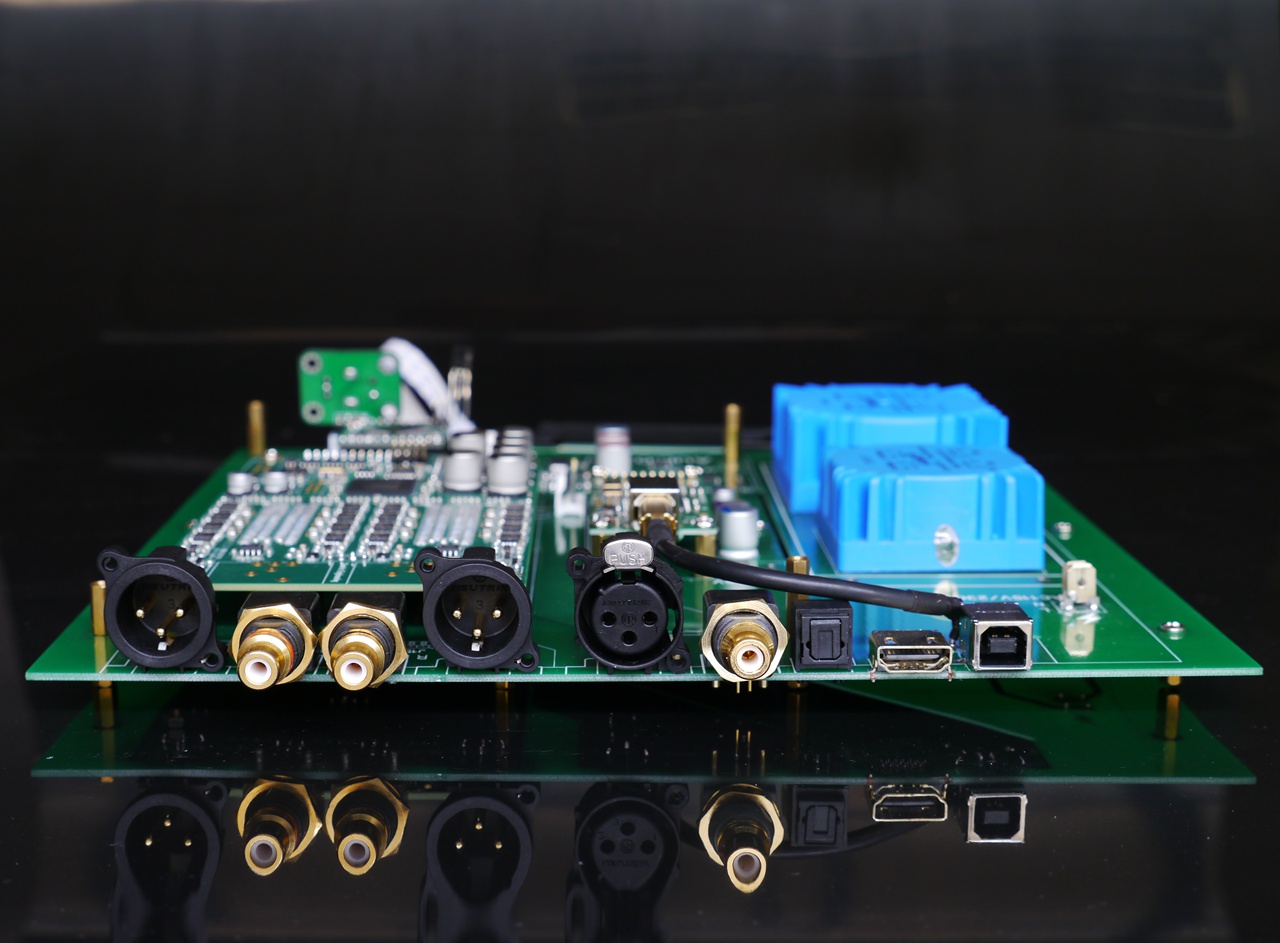

After more than half a year of revision and testing, the official version of the installation kits are finally ready to ship. There are 2 models,AZ1021 SK andAZ1021 SK lite.

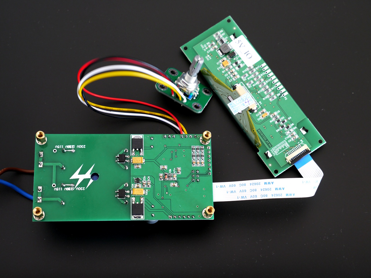

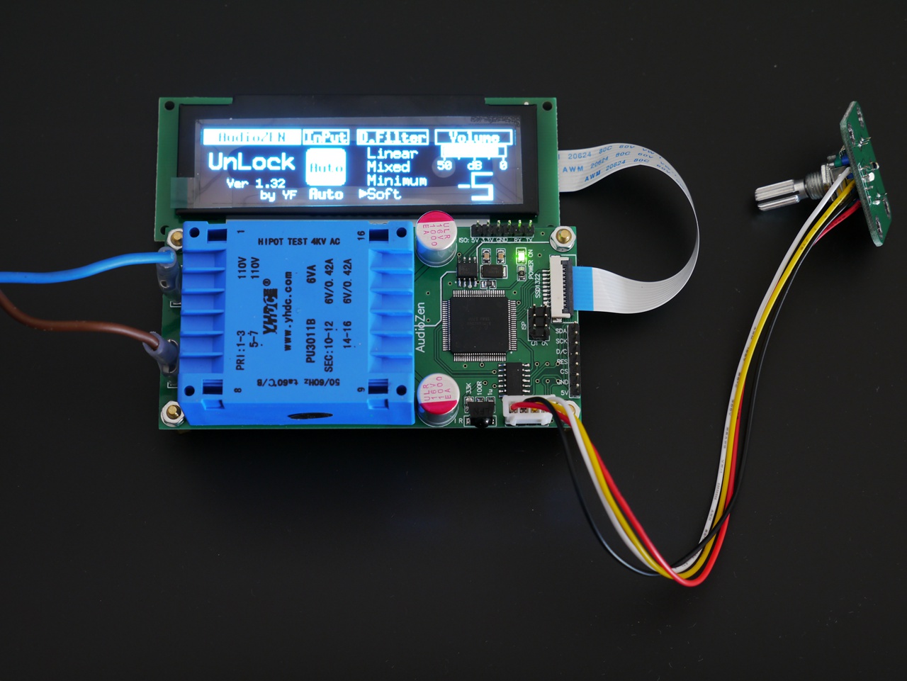

DAM 1021 SK lite specification
1. MCU control DAM1021/1121 via isolate serial port. Real-time volume control, digital filter switching, input selection, PCM / DSD sample rate display.
2. 3.1 inch OLED display(256 * 64 resolution).
3. One key mute (IRRemote only).
4. Rotary encoder or IRRemote will be control full function.
5. IR Remote control support learning function, support most kinds of IR Remote.
6. Power-down memory, automatically load the last shutdown settings.
7. With two different styles of display window, the screen display can be turned off
8. Using ISO7421 isolation chip between MCU and dam1021 / 1121, to ensure that MCU noise will not be introduced dam1021 / 1121.
9. There is a onboard transformer for power supply, AC 115V / 230V switchable. The output is completely isolated from the double winding, one power supply for the MCU and display part. The other power supply for the ISO7421 isolation chip, And provides 5V (400ma) and 3.3V (200ma) output, easy for the USB module and 1021 isolation chip for independent power supply.
11. Using high-quality solid capacitors, tantalum capacitors, ultra low noise ADP151, rotary encoder using ALPS EC11 type.
12. Display screen with FPC connector. While retaining the 2.54mm display interface(suppose SSD1322 256*64).
Attention: The transformer is included in the kits.

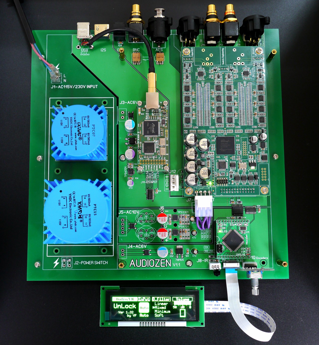

DAM 1021 SK specification
1. MCU control DAM1021 via isolate serial port. Real-time volume control, digital filter switching, input selection, PCM / DSD sample rate display.
3. One key mute (IR Remote only).
4. Rotary encoder or IR Remote full function control.
5. IR Remote control support learning function, support most kinds of IR Remote 6. Power-down memory, automatically load the last shutdown settings.
8. Using SI8642 isolation chip between MCU and dam1021, to ensure that MCU noise will not be introduced dam1021.
9. Input support: Optical fiber,Coaxial, AES, USB(not included), external I2S (LVDS mode).
10. RCA output can be switched between Buff and RAW.
11. Transformer board are detachable, support AC115V / 230V.
12. Use a separate winding transformer to power the USB module (amanero) and use ultra-low noise TPS7A47 for regulation.
13. Onboard TPS7A47 / TPS7A33 PSU.
14. A variety of DAM1021 power supply options.
Attention: USB module (combo384), the transformers are not included in the kits. In order to be more compact, the official delivery of the PCB will be smaller than that of the photo, removing the extra edges
PCB size & OLED colour
-AZ1021 SK : 220mm x240mm
- AZ1021 SK lite: 50mm x 100mm
-OLED colour:Green, Orange or Blue,please note.

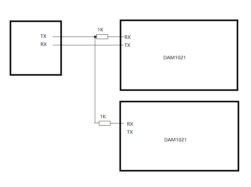

audiozen just PM'd you regarding an SK Lite. For a dual mono setup, shall I just take a TX line from a single dam1021 board and just presume the 2nd board will accept the RX serial commands asis? I believe this will work for basic control. I plan on having my USB-ttl adapters switchable in circuit so I can still do things like firmware upgrades and whatnot, while being able to switch back to the SK Lite controls.
Both The dam1021 ISO RX(J3) is connected by a 1K resistor and then connected to the TX of Lite.The dam1021 ISO TX picks one device and the other is suspended.
3.3 v and GND even need.
