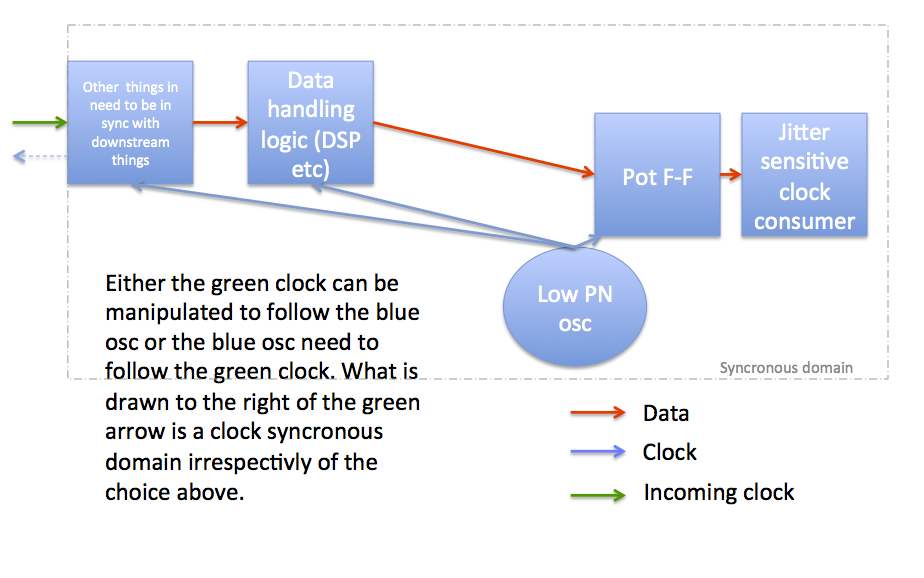

Locate a very low close in phase noise clock (oscillator) near to where it is to be used. Buffer the clock into 2 signals A and B. Drive a Potato flip-flop with said clock A positioned even closer to the clock user. Input the jitter laden data stream into the potato chip - out come jitter free data stream. Feed clock B signal "backwards" to whatever needs to be in synchronization with the clock.
can you post the circuit if you have?

Clock scheme... I skipped the buffering...
