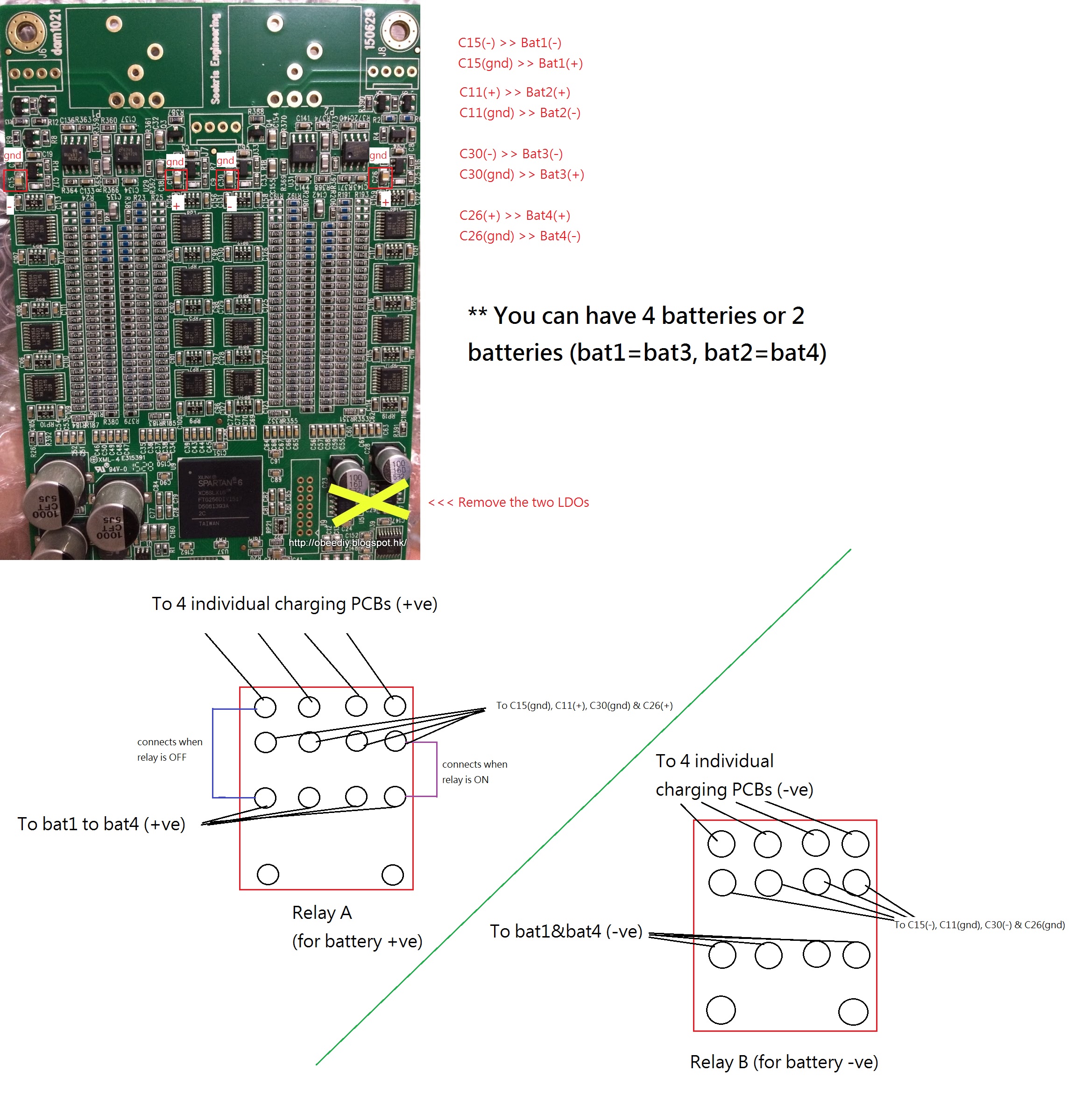

Hello Rick
Can you post some detailed pics of our battery setup? I think it might be interesting for others that also want to try battery operation.
How do you manage the recharging of the batteries? Manually or automated by a battery management circuit?

Allow me to share my setup. Please refer to the attachment. For other power rails, you can do the same. Only the r2r part is most complicate. You can use two or four batteries per dam r2r because they are separated already after the opamp. And please remove the 5V ldo. (you should also remove the original regulator for individual power rail that you want to replace)

As four batteries provide power independently and are not regulated (I assume) they should be providing (slightly) different voltages to different sets of shift registers. Do you hear any type of distortion when this happens?
Yes, you are right. Even for 2 batteries, due to their physical condition, the discharge rate may be different. As a result the voltage drop may be different.
For 4 batteries mode, the discharge rate is even diverse. However, as a human, I can't hear the difference in left/right balance.
I think this is one of the big issues when using battery in this area. However, my experience is that applying battery in this area affect the overall sound quality most. Whether this kind of "affect" is positive or negative, to me, it is positive, but to people who care about the correctness of signal, it must be negative.

If you use regulated ps to continously maintain the voltage levels voltages will be more consistant over time
Essentially its using the lifepo4 cells as capacitors
I dont know if regulated ps still can apply to there, as I know, the battery is 3.2V but the ps is 4V, I afraid prolong charging the battery will damage the battery. May be 3.7V battery is more suitable in this configuration.
Use external 3.3v regulated supply a linear one
Switch between ps and cells and between cells and vref and your good to go
regardless the stock reg would not last long if the batteries got depleted for any reason
i burnt out the stock 4v regs charging supercaps
ive got several float charged cells in various devices that are in constant operation for around three years and all works like clockwork no failures
besides the floating phenomenon is not exactly new
its used in alarm back up systems and almost every motor vehicle
