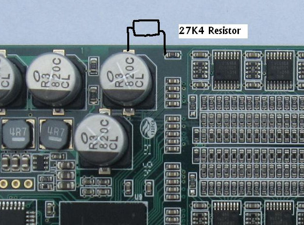

Done with next version of dam1021 firmware, all issues fixed and new filters and functionality added except:
1) Still a thump when powering off, but can be reduced to 1/3.
2) DSD support is for next revision, maybe two months outs.

Finally it's here, the first major dam1021 firmware update. I have named it version 0.99, please let me know if there are any issues, small or large. The plan is then to release version 1.00 in a week or two.
Firmware update on the dam1021 is done using the RS232 serial port, either by one large file or three separate files:

To update the dam1021 firmware, you need to have the rs232 serial port connected and working with terminal emulator software. Enter the uManager by typing +++. You should then get the uManager prompt, then you type
# download
Start download session using Xmodem CRC protocol, when all downloaded then type command to update the uC with new firmware
# update
You can then enter uManager again and verify revision 0.99 firmware is loaded.
Revision 0.99 firmware have the following bug fixes / improvements / new functions:
* PLL Clock Sync at sample rate change cut down to less than 0.2 second
* Isolated Serial port now works, note that port is at 3.3V cmos level
* Serial Port now interrupt driven, no character loss at high speed
* Volume Control now is -80db to +10 db, and phase bug fixed
* Volume Control also now have zero crossing detect
* Power Off plop can be reduced to 1/3 by adding a single 27K4 resistors, see picture attachment
* FIR1 filters doubled in size, so max 2032 coeff @ 44K/48K, 1016 @ 88/96K, 508 @ 176/192K, 127 @ 352/384K
* You can now select four sets of filters, named Linear, Mixed, Minimum and Soft.
* FIR1 coefficients are now 1.31 format, filters should be good down to around -150 db
* Stock filter now have improved deemphasis filter
* Input Source Select bug fixed
* New mode setting: Normal, Inverted, Balanced Left, Balanced Right
* The tiny bug on signal saturation on -full scale fixed
* Should now be possible to do balanced and crossovers by parallel the inputs and connecting the isolated serial ports together, more details to follow
