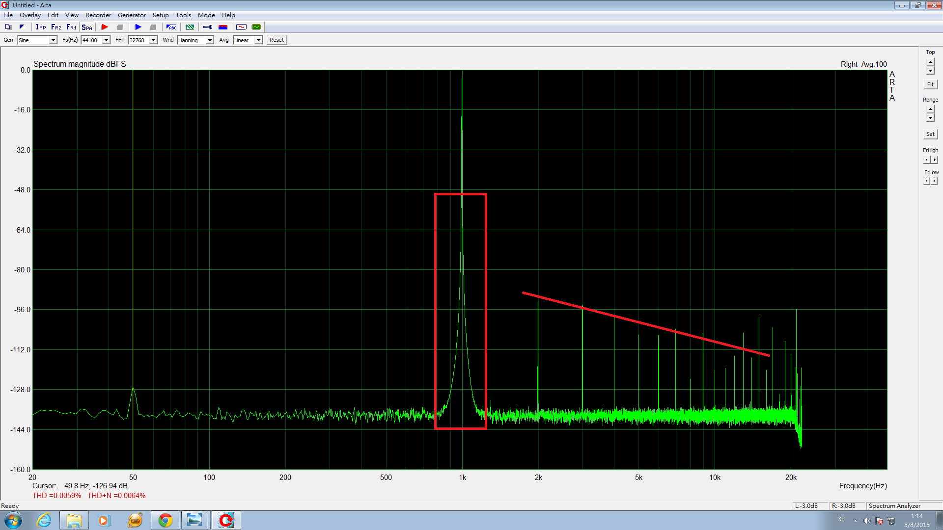

Some measurements before my mod.
Well, INMO this measurement shows hardly not a reference DAC..😕
May you provide interface (WDM /ASIO or...), sample rate and bits size used on your measurement. And just invite you to measure same thing using my Analyzer 😀
Specially the 19 to 20 kHz attenuation and also high IM content.

HpW, thanks for the comment.
It would be great if you point out to me which performance indicators look bad to you.
In case, please feel free to shed light on ways for improvement/modification.
Or, you can share your measurement with members here.
BTW, it seems that there is no standard way of using ARTA, specifically FFT in this thread.
Some members use FFT without playing any signal, others using different windows or FFT sizes as well as different fs...

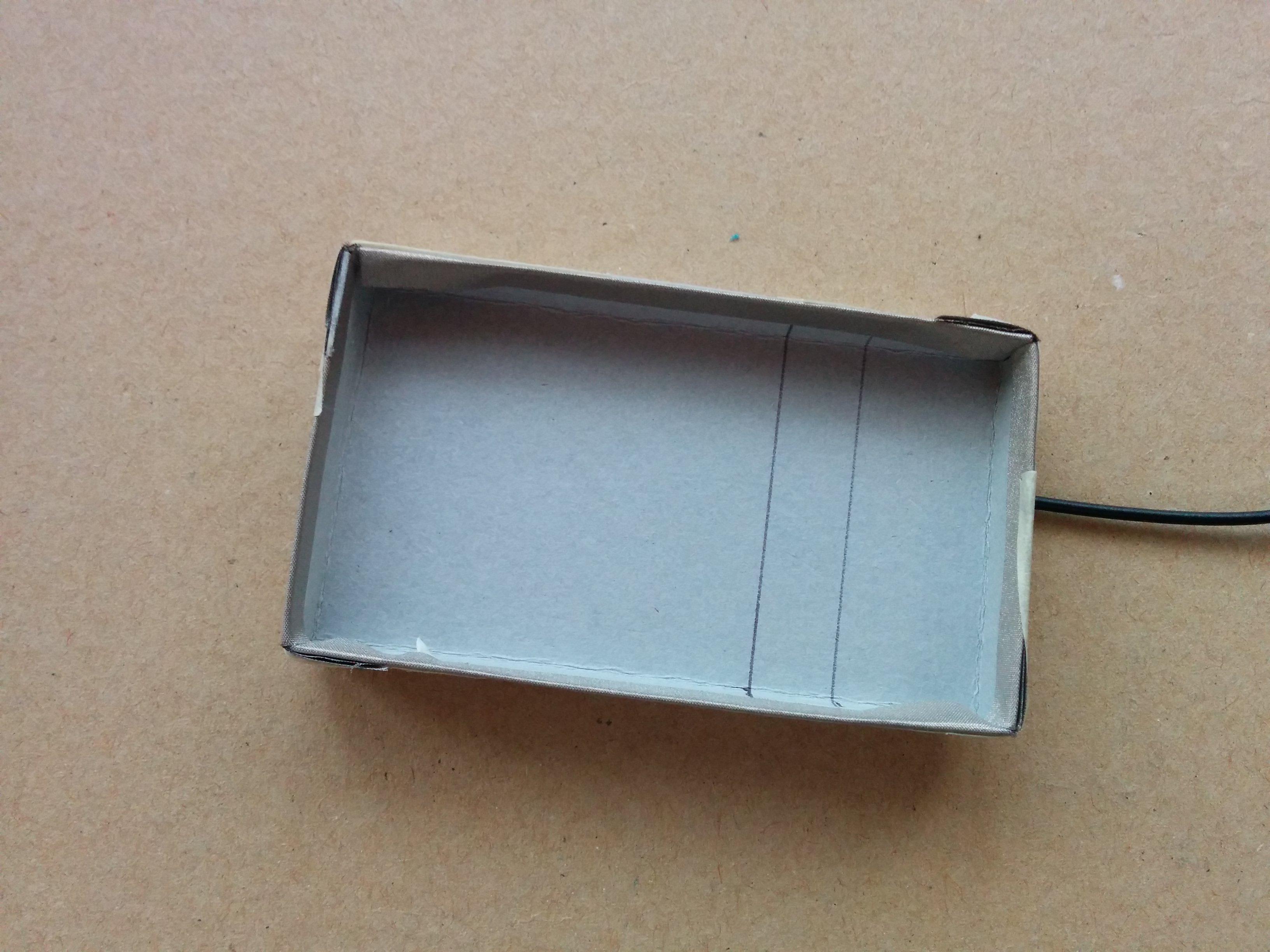

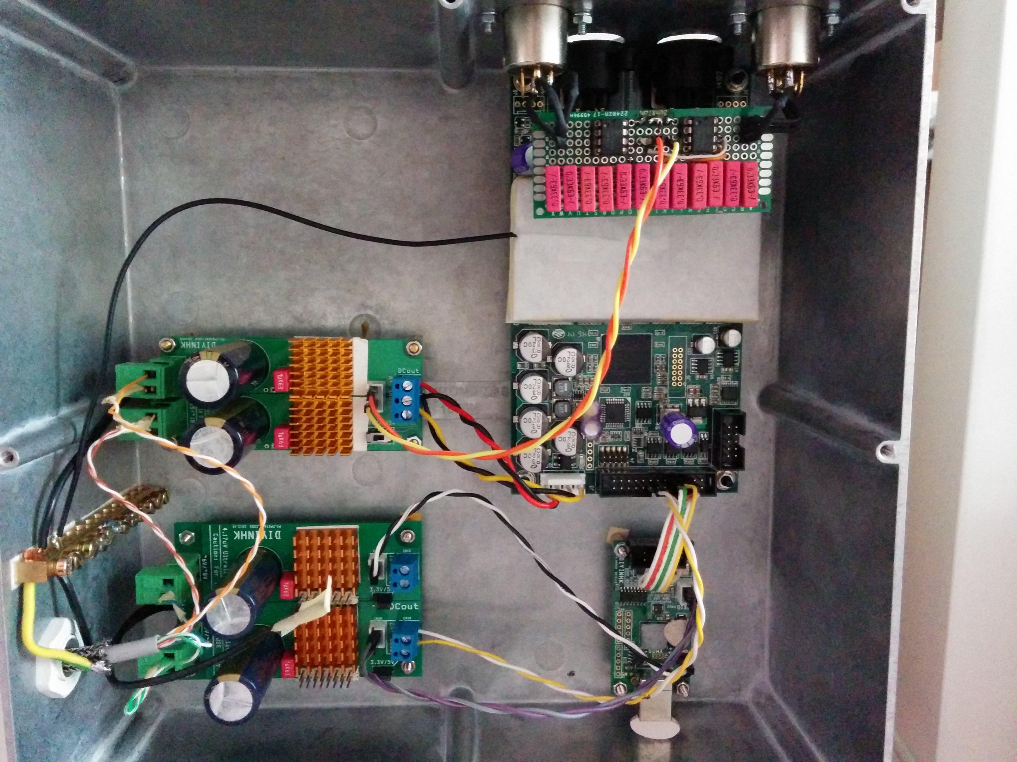

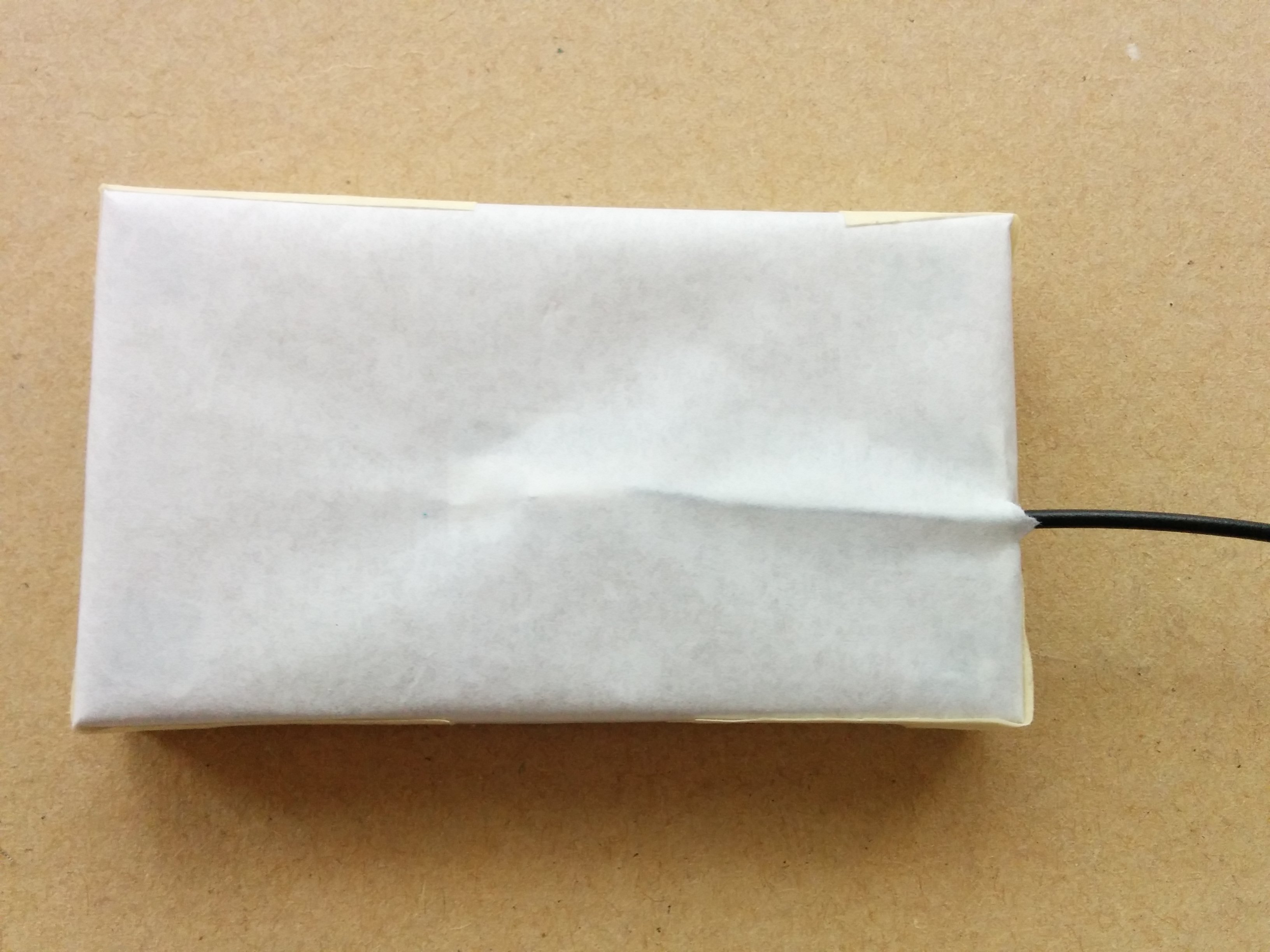

Has anybody tried to shield/cover the resistor banks with copper foil or similar?
That rather huge and sensitive open area might pick up this or that EMI/RFI/interference,,,
Just an idea.
Assembled a small box, made of cardboard, stacked with emi textile and sandwich paper 😛 for isolation. Soldered a cable (the textile contsists mostly of metal alloy) on top. Then used double-faced adhesive tape in the corners to fix near the resistor array and connected the cable to the earth groundig of the alloy housing.
I cannot say that there is an real advantage, but I'm too lazy to switch back and fourth. Maybe the hammond housing does the job well.
Actual system: DAM1021 0,05%, DIYINHK TPS7A4700 power, 4 OSCON 330uF/6.3V capacitors 4V reference, 1 OSCON 330uF/6.3V capacitor oscillator supply, EMI shielding of resistor array, DRV134 stacked on single ended output

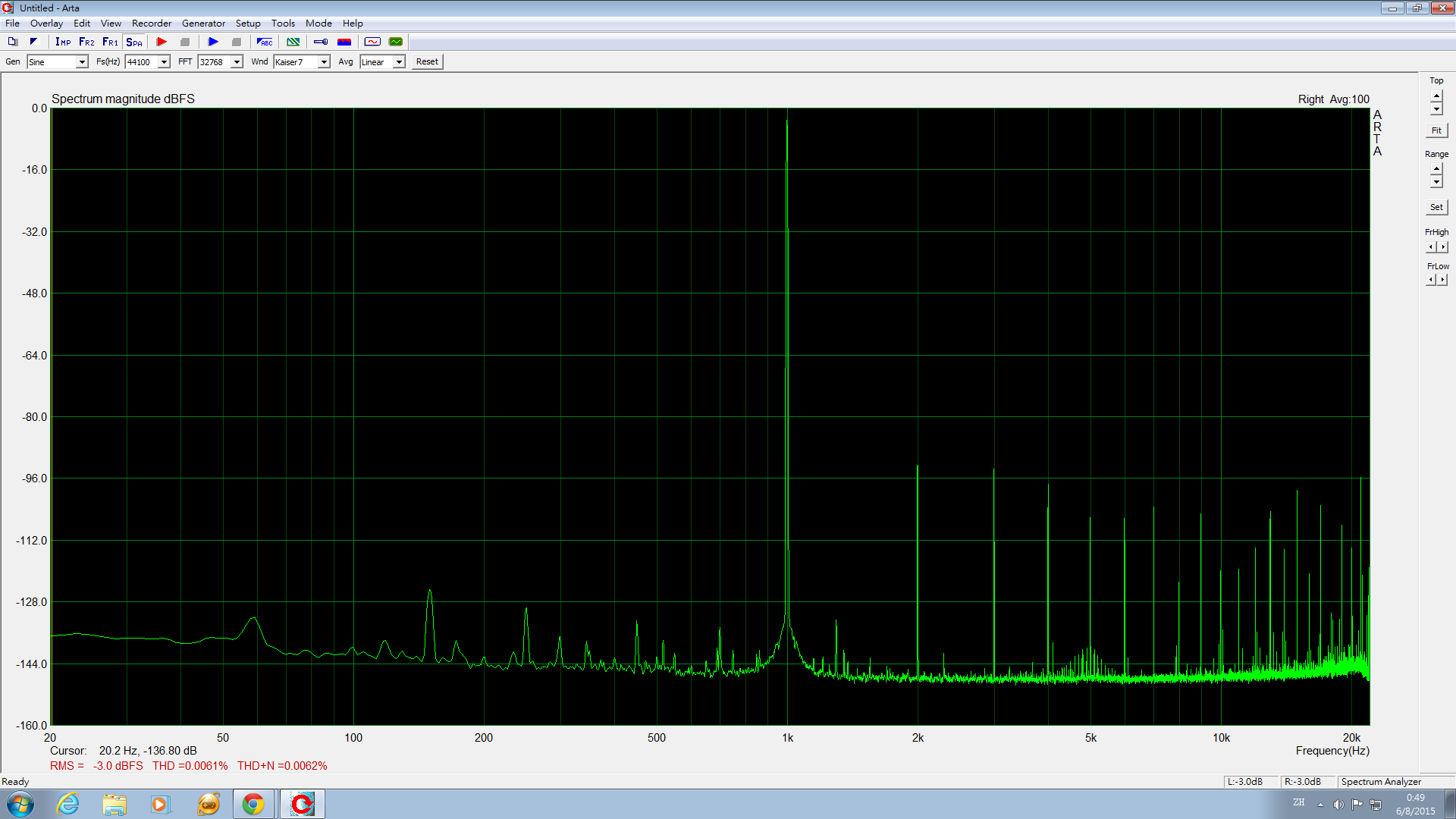

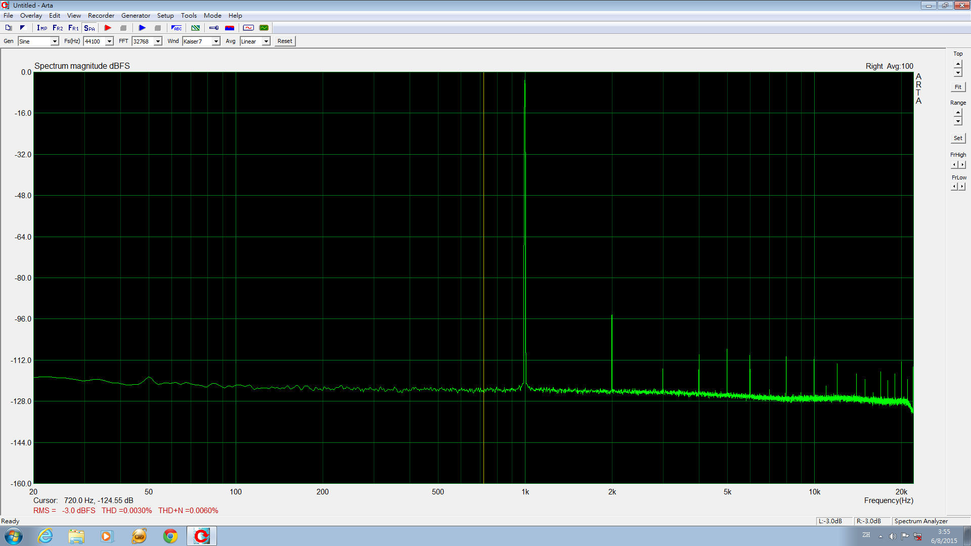

Measurement After the first mod
A simple measurement after the first mod.
For the PSU, I changed from Salas Shunt to an Talema transformer.
The noise floor goes down much, yet the harmonics distortion is "high" relatively.
Yes, it sound more dynamic.

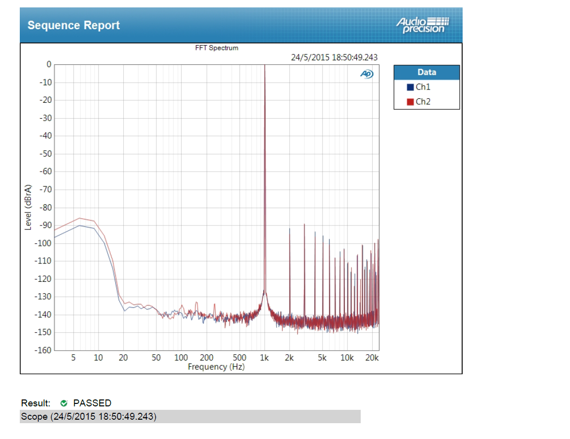

For the sake of reference, a measurement of Subbu Dac V3 is attached.
The harmonics distortion control is much better in Subbu Dac V3
although I love the Dam1021 sound much better.

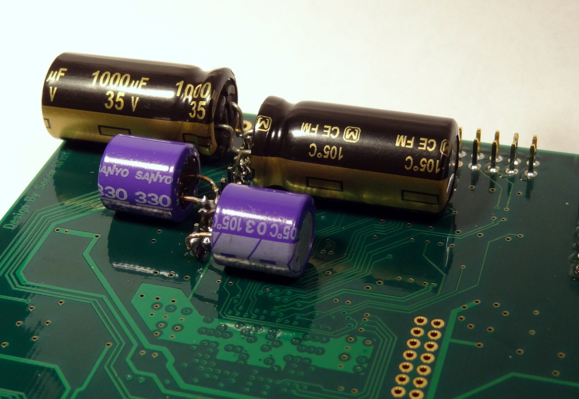

Bad news, after putting 4 x 470u FM caps to Dam1021 buffer,
the Vref went wrong. It went to 0V. Thus, the mod process need to be stopped here.

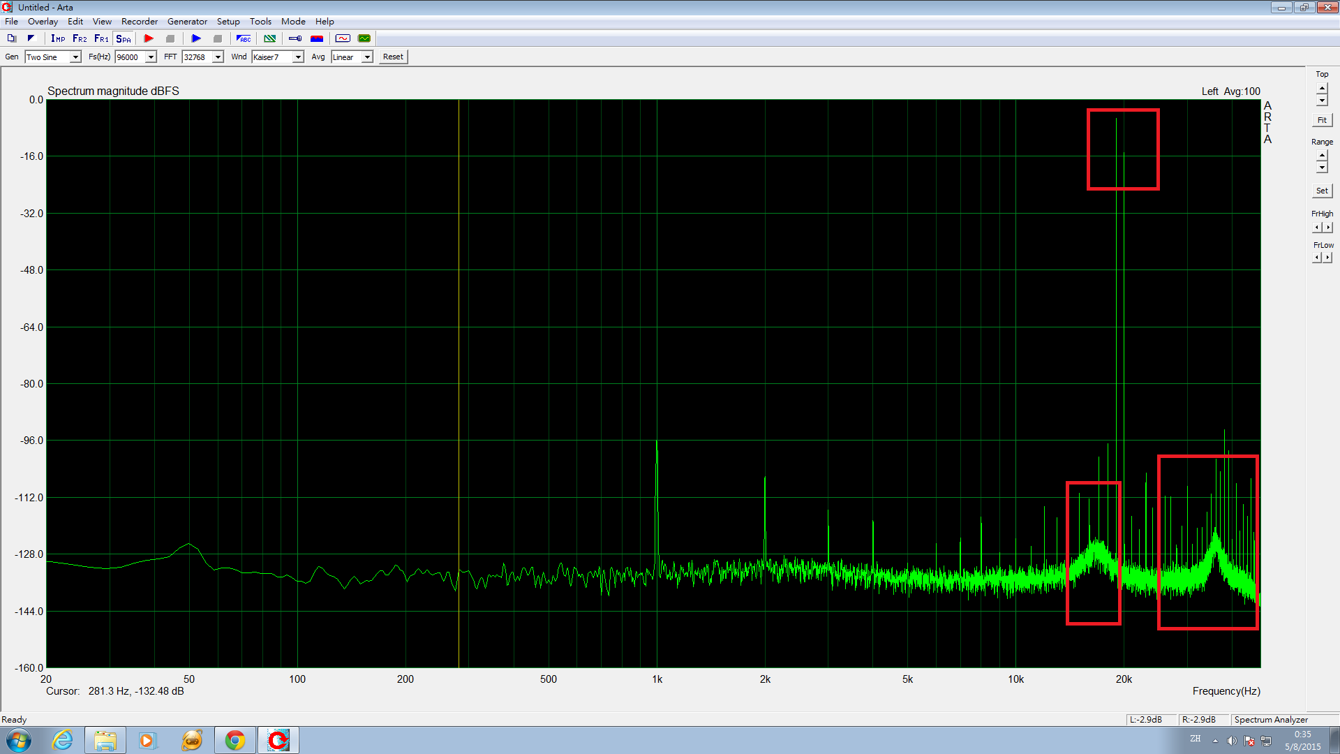

Arthur, OK, my indications are in red ..
first comment to 19/20kHz:
- 19/20 kHz have not the same level, may check your measurement and increase the sample rate
- some oscillation occurs... may look at http://www.diyaudio.com/forums/digital-line-level/269776-filter-brewing-soekris-r2r-125.html#post4414763
second comment on hum-less:
- spectrum content looks like as a square wave 😱
- may increase also the sample size from 32k to larger and use a better performing FFT Window as the Kaiser 7 😀
Great idea to shield the resistors. It may work better if you manage to connect the box directly to the DAM ground plane in as many points as possible along the perimeter. Ideally, to make a Faraday cage, it should have uninterrupted contact with DAM ground plane along the entire box perimeter, but that is unfortunately not possible with the existing board layout.
Connecting it at only one point by a long wire makes an antenna, not an EMI shield.

If you find my explanation not convincing, please refer to the attached FFT made with an Audio Precision Apx 515 in May ( in fact, you can search my previous post to find a more detailed Audio Precision measurement of Dam1021 in late May).
Do you think that Audio Precision APx515 is using square wave for FFT?
IMHO, Soekris has done a great job in designing the DAC, in particular the noise control (the very low noise floor even by plugging an transformer) and how it sounds. Of course, we are looking forwards to his firmware update/grade and other improvement of the design. Specifically, I want to have a dual mono balanced implementation of the DAM1021 DAC.
My only dissatisfaction about the DAC is its high THD (although I doubt whether people can hear harmonic distortion at -8xdB level). In comparison, an old PCM170x DAC (designed by my friend) has lower distortion than the DAM1021. And, its THD compared badly against the Subbu DAC V3's (see the figure posted several days ago).
Thanks for including measurements of our V3 compared to a modified/improved DAM1021. I think the comparison is somewhat off as DAM1021 is way more expensive (and R2R) but I would not hesitate to do it myself too if I had the DAM1021. Still the Subbu V3 does perform quite good when taking price and simplicity in consideration. To be honest I would choose the V3 if only measurements are concerned 🙂 (just joking, I would never advertise my own stuff
On FFT by ARTA
1. Members posted FFT in this thread. However, few generated FFTs with 1kHz signal.
In addition, at what was the 1kHz signal played? at 0dBFS? -3dBFS? or, -60dBFS?
There is no consistent way of making measurement, FFT can't be compared effectively.
If you use a lower level signal, you get better looking FFT. If one does not play any signal, you get a MUCH lower noise floor. Personally, I use -3dBFS and -60dBFS at 997kHz. Yes, 997kHz. Some software produce fuzzy looking FFT with 1kHz. I found TotalDAC reporting 1kHz signal played at -110dBFS absurd. Stereophiles used -90dBFS for measuring MSB Diamond DAC...
2. when you make the FFT, what fs is used? Personally, I only have 44.1kHz music files,
I use primarily 44.1kHz. Since I find the Dam1021 has much high frequency noise near the 30~40kHz region, I also use 96kHz to check if there is improvement at this region after modification.
3. FFT size. I don't know if there is a standard value. The larger value the FFT looks better.
4. For the sake of comparison, I primarily use Kaiser7 as most members use this window. However, I also use Hanning because Seokris used Hanning in the first post.
5. Members using different soundcards with ARTA. I doubt whether the results are consistent and repeatable.
