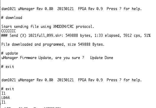

Hi
I have a problem updating the dam. After the update the dam does not lock to spdif anymore (which is my only input) It clicks while trying to lock to I1 but it does not lock.
I use ZTerm and up to now everything went smoothly, but this update does not work, after the update I still see 0.9 in the umanger (attachment)
Even loading 0.9 again does not restore the locking problem. I looked at the spdif input with a scope and everything looks as before the update....
Does anybody know what went wrong and how to get the dam running again...

ok, I got the dam running again by simply uploading a new filter, but I still get the fpga update not working... but anyway, that is not an emergency anymore, so I will look at it a little more...

Seems like it didn't get your 'y' when asking "sure", should say:
uManager Firmware Update, are you sure ? Updated, resetting.
And then the reset. In your screen dump it don't reset, just return to the prompt.

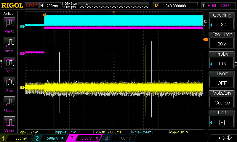

By high frequency I meant hundreds of kHz, reaching into MHz range. But yes, there is also a low frequency component to that pulse and more.
For these measurements, I2S signal was switched between Raspberry Pi 2 and DIYINHK USB interface by a 74HC257 mux. The switch was controlled from a RPi GPIO via software.
DAM1021 was configured with "Mixed" filters.

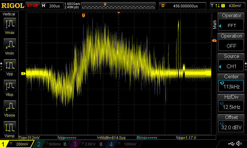

First of all, this is the pulse dam1021 emits while locking. The amplitude seems to vary randomly between 0.9 and 1.3 Vpp on unbuffered outputs. The shape is always more or less similar. Such a thing should never appear on analog outputs, regardless of how broken the digital sources might be.

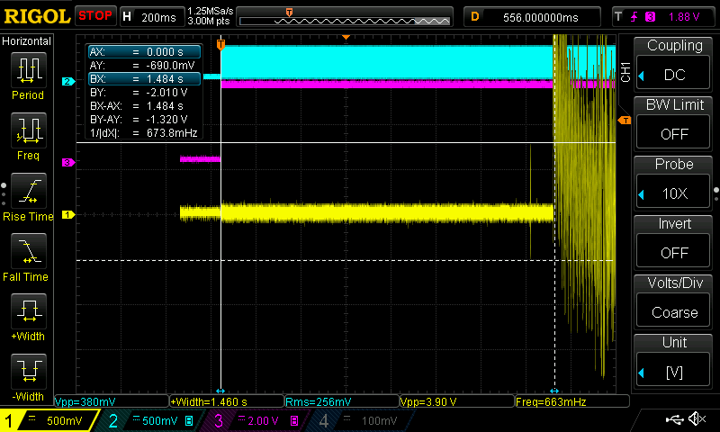

The timing on this pulse appears to be quite random. Here are several attemps captured at 44.1 kHz sample rate from DIYINHK USB interface, with no audio present. The other I2S source was off for these measurements. dam1021 input selector was set to I0 (I2S). Yellow and white overlays show the analog output for the same channel captured during several locking attempts. Cyan is the word clock and magenta is the control signal switching the I2S source. Bit clock is not captured here, but it is always switched together with word clock during these measurements.
attachment.php
Some observations on locking speed. The locking time in each scenario varies seemingly randomly by a few hundred ms.
When all I2S lines are started from off state, it takes quite a long time for DAM to lock, approximately 1.5 seconds:

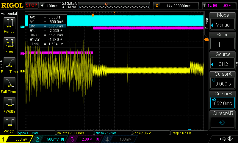

dam1021 locks much faster when switching between different sample rates. Here is the switching behaviour between 44.1kHz and 96kHz. For the approximately ten measurements that I took, locking time varied between 250-650 ms.
When switching from 44.1 to 96 kHz sample rate, there is a blip of 96 kHz audio right after the rate change. Don't know if it is distorted, but no doubt it contributes to the perceived plop. It always happens when switching in this direction, but not the other way around.

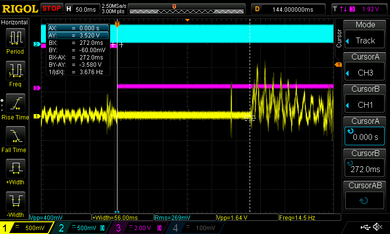

Switching from 96 to 44.1 kHz looks pretty good, apart from that ever-present pulse in the middle.
