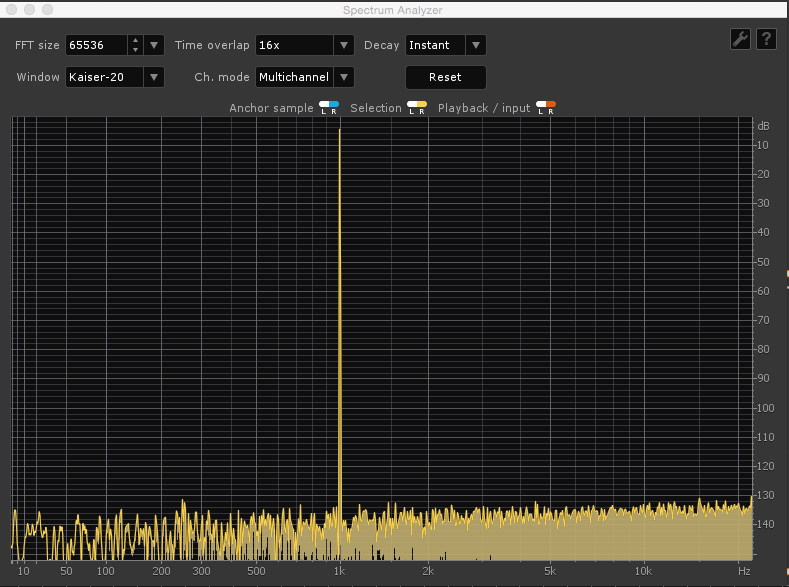

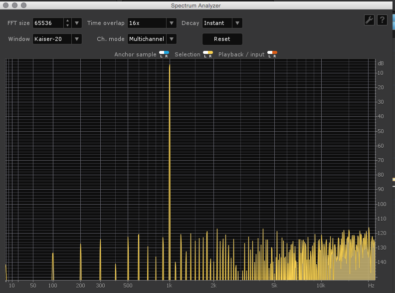

It's a bit of bogus argument to cite PCM63P specs. The published figures were done using 997Hz sine test tone rather than the more usual 1000Hz sine tone. That makes a fairly substantial difference.
This shows the difference in distortion levels of test tone .wav files.
997Hz test file:
attachment.php
1000hz test file:
attachment.php
You can see why BB chose to use 997Hz.
Well, to choose a specific frequency is often to have a coherent measurement where the FFT Windows smearing can be skipped using "No FFT Window". 😀
BUT, your measurements and source wave(s) may do not have any noise dithered and this is the cause of the seen artifacts ...
