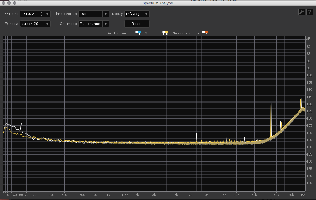

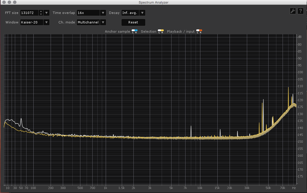

I've attached two spectrum analysis I did a few weeks ago. Both are done with the TOSLINK connected but no signal, so the DAM is unlocked. Volume is set to V+00.
The main peak of noise with serial connected is at 80kHz, and I suspect this is related to the onboard switching power supply on the serial interface chip. There is a second peak at 40kHz, and third lower peak at around 46-8kHz. There are other minor differences close to the noise floor of my setup.
I have the transformer in an ABS box, with an umbilical with +/-7.5VAC running to the DAM.
The only grounding of the DAM is currently via the XLR jacks.
I'm using a USB->RS232 adapter, hooked to a MacBook Pro.
Setup is not calibrated, so I make no claims beyond relative differences between the two.
