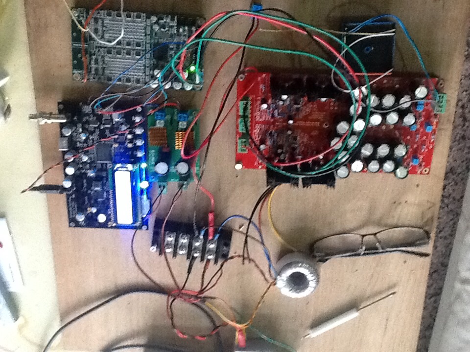

Seems most of us are still at the 'on wood' stage. Just easier to experiment, I guess. Mine is on MDF and a DC supply as well. I thought the DC an improvement over the AC feed.
Don't see your pop-fighter circuit in the photo - did you ever post the schematic?
Blinky light muting with proper delay: I been wanting to minimize this to a single active mosfet to simplify things so waiting on those. My test relay only had a single NO contact so was only useful as a concept. NO isn't ideal for a shunt so I had to order some small takamisawa dpdt signal relays. You need the relay to collapse almost immediately upon power loss and thats much easier to accomplish than having to energize a relay to avoid a poweroff amp killing surge. I don't think anyone here wants to run their audio in series with a cheapo relay.

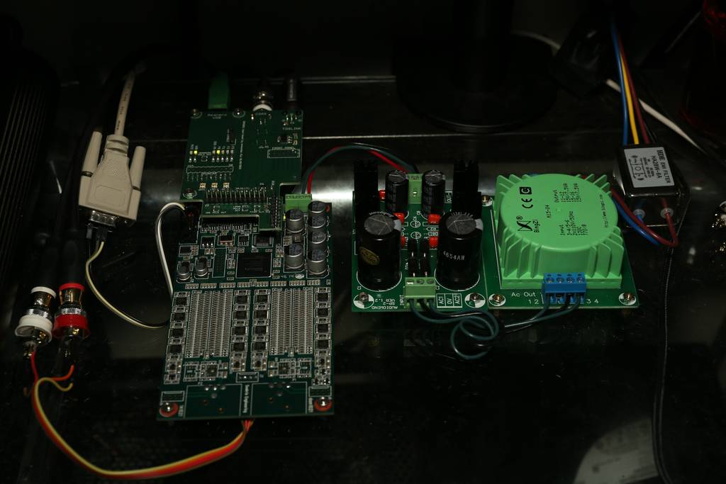

I've attached two spectrum analysis I did a few weeks ago. Both are done with the TOSLINK connected but no signal, so the DAM is unlocked. Volume is set to V+00.
The main peak of noise with serial connected is at 80kHz, and I suspect this is related to the onboard switching power supply on the serial interface chip. There is a second peak at 40kHz, and third lower peak at around 46-8kHz. There are other minor differences close to the noise floor of my setup.
I have the transformer in an ABS box, with an umbilical with +/-7.5VAC running to the DAM.
The only grounding of the DAM is currently via the XLR jacks.
I'm using a USB->RS232 adapter, hooked to a MacBook Pro.
Setup is not calibrated, so I make no claims beyond relative differences between the two.
Is the 8Khz peak cause for concern?

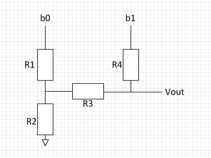

The inaccuracy of the ladder resistors is a systematical error, i.e. it is not random (apart from the thermal part). Thus in principle it should be possible to correct it by using something like the gamma-curve of our computer monitors as last step before sending the data to the DAC ladder (i.e. switch the bits that actually produce the desired voltage, not the one that should produce it).
This way at least the resistors in the MSB region could be corrected
... these are the ones which use the expensive high precision versions, good
The errors are not systematic. They are more or less random in R-2R and very hard to get out unless you are willing to calibrate every bit. The big problem is that beyond a certain point, an R2R is no longer monotonic. That is, a lesser input value begins to deliver a higher output value. That should never the be the case in a converter. A converter should always be monotonic across its rated range.
Here's an interesting simulation you can do by hand:
Start with a simple 2 bit R 2R DAC, such as attached. Generate all resistors with a random uniform distribution of a given tolerance and check your manufacturing yields.
In the case of a 2-bit DAC, let's say I used resistors with +/-40% error tolerance and I "built" 1000 of them. Let's look at one that failed to deliver at least 1/2 LSB of error (in other words, it became non-monotonic)
Normally, let's say target for R = 1K and 2R = 2K. In the simulation I can see failure occurs when R1 = 1379 (31% low), R2 = 1470 (26% low), R3 = 711 (29% low) and R4 = 2622 (31% high). For b0 = 0 and b1 = 1, R1 and R2 parallel to 711, then they sum with R3 to 1422 ohms. Then, we have a divider that is formed by R4 (2622 ohms) and 1422 ohms. That gives an output voltage of 1422 / (1422 + 2622) = 0.351V. Assuming b0 and b1 are 1V or 0V, that means that instead of 0.5V with perfect resistors, we get 0.351V.
Now, the perfect values in a simple 2-bit converter are 0V, 0.25V, 0.5V and 0.75V. 1/2 LSB = 0.125V, and so 0.5V - 0.5 LSB = 0.375V. From the above example, we see the output voltage 0.351, so this simple 2-bit R 2R DAC became non-monotonic--failed to deliver the rated accuracy--with the above resistors.
Remember, too, that I "built" 1000 of these using random resistor values. In fact, 93.8% of them met spec, and the above example was one of the 62 failures that didn't meet spec.
But, with this failure rate, we can now do something kind of magic. In order to add an extra bit of resolution and keep our 94% manufacturing yield, we must halve our error. So, a 2-bit DAC with +/- 40% resistor tolerances achieved 94% yield in our virtual factory. A 3-bit DAC thus needs 20% tolerances to achieve the same. And:
4b needs 10%

Running simulations again, with 0.01% resistors and targeting 16bit performance, out of 1000 builds with uniformly distributed 0.01% resistors, only 33.3% deliver 16-bit performance. The breakdown is as follows:
100% can deliver 12-bit performance
94.2% can deliver 14-bit performance
30.8% can deliver 16-bit performance
8.6% can deliver 18-bit performance
1.8% can deliver 20-bit performance
In other words, even with 0.01% resistors, the performance of an R 2R DAC is a crap shoot beyond a certain point. Some (1.8%) can deliver very good performance. Most will be barely able to deliver ~15 bit performance. A good 16-bit converter can deliver -110 dB THD. A good 12-bit converter will deliver about -80 dB THD. And THD is one way that monotonicity (or lack of) will manifest itself.
So, back the error correction: You can solve a 2-bit R 2R DAC in excel very easily, and generate random resistor values to see the yield rate. Then, you can try to see how to calibrate out those errors. It's hard to do, even in a 2-bit DAC.
The silicon guys will use R2R to roughly 12-13 bits or so. Then, they use gain switching to bring the converter up to 16-bit or so. See DAC8811 as an example. Note the silicon guys can deliver very good matching of resistors on die, and they have a long history of building trimming structures. But even with all that, they don't expect more than 12 or 13 bits from R2R AND they haven't come up with a novel way to calibrate out the error (due to the random nature).
In the case of a 2-bit DAC, let's say I used resistors with +/-40% error tolerance and I "built" 1000 of them. Let's look at one that failed to deliver at least 1/2 LSB of error (in other words, it became non-monotonic)...

I think you miss my point. I do not want to do a simultaneous correction for the whole production lot, but a individual correction for an specific DAC.
Yes, understood. I was just highlighting how the performance alone could vary across a build of 1000 units given 0.01% resistors.
The resistors of one individual DAC have no error at random, but an fixed deviation from the value they should have, so an systematic error. There is no random anywhere in sight for a individual DAC, i.e. you can calculate its ouput within the precission of your measurements.
Yes, but in a 16-bit converter, 1 bit is 15 ppm. The resistors likely have a 5ppm tempco, which means even a modest thermal gradient across the board limits you (still) to less than 16 bits. In fact, the bigger source of error is the drivers for each tap. Those are pmos and nmos, and those have a massive tempco themselves. As you increase from 25 to 50C, your Rds(on) of the pmos source or nmos sink increases by 25%.
If you have a 1K R, and 20 ohm pmos rds(on), as your unit increases by just a 0.25 degrees, you will already change your effective tap resistor from 2K + 20 to 2K + 20.1, which is far more than a single LSB. You can calibrate this out at a fixed temp, but then someone walks by, swirls the air and things change again. 15 ppm is very small!
So, I'd argue that no matter what you do you are really stuck at 14 or 15 bits. it is inherent to the R2R. Don't fight it! Enjoy it for what it is! That's my point! If you want crazy low distortion figures, then move to sigma delta.
