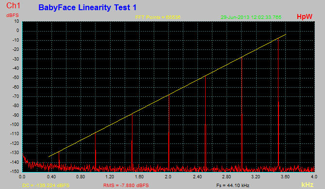

Here is a simple linearity test I did some time ago... 😀
It's just a simple proposal and the levels have to be taken carefully... 😱
