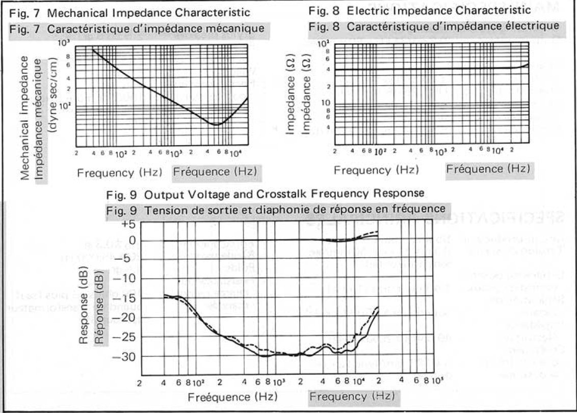

Are you sure (SHURE?) about this George?The issue that I see with the DL-103 is that it transmits vibrations to the tonearm.
It's some 30 yrs since I used one but Denon 103 has quite low tip mass which is the main factor in exciting both the record and the arm.
As I said, it is the trackability which correlates with vibrating vinyl and arms.
Of course, it is possible that a cartridge has such low compliance that this affects trackability at LF and this would then transmit stuff to the record & arm .. but DL-103 has actually quite good balance of trackability features.
It does need a medium mass arm though which might have led to this myth. My senile memory may be faulty but I think I used it with an SME Series 3 (gold titanium tube) with added mass ... also a Linn Ittok.
