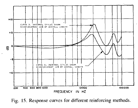

Thanks for the Holman article link, kgrlee.As I've said earlier, the SHURE papers deal with both the cantilever modes as well as vinyl. Don Barlow certainly didn't just analyse static vinyl.
I'm dredging up 30+ yr old memories but IIRC, elastic vinyl is necessary to explain how a low tip mass spherical stylus can have low distortion. The 'modern' example of this is Denon 103.
Over the years I've read many Shure and Barlow articles, and there's one I recall which ran a Fortran simulation of cantilever flex along the lines we are discussing. Does that ring a bell ? I have it somewhere. But, IIRC, the flex modes it examined aren't available in practice because effectively the stylus is retained by groove walls.
But I'm not aware of anything which considers the dynamic elasticity of vinyl in situ - perhaps because it was taken as read as having 'known' properties. However, from a dynamics and energy perspective, I couldn't see how vinyl can flex at all: too much energy would be left behind, and there's not enough time for compression to happen.
It is difficult to tell the difference between cantilever flex and vinyl compression, and even as far as distortion is concerned the same effect is produced.
I've attached a plot of a measured mechanical only frequency response of a quad cartridge, originally from Shibata IIRC, perhaps from a Happ paper. You can clearly see what appears to be two distinct resonant systems.
However, if one simulates mechanical flex impedance for a cantilever only, using just permissible vibration modes, one can readily obtain likely candidates to match the Shibata plot shape. The first two resonances in a series, as classic physics predicts.
Given that two flex resonances must be there, ie if one if possible so must be the 2nd one, and empirically there is no other resonance observed, its safe to deduce that vinyl compression is not present I figure.

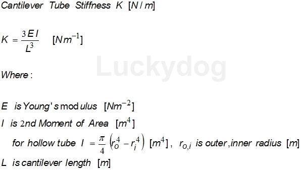

Here you go, Bill, first attachment is an equation to determine cantilever flex stiffness, ie its spring constant, given dimensions and material properties.

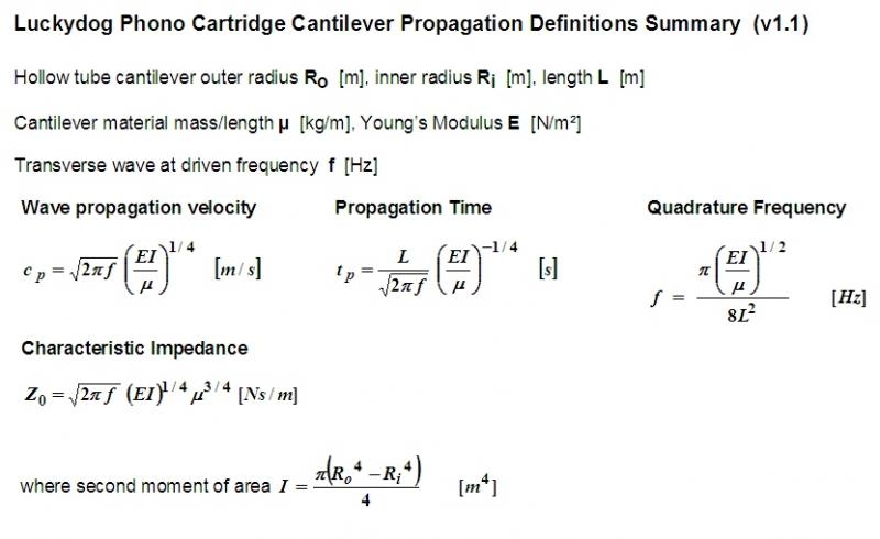

Second attachment treats the cantilever as a transmission line: if it flexes it will convey deflections as transverse waves along its length. So equations for propagation velocity, characteristic impedance, quadrature resonance, etc which might seem familiar terms to electronics engineers........

Sorry was in a rush and missed out 'we can't measure the wall thickness easily for our Al cartridge'. Do you have numbers ? Actually do we even know the grade of Al used?
I'd assumed reverse engineering from measurements might be easier...

One property of mechanical TLs that one doesn't find in electrical TLs is dispersion: different frequencies propagate at different velocities. Prob not enough to make any difference in cantilevers, but pretty weird. It's why one hears a train coming by hf sound in the rails first.......
Not to hand, and because one of the terms involves 4th power of cantilever radius, it matters to be specific to the cantilever at hand, and be quite accurate.
To measure it, I used a micrometer to (carefully!) measure cantilever diameter. Then an optical microscope to observe the stylus mounting flank which is made by folding the tube flat, but has exposed end section that allows one to see the wall thickness. By comparing optically to the tube radius, one can estimate wall thickness.
It's much easier for solid rods, just measure outside radius, and use inner radius=0 in the equations.
Yes, it's another spherical cow moment, but the principles are interesting I think. And, as Yoda said on the topic, 'you must unlearn what you have learned about cantilevers'.
It's easier for MC carts: look for the 1st hf resonant system, or 'top resonance'; it's always there but sometimes ultrasonic, sometimes audioband. If one believes that to have this cause.I'd assumed reverse engineering from measurements might be easier...
