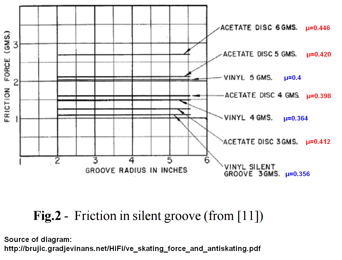

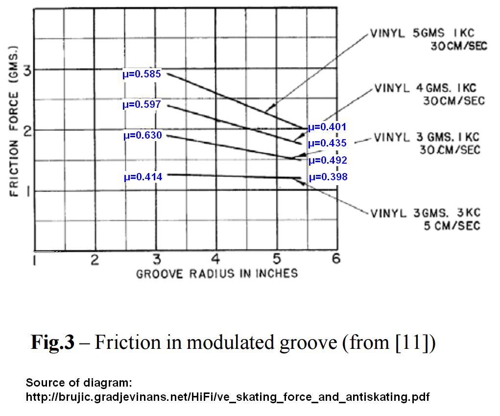

I looked closely at Fig.2 and Fig.3 for to find out what is the mu on those curves (see attachments).
The surprise (*) was on Fig. 3, where on 30cm/s modulated grooves, mu lowers when tracking force increases.
(*) well, it's counter intuitive but seems to agree with the anecdotes that higher tracking force seems to lower surface noise.

Lucky, what is the formula you use to come to this? (if you have explained it in the past, please link me to that post).
Acc to the equation Ff = Fv • µ this is not possible.
What I mean is that average stylus-groove friction force along the groove remains constant no matter what speed and direction the groove moves in. But tonearm drag it induces is subject to a mechanical disadvantage for a modulated (angled) groove, because the angled groove creates a lever.
Therefore if µ is 0.4 and mechanical (dis)advantage is 4, instantaneous drag force induced would be 4*0.4*Fv I think. When applied to an angled groove in this case, there apparently is an associated upforce which exceeds VTF: it's probably untrackable because the stylus would lift upwards momentarily, which is mistracking.
Same applies to drag induced by cartridge suspension movement. If the groove-stylus interface were frictionless, it doesn't matter to trackability what groove angle is presented, apart from mechanical impedance provided by the cartridge suspension and stylus inertia as the stylus follows the groove locus. If stylus-groove friction is present, the drag it induces depends on the angle the groove makes, ie programme material level, as well as the vinyl itself. This is why some vinyl tracks better than others, and it tends to correlate with surface noise and µ, IME.
George
I think it's very odd that µ is as low as 0.4 at 30cm/s when measured that way, for the reasons above but also because of cartridge suspension induced drag is bundled in when using that method. That is hardly altered from a silent groove, which can't be right I think.
I suppose that increasing VTF might affect µ inversely; what really goes on as to tribology at the stylus-groove boundary is unknown, at least by me ! Increasing VTF might help to reduce crackle-pop surface noise, perhaps for the reasons already mentioned: VTF sets the threshold which momentary variation in friction has to overcome in order to induce micro-mistracking and produce crackle/pop/tick noise, but don't write home yet because average friction, at least, scales with VTF in the first place. I suppose it's quite possible that tribology is such that noise variation and/or average value of µ can vary with VTF........
