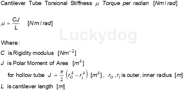

Hi Bill, turns out that structures, including cart bodies, headshells, tonearms, often aren't rigid dynamically, despite appearing so statically.Back on damping, I was looking at the longhorn mod people do and thinking there must be a better way. Then I was reminded of this Mass Damper . Now that is only one dimension, but you could do 2 perpendicular to each other. The masses involved for a cart are very small, but an interesting idea and less mess than a silicone trough.
I once did some work using 250,000 fps video, in a lab used to test jet turbines in simulated birdstrikes. I saw video footage of a gelatine pellet of a few kg, to simulate a bird, fired at a jet turbine running at full speed. A single blade from this turbine was a few feet long and so heavy and solid as to be considered statically dead rigid. When the gellatin pellet hit the blade, the pellet stayed intact, and the blade bent near double before vibrating and returning to shape. Amazing demo of what is completely counterintuitive when it comes to our concept of rigidity and flexibility in the context of dynamics.
Longhorn mods, if they are effective at all, presumably alter torsional mechanical impedance for cart body/stylus housing/headshell, and so alter dynamic torsional rigidity. If cart body/headshell/arm etc are things we consider to be rigid really might not be dynamically, I suppose anything is possible. An art that is perhaps as black as black can be...........
Attached an equation for torsion spring constant of a long hollow tube, fixed at one end, such as an armtube or cantilever, for interest.

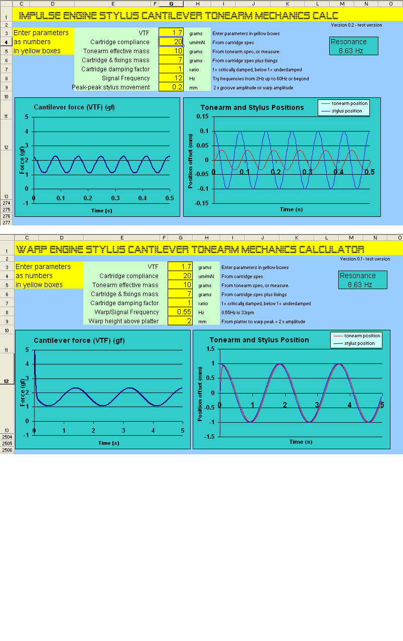

I found in my PC ("arms" folder) two spreadsheets, one named impulseengine00.xls the other warpengine00.xls
Are these your creation?
George

Hi George, they seem perhaps naïve now, like exploratory stuff I feel. It's good to think about stability and such things in this way, but maybe as a stepping stone. I think there were later, and better, versions, but the basics are prob correct..... (?!)
Thank you Lucky.
I can’t remember when had I downloaded those. It’s a subject worth revisiting

Yes, it's easy to think of VTF as being 'constant', whereas in reality it varies greatly whilst tracking warp, platter/spindle vertical run-out, etc. A lot of the trackability budget can be consumed simply by keeping the headshell following the record surface in practice.
This confirms something about surface noise, especially crackle-pop, which generally does not vary on a once per revolution basis. Whereas VTF does vary, even for normal records with typical amounts of warp/run out. I think this tells us in a very evident way that this type of noise does not typically vary with VTF.
Another aspect, from looking at headshell displacement response in the time domain, is just how long it takes for a headshell to settle after encountering an external event such as stylus jumping dirt/noise, or a stiction tug on the cantilever perhaps. Looking in the frequency domain, as is so common, doesn't make it obvious that what is really important is the settle time. The role of damping then becomes clear, and its easy to see how this aspect is important, but very neglected, when matching carts and arms. And how some forms of surface noise might unavoidably evoke unwanted displacement of the headshell, which its desirable to settle quickly.
