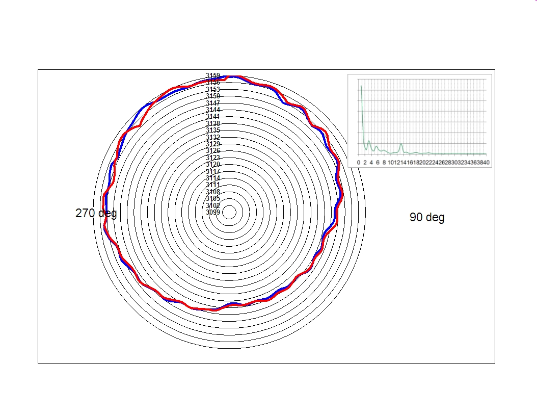

A few years back I wrote a piece of software to help me analyse pitch stability. It analyses a 3.150kHz or so test tone, and is a polar plot of exact frequency versus location on the platter. So once round the chart is once round the platter. Here's a typical example, which I think shows the issue nicely.
Each radial line marks the frequency deviation corresponding to the threshold of pitch audibility, and is calibrated in exact frequency of the test tone in Hz. Red and blue traces are successive platter rotations.
After eccentricity, warp and arm stability, very seldom does motor stability feature IME.
One can see that eccentricity really is the elephant in the room, but also that arm stability and warp contribute significantly. To address pitch stability, which is essentially FM noise, these are the things to address. But, for some reason, it's seldom discussed or even noticed in videos like the one you mention !

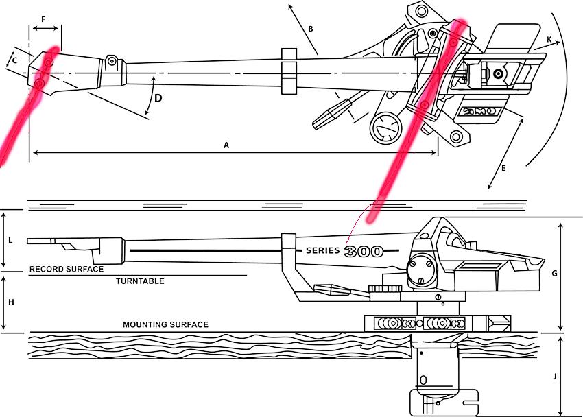

Then there's the correct skew of the vertical pivot
Can you please explain this Ricardo? I can’t understand it.
In the pic, the vertical pivots of the Series 300 are parallel to the front of the cartridge.
If the cartridge moves up/down, it will still be vertical as seen from its front.
On the M2 (and early 3009 up to Series 2 improved), the pivots are at right angles to the tube. As the cartridge moves up/down, it will twist so the it is no longer vertical.

🙂 I wrote it for myself, and it's a set of linked VB modules that I run manually. The FM demodulator is particularly fine, if I might say so. But it's only usable by me in current form, though I had it in mind a few years back to do a user interface and make it available as an app.
Meantime, I don't mind running a few plots for people now and then on forums just for fun. Needs a 10s or so recording of a 3kHz or so test tone, in any lossless format.
