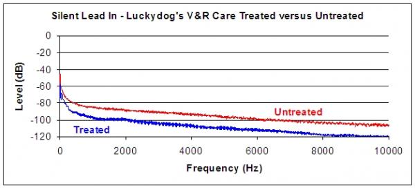

A time ago, I also tested home brew vinyl treatments that might 'permanently' reduce surface friction. Here's a plot that shows profound noise floor improvement from a 'silent' lead in groove.
Don't know 0dB reference level, so ignore absolute levels. But the relative improvement was profound, c 12 - 15dB after treatment over most of the audioband. Don't know the record, but looks typical IME.
IIRC, this treatment sufferered clogging, which was the snag with all the home brews I found.
Anyways, here's the plot:
LD

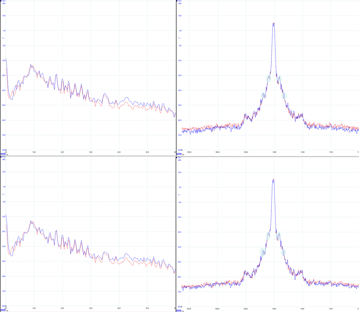

Initially my intention was to start a new thread since noise dependency on playing Dry/Wet around 10Hz and the effect of it in IM distortion around a reference tone is not exactly the theme of this thread.
I expected at least some difference in the 10Hz region when playing wet, but I didn't. So starting a new thread made no real sense.
I did the following:
On a track with a 0 dB 1Khz test tone that was never played wet, I first made 5 recordings Dry and after that 5 recordings Wet. Each recording being sampled with 200Khz to avoid folding back of high frequency artefacts in the regions of interest, giving me spectra with 100Khz Bandwidth.
Filter Bandwidth was 0.37Hz.
Noise of the recording chain was 12dB or more below the recorded noise from the LP.
Because of the narrow filter bandwidth, I could only average 11 spectra, given the limited time length of the reference tone.
Since all spectra are almost copies of each other, I have displayed the spectra from 0-60Hz and from 850Hz to 1150Hz only for 2 Dry and for 2 Wet recordings.
The blue ovals correspond to 1Khz +/-9.5Hz and +/- 18Hz, where 9,5Hz is the resonance frequency of the Cart/Arm combination.
Two Dry Recordings
Two Wet Recordings
As you can see, Dry or Wet makes no difference at all. Not in the rumble region but also not in the IM product around the reference tone.
Clearly visible are the IM products around the reference tone in blue.
Also visible are +/-50Hz IM products some -75dB below the reference tone, quite harmless to my opinion, but nevertheless well reproducible.
The first IM components at +/-9.5Hz lies -45dB below the reference tone.
In Poul Ladegaard's often cited article, IM products are resp. -25dB and -35dB below reference for an undamped 9.5Hz and a 16Hz damped Arm/Cart resonance frequency, leading him to conclude that the higher res. frequency is better.
This again shows how careful one has to be when coming to conclusions, because with different equipment everything may look totally different.
I can only repeat what I have said before: the only thing that I have proved is that with my equipment and with my test record, playing Dry or Wet makes no difference at all.
Despite others who found (completely) different results, as well with noise reduction when playing Wet (Figure in posting #51) and also with the level of IM products related to the resonance frequency (B&K article from 1977), be careful not to jump to conclusions.
The LP world is obviously not that simple and dependant on many interrelated factors.
Hans
Thank you, Hans. However, it's now clear from the LF signature that, for whatever reason, you were not successful in altering friction. Your result, ie lack of difference, follows on from that, as expected IMO.
Had you measured friction coefficient directly, I believe we could have been certain. But the LF signature being identical between wet and dry is strong evidence that friction coefficient was unaltered, for whatever reason. I have never known friction remain unaltered between wet and dry playback, I should say.
I think I would deduce that, however unlikely, you were somehow unsuccessful in wetting the record, Hans. Or that recordings somehow got muddled. Otherwise, it would take a remarkable coincidence for friction to remain exactly unaltered.
Whatever, the LF signature suggests friction coefficient was unaltered, and so was surface noise. Which is as would be predicted, and does not contradict the correlation.
The curious matter is why friction coefficient should remain unaltered; that demands exploration and examination I feel.
...be careful not to jump to conclusions.
Likewise. Especially when results are unexpected, unexplained, and lacking direct measurement of the test variable: friction coefficient in this case !
That much we can agree !
LD
