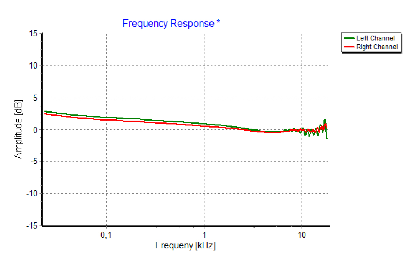

I'm sorry we all can't agree here. I have one comment, Hans, a log frequency plot that starts at 10Hz is not very good for showing the low frequency resonance at 10Hz. The FFT is inherently linear so the resolution varies widely across a log plot. George and I have posted some plots with very long FFT's that make the low frequency behavior much clearer.

I accept your comment that my plots are not meant to be used for detailed analysis around 10Hz, although the FFT starts at 1.5Hz with a resolution of 1.5Hz. I could have also displayed a linear plot from 1.5Hz to 30Hz, and as a matter of fact I can simply redo this if you like.
But showing just the results around 10Hz was never the intention. Please keep in mind that the discussion started with LD's posting #29 showing a spectrum from 100 - 2500 Hz with great differences in noise between dry and wet.
My comment on that was that I had the same sort of noise dry as he recorded wet.
My recordings to compare were showing the results for a much wider spectrum going from 10Hz to 10kHz, without any significant differences between dry and wet.
And in between I showed a linear plot from 1Hz to 35Hz in posting #59.
That may be the kind of plot that you refer to. This was a frequency response plot, not a noise plot.

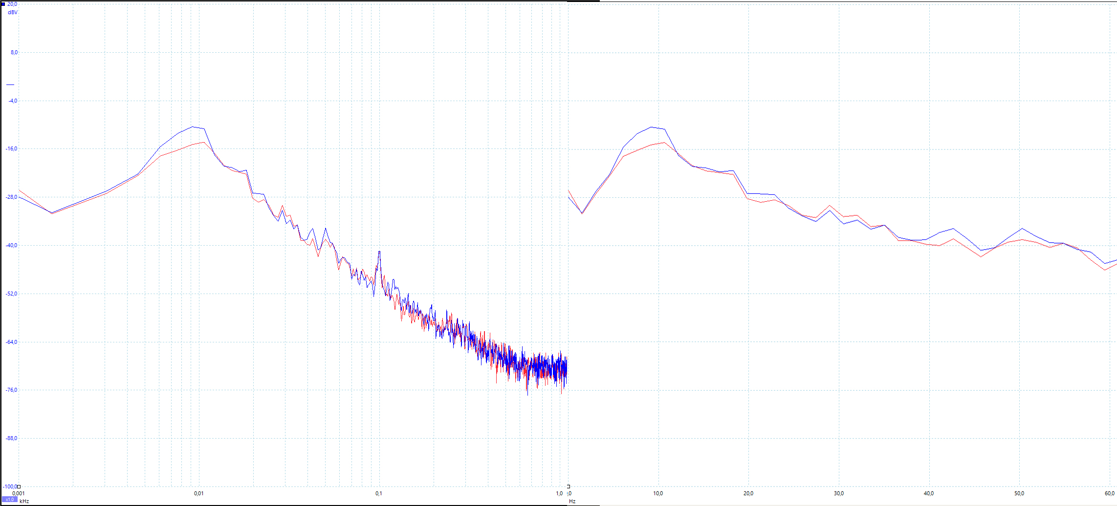

Scott, you raised the issue of looking at around 10Hz.
Of all the recordings dry/wet that I made, I happened to have saved just one original recording, being the one played wet on the outer track, the graph at the upper corner right in posting #122.
This recording could therefore be newly drawn in a logarithmic way, starting at 0Hz and also in a linear way.
Both are attached below, the logarithmic going to 1Khz an the linear one to 60Hz.
Was this what you meant, and which of the two do you prefer in that case.
I could make a new set of recordings displayed in this way.
Hans
P.S. And just a question, isn't the superimposed AM from the resonance frequency resulting in IM distortion ?

As long as the LF is resolved either would suffice, another 4X or so would fully resolve the peak. It's not just IM that I'm talking about since the system is not rigid both amplitude and phase would intermodulate in the worst case.
An interesting math exercise might be to correlate the LF activity to the sidebands on a 3k or 1k reference tone. I have a lot of raw files around but none wet played.
BTW I gave Jan some in-amps for you, I though you might try a G = 100 head amp some time to compare noise/sound.

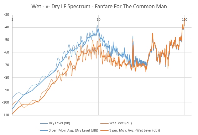

A few years back I collected together what few 3rd party recordings of wet versus dry play there are to be found on the web. So I have a few, plus my own of course.
I just picked one at random from my 3rd party wet-v-dry collection; it's a recording of the opening of Fanfare For The Common Man, nice bit of Copland. Reduction in surface noise is obvious to the common man (!) by listening.
A few minutes ago I ran LF analysis on the wet -v - dry recordings of that 3rd party Fanfare for the Common Man, starting at exactly the same location.
The LF spectrum plot is attached below. There's about a c 12dB reduction in amplitude of the cart-arm resonant response in favour of wet playback. This is thoroughly typical IME, and reconfirms my own results and those of 3rd parties. There can be no doubt of this phenomenum.
I believe it is explained by reduced stimulus for headshell movement in the case of lower friction from wet playback. Variation in friction = variation in skate force = stimulus for headshell motion.
Surface noise aside, the audible improvement from improved headshell stability comes from improved pitch stability, ie reduced FM vibrato. The 10Hz resonance physically moves the headshell, so stylus very slightly speeds up and slows down which results in FM.
Though there is huge c 10Hz baseband signal transponded by the cartridge, this does not amplitude modulate signal - rather it is simply superposed. So one does not see artifacts of AM modulation - rather those of FM.
I believe this is how adjust+ looks at pitch stability, BTW, by FM demodulating a tone of a few kHz. What not many people know is that headshell movement due to cart-arm resonance is THE single biggest contributor to pitch instability after eccentricity/warp IME.
I wrote my own FM demodulator to look at pitch stability using a similar method a few years back, just for my own use and fun.
What Hans should have seen in his LF spectrum was a significant difference in resonant amplitude between wet and dry playback. Though his analysis doesn't permit proper examination of this phenemenum, what there is does not suggest he was successful in reducing friction between wet and dry cases, for whatever reason.
Here's the Fanfare For The Common Man wet-v-dry spectra in good resolution. If anyone wants a link to the raw audio files, PM me. They were recorded by a 3rd party, and are clearly audibly different as to noise.
