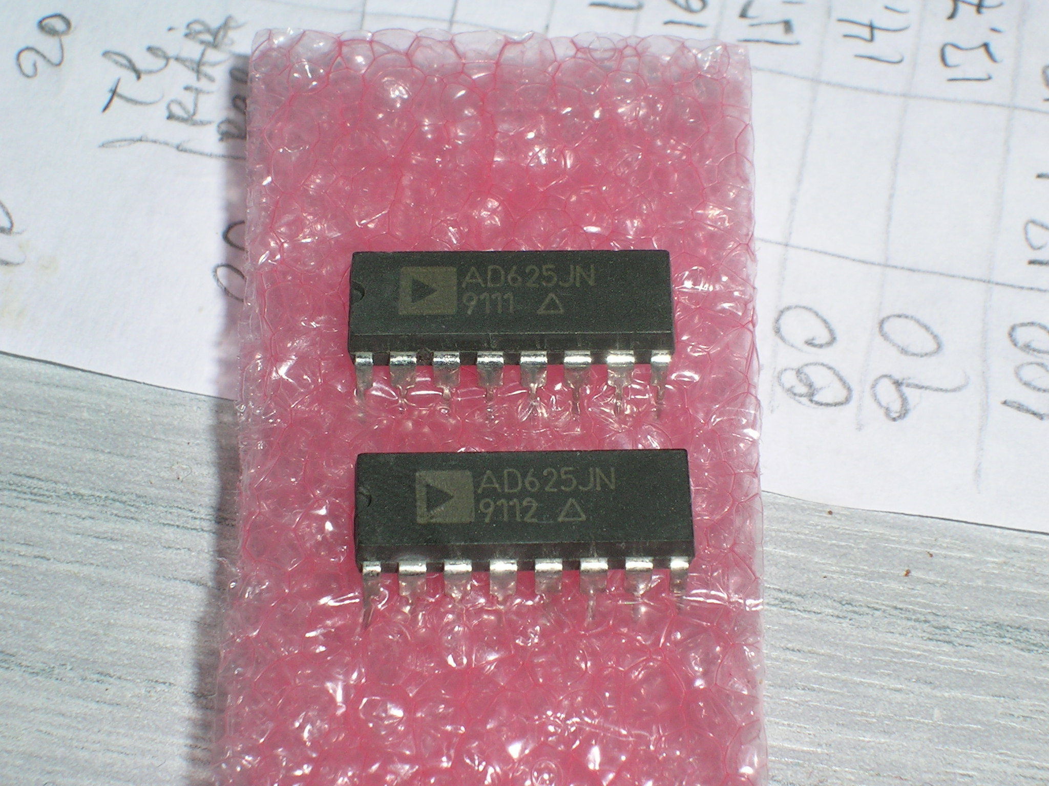

I went shopping today for two affordable AD 620, 621 or 622 for building another flat head pre for the DL-103 digitising exercise.
I only found the better (but 13Euro each) AD625. I turned around my pockets and got them.

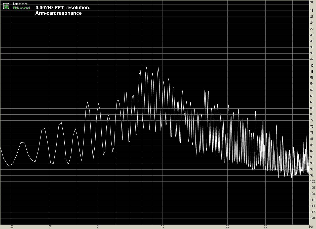

Though there is huge c 10Hz baseband signal transponded by the cartridge, this does not amplitude modulate signal - rather it is simply superposed. So one does not see artifacts of AM modulation - rather those of FM.
What about modulation of the VTA/SRA?
The LF spectrum plot is attached below. There's about a c 12dB reduction in amplitude of the cart-arm resonant response in favour of wet playback. This is thoroughly typical IME, and reconfirms my own results and those of 3rd parties. There can be no doubt of this phenomenum.

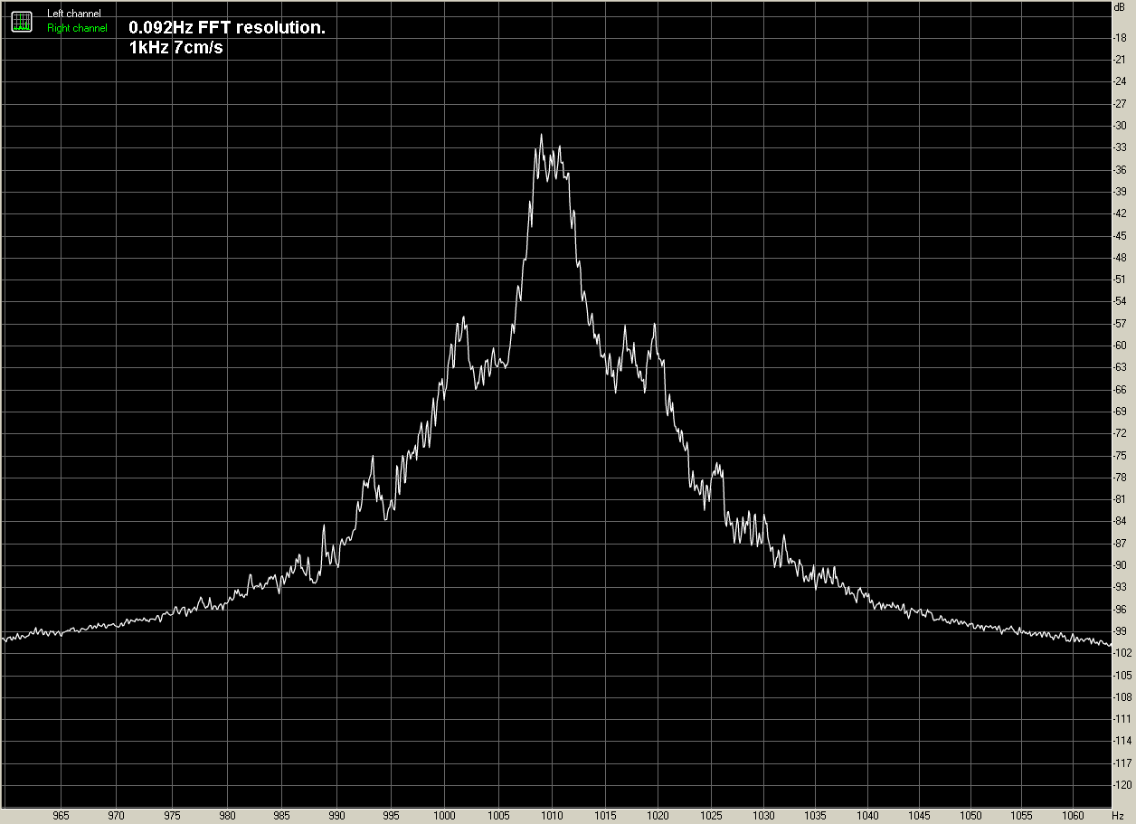

Great, Hans. This time please measure and publish the friction coefficient, also please make available raw audio files in a lossless format captured at high sample rate.

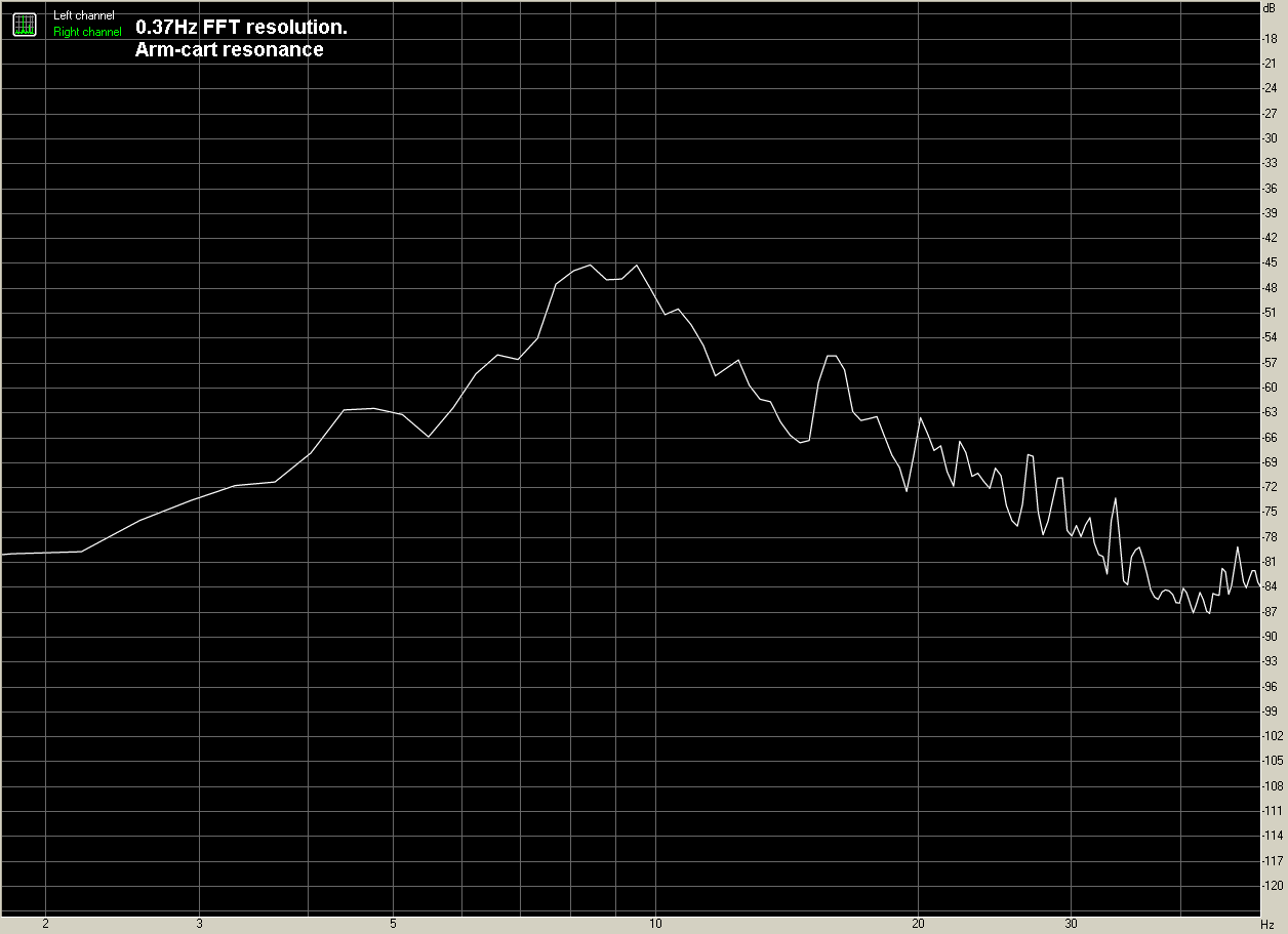

It's not necessary, but harmless, to analyse extended recorded periods. I'm sure you know how to improve resolution when looking at LF bandwidth in FFT, just as I do. You should shoot for about 0.15Hz resolution when looking at the cart-arm resonance. I'm also sure we are each well capable of getting this stuff right and working out where any true differences in results might be.
I see no need for a separate thread, unless you are interested in looking at the LF FM effects of dynamic friction on headshell stability, in which case deal me in, Hans?
That friction coefficient correlates with crackle-pop noise floor is the direct issue. Strictly, you need to demonstrate you are reducing friction, either directly by measuring coefficient, or by the signature of the LF spectrum.

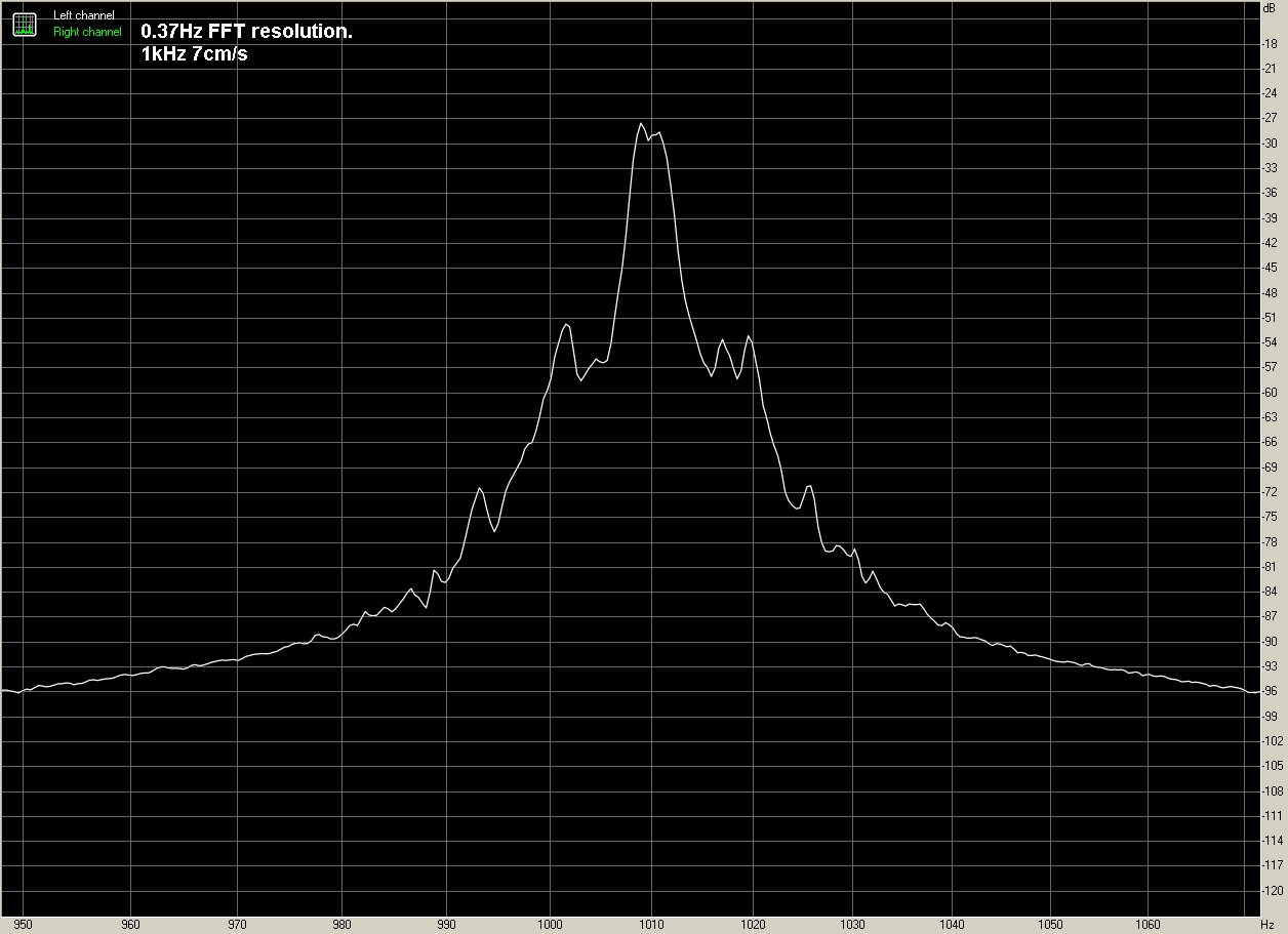

And the noise distribution does contain the LF data, therefore, Hans no need to open another thread.
0.37 Hz FFT resolution isn’t enough to show in full glory what Scott is interested in.

Yes, whatever method used to stabilise headshell motion has the same effect. Damping controls Q of arm resonance, whereas avoiding stimulus controls amplitude. They can work together too. Reduced friction, eg wet playback, doesn't affect Q (damping) according to lf spectrum measurement, but it does reduce amplitude. Presumption is reduced stimulus.
There isn't notable mechanical damping in wet playback, perhaps that's counter-intuitive but I think it's evident. Q of the mechanical resonance doesn't change, see the shape of the plots I posted a few posts ago! It's all about stimulus, amplitude is reduced.
LF spectrum doesn't affect audioband noise floor per se. It's just a marker for friction, which does affect it!

I got the same ~70dB off of some DMM disks via my own measurements. I like your 4th plot the sidebands are all harmonic not noise.
Yes you can nicely see FM sidebands associated with c 10Hz cart-arm resonance. Bruel & Kjaer, who made spectrum analysers back in the day, published an article based on it.
All causes of pitch instability show up as FM sidebands. Just listen to a vinyl 3kHz test tone, versus a 3kHz tone played on a CD..........!
Roughly, in order of contribution, it goes eccentricity, warp, cart-arm resonance, motor cogging, tonearm resonance IME. With enough resolution each shows up as distinct sideband pairs because each is repetitive at its own frequency.
It's FM 'noise', only audible because it modulates programme material. Still strictly noise though, but not as we think of noise in the classic sense perhaps.

Bill, this is what I purchased. I hope they are genuine
George
You'll know soon enough. 😉 If they're fake it will have to be a different die and it simply won't work. The chance of fakes on this one are very low. The 620 OTOH has known fakes out there that have been returned by customers for FA.

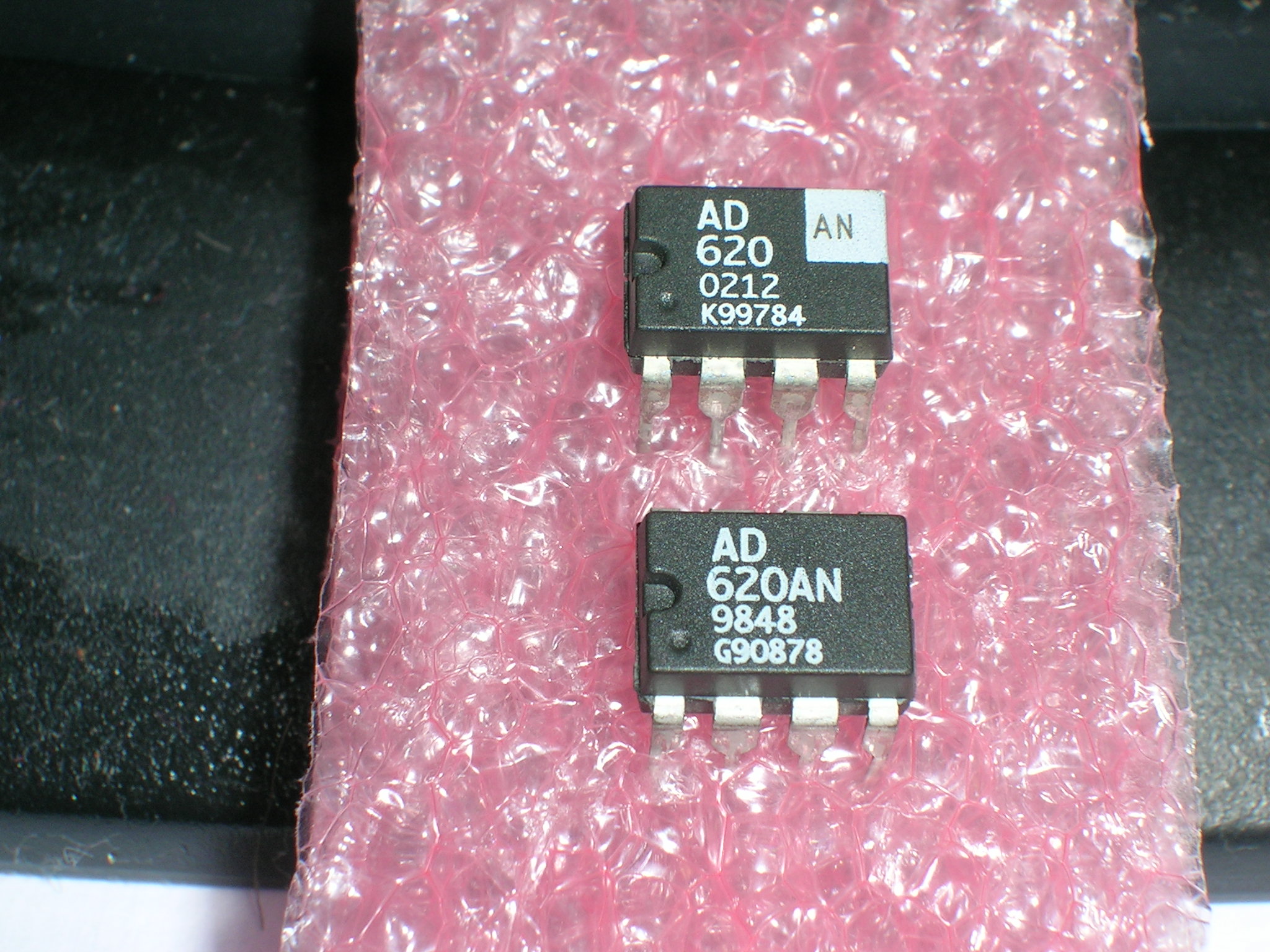

Speaking of which.
Searching in my parts bins I found these two (together with two metal canned LM394).
If I dig a bit more I may hit gold
