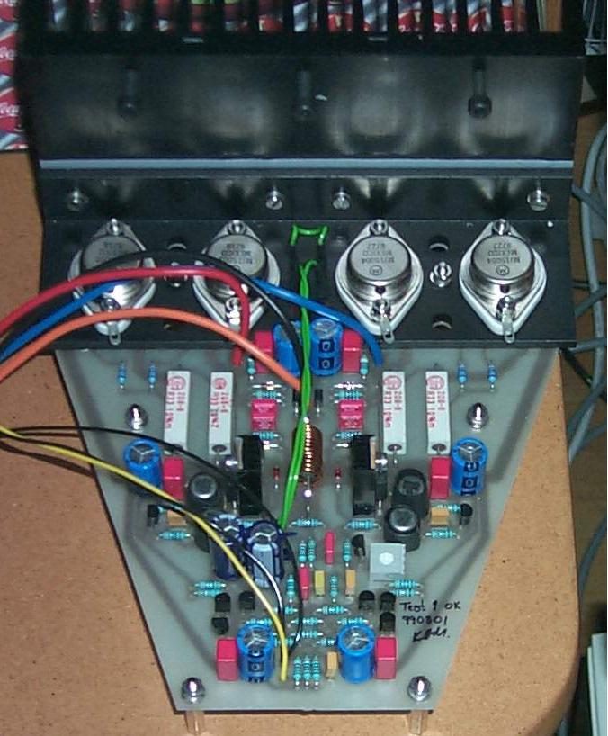

After reading through the thread TO-3 v.s. TO-264 again, this solution found in links on the Leach site seems to work just fine. Transistors on the circuit board, very short wiring, etc.
But this an old idea and still gotta drill 4 holes for each transistor tho.

I think this is probably on-topic enough to ask here...
Would anyone find it useful to have a TO-3 drill guide jig? I was thinking of making some. Probably plastic or aluminum with hardened drill guides for the four holes (proper size) and two drill bits. The idea would be to just clamp and drill, no need for a drill press. Sound useful? Is there one out there?
-b
-b
I'd take one...
Needs to be tight, it has to be useful in channeled heatsinks, typically clearance is on the order of 1/2", each side...
If you get the pattern right it would save me a lot of cursing, I don't even mind using a single drill bit, just having pilots in the correct spot would be great...
Stuart
Stuart
Oh, me, me, me, I want one.
Now that is a marvelous idea. My old metal template for center punching before drilling the holes on the press is wearing out and I could use a new cool tool.
Prosit
Prosit
Making it only slightly larger than the TO3 would be pretty easy. The jig would really just be a holder of the guides, so there wouldn't be any torque or other forces put on it (or there shouldn't be anyway).
Perhaps the drill bits could be a two-step design like those using in pocket screw jigs. First stange would provide a pilot hole only, second stage is full size. This would allow custom hole sizing for tapping etc.
I also think there would be two layouts: straight, where the screw holes are on the center-line of the jig, and offset, where the pin holes are on the center-line (perhaps there would four pin holes so the offset version would also have the pin hole perpendicular to the centerline).

I was really looking for: "Oh, you can get that at DigiKey and everyone has one."
It sounds like that is not the case. So I will make one and see if it works, then offer them up to the wider audience.
thanks-
b
PS: Part of it is convincing a partner to do it.
thanks-
b
