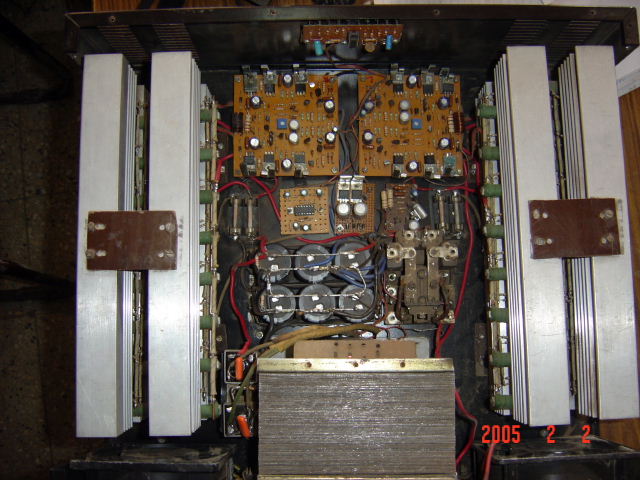

acenovelty
Yes they are Leach boards but my layout to accomadate the availible
components.Here in India we do not have easy acess to the required
components and have to make do with whatever is availible regarding
this I had posted the following long back http://www.diyaudio.com/forums/showthread.php?s=&threadid=34735&perpage=10&pagenumber=5:

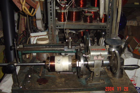

I made it myself in fact I make all my transformers , . I also repair
transformers , loudspeaker coils , audio gear as a profession , I have a
little hand winding machine , I will post the photo of the same .
"I concur that you must be an expert on your own amp."
YES but never had much problems inspite of using it at 2ohms in bridge
mode with a power output above 1200w . I use them in a big dance
parties if you want to see photos I have some of the new year bash we
did on the 31st dec night , send me a PM and I will post the same to you
