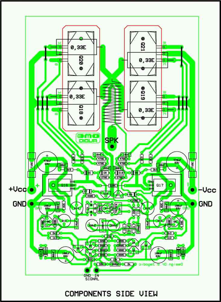

Here is my version of Leach amplifier PCB with two pairs of Sanken's 2SC3858 / 2SA1494. If anyone is interested, I can post components layout too. My version is working on +/-58V and with unconditional stability.

Here is the layout. Sorry, no photos for now. I've done it for another man and I 'll try to ask him to make some pics if he is willing.
Sorry for less than perfect JPG, but forum limit is 100KB and 1000x1000pixels. Higher resolution GIF I can send as an attachment to E-mail if neccessary.
I've done some changes:
*All "small" transistors, (Q1...Q11) are 2N5401/2N5551 and PCB is designed for that pinout (swapped C & E compared to standard BC series transistors).
*Q12.... Q17 are as in original specification.
*Output's are 2SC3858 / 2SA1494. To me, probably best overall choice regarding ruggedness, reliability, power and heat transfer surface.
I've done two Leach amps, both for other people that requested specifically that amp, and in a first one output devices were MJL3281/MJL1302, that also worked marvelously. I developed PCB for stereo version using that case (TO247), and I can post it too if there is any interest.

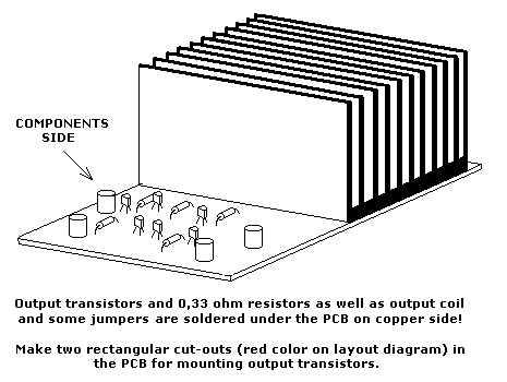

PCB-Heatsink-output transistors assembly might not be entirely clear and obvious for some people, therefore I've done some coarse drawing in attempt to clarify that.
