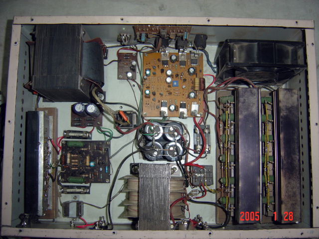

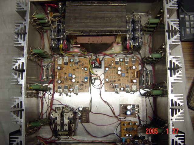

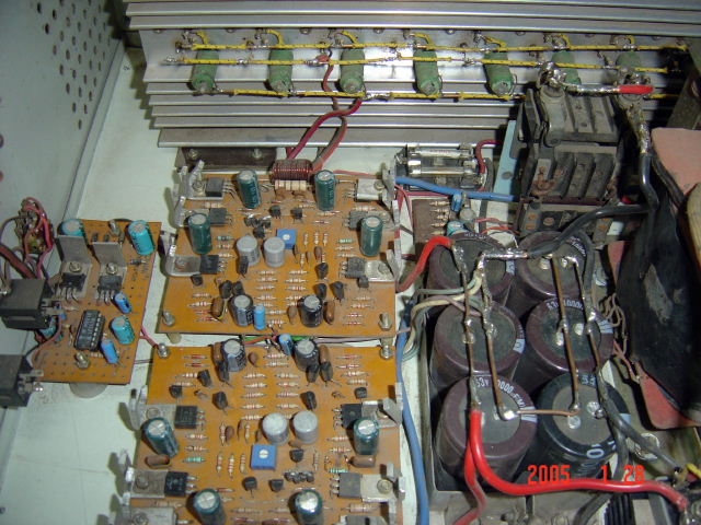

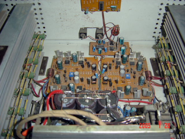

acenovelty writes
"LBHajdu/rajeev luthra,
Perhaps you have photos of your amplifier, working boards, or
schematics or board layouts to back up your claims? Lots of talk,
gentlemen. Show us your work."
I have made a few high power amps which I have been using sucessfully
in my PA system since last three years, but all were with TO-3 devices ,
photos of insides attached .
I am making another amp now with 2SC-5200 / 2SA-1943 pairs in the
output and am posting the progress of my work on this thread as since
begining of my consept of this I have posted there .
http://www.diyaudio.com/forums/showthread.php?s=&postid=563129#p
ost563129
Then I discovered that Jens has also gone for 10pairs in the output ,
Jens worked on this design since a long time and has done the BEST
job possible , his pcbs are even better than many in pro amps , hence I
keep asking Jens regarding any queries that I have in my mind . My
project is a simple DIY job I will make everything myself -ie layout on
graphpaper , hand painted pcbs , chasis , etc etc. The same has also
been done in the other amps photos of which I have posted here .
If you can give any suggestions they are welcome .
acenovelty do you want any other proof ???

rajeev luthra,
Very nice. 300 Watts/channel? Are those really Leach boards? My eyesight is not what it used to be, but something seems to be different. Some added flat pack transistors on the board? Where did you find that big honkin transformer? I concur that you must be an expert on your own amp.
Brings back memories of my first Heathkit amp. Wonderful days.
