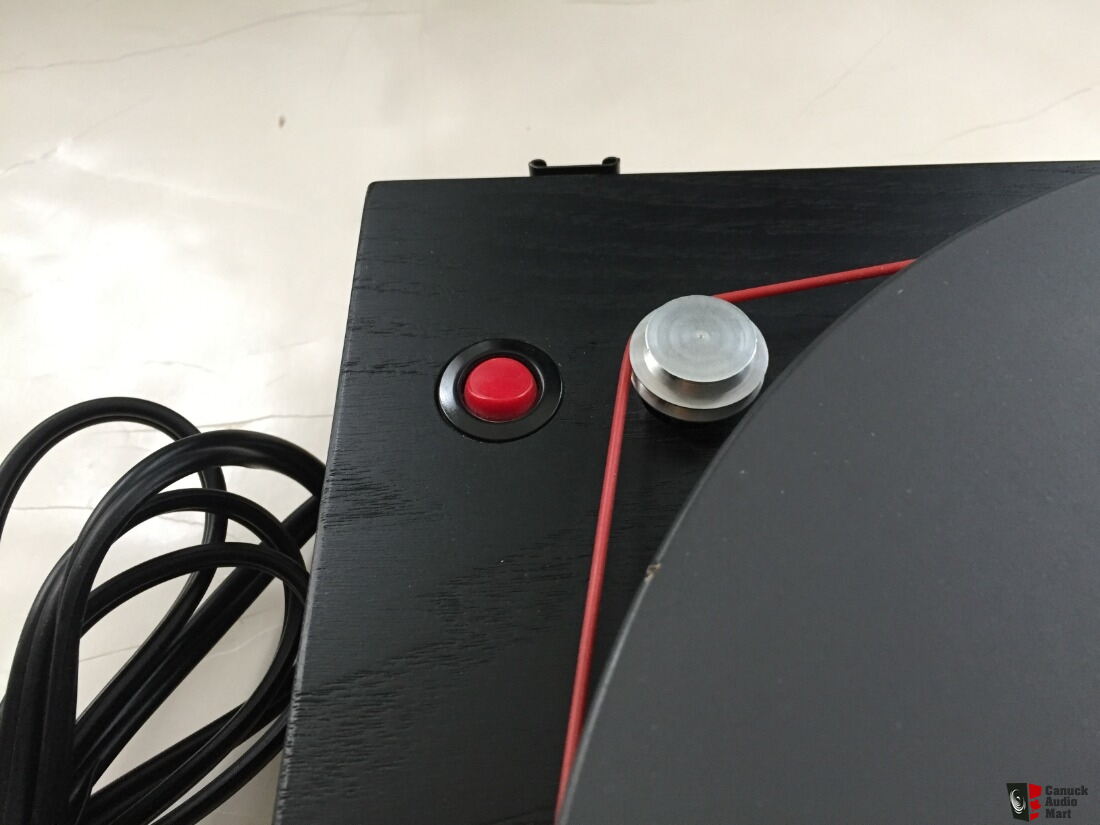

what difference is between red and black belt (same size - go to the attached images) ?
Best thanks for an information

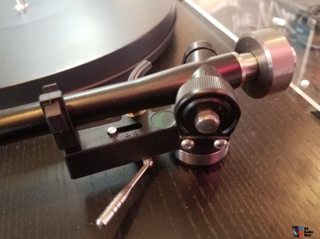

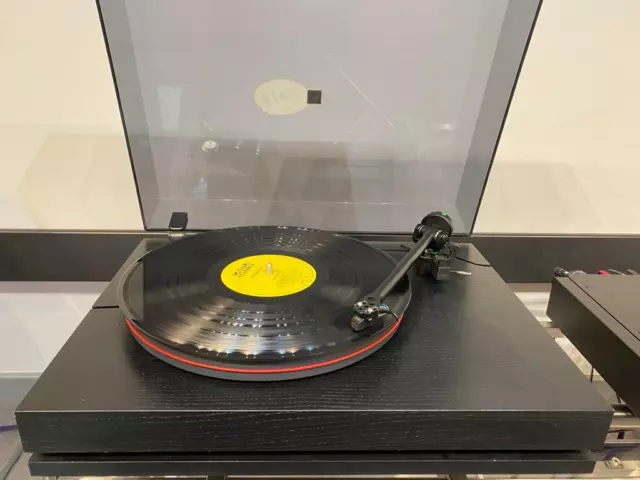

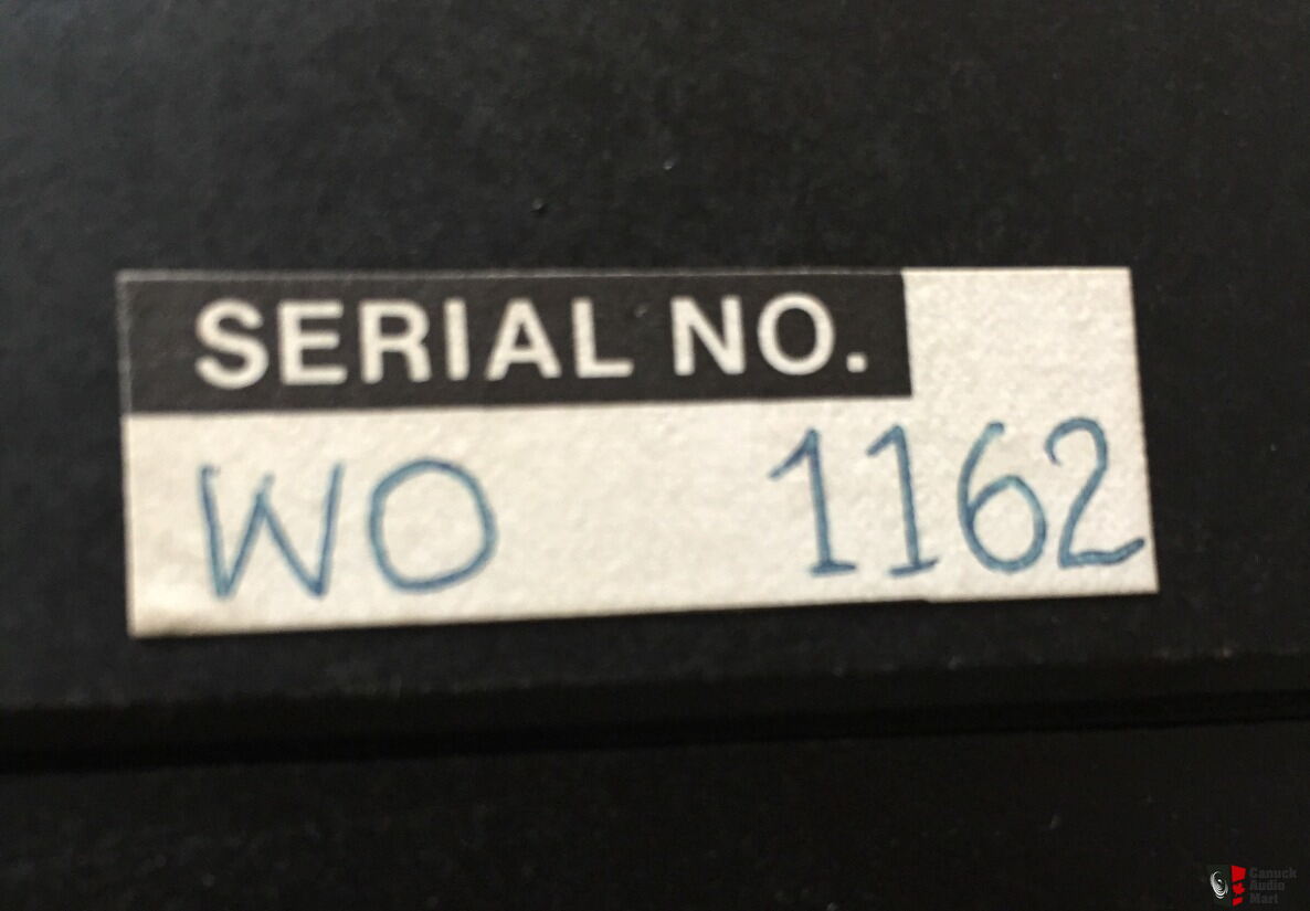

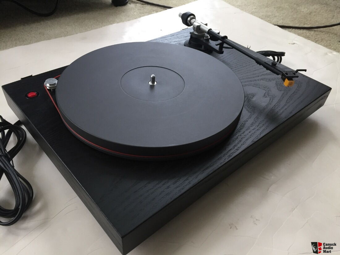

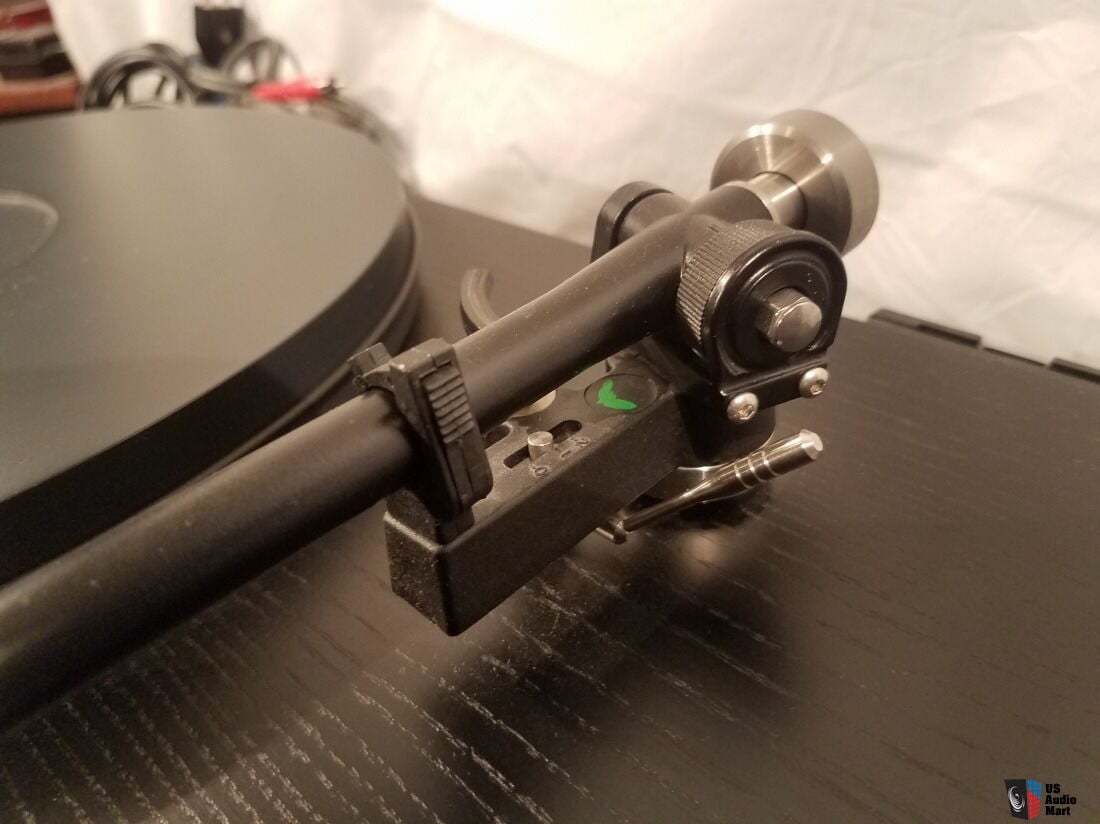

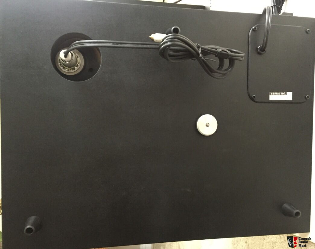

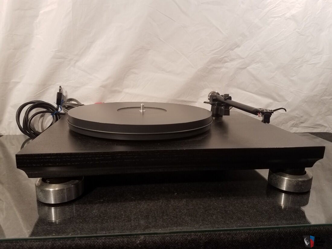

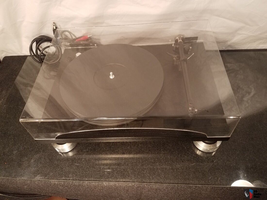

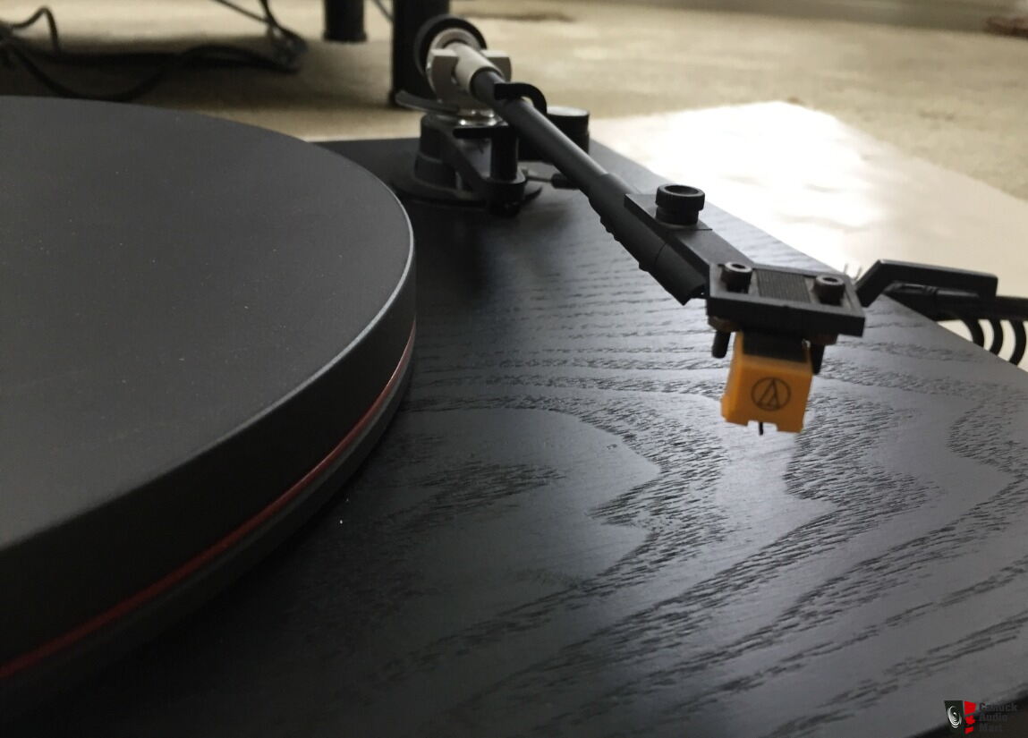

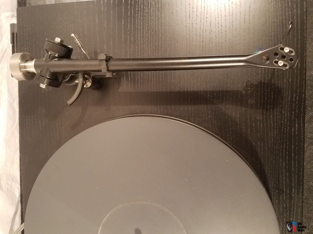

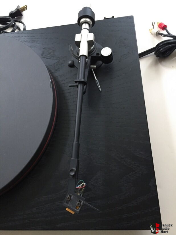

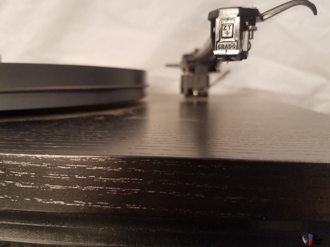

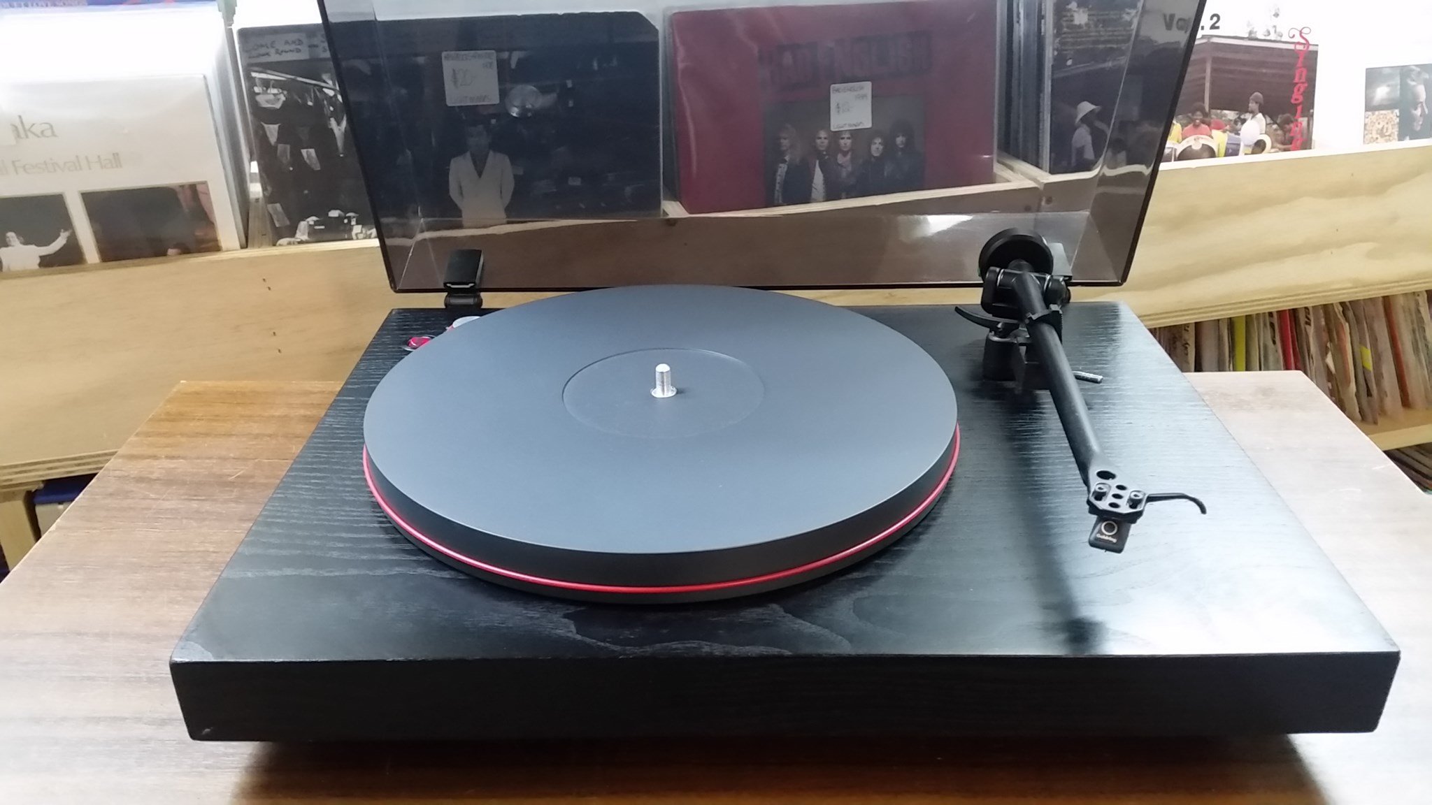

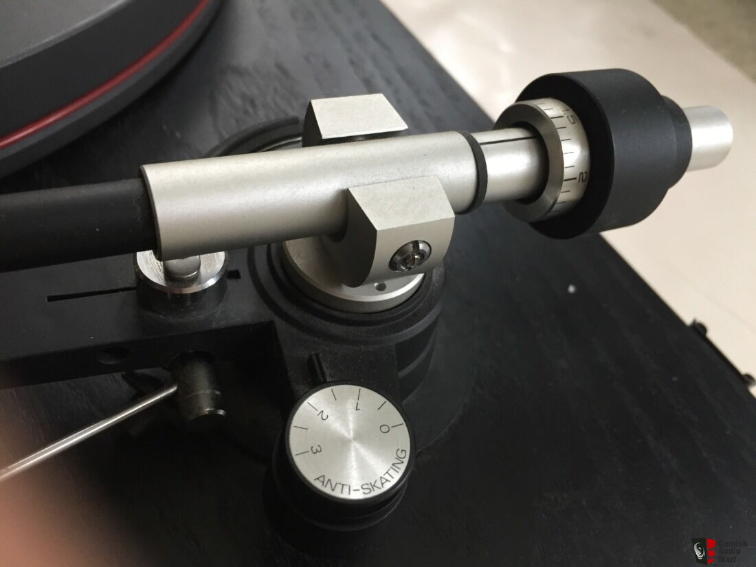

Are there a difference between the turntables "MOTH SUPER OAK", "OAK Audio" and Moth OAK ?
According the attached images - found under canuckaudiomart (first both) and facebook (third image) and closed ebay auction (last image) this turntables are identical models, but I am not absolutely sure.
