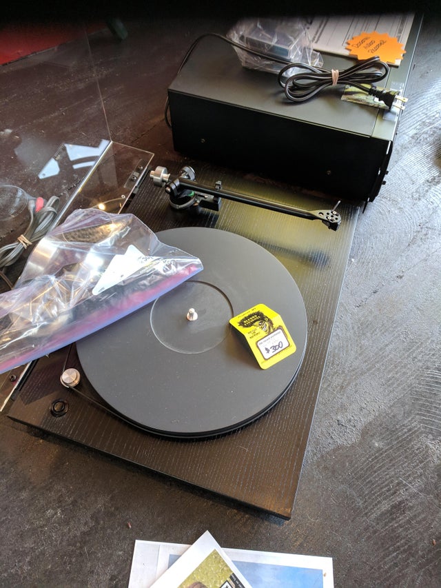

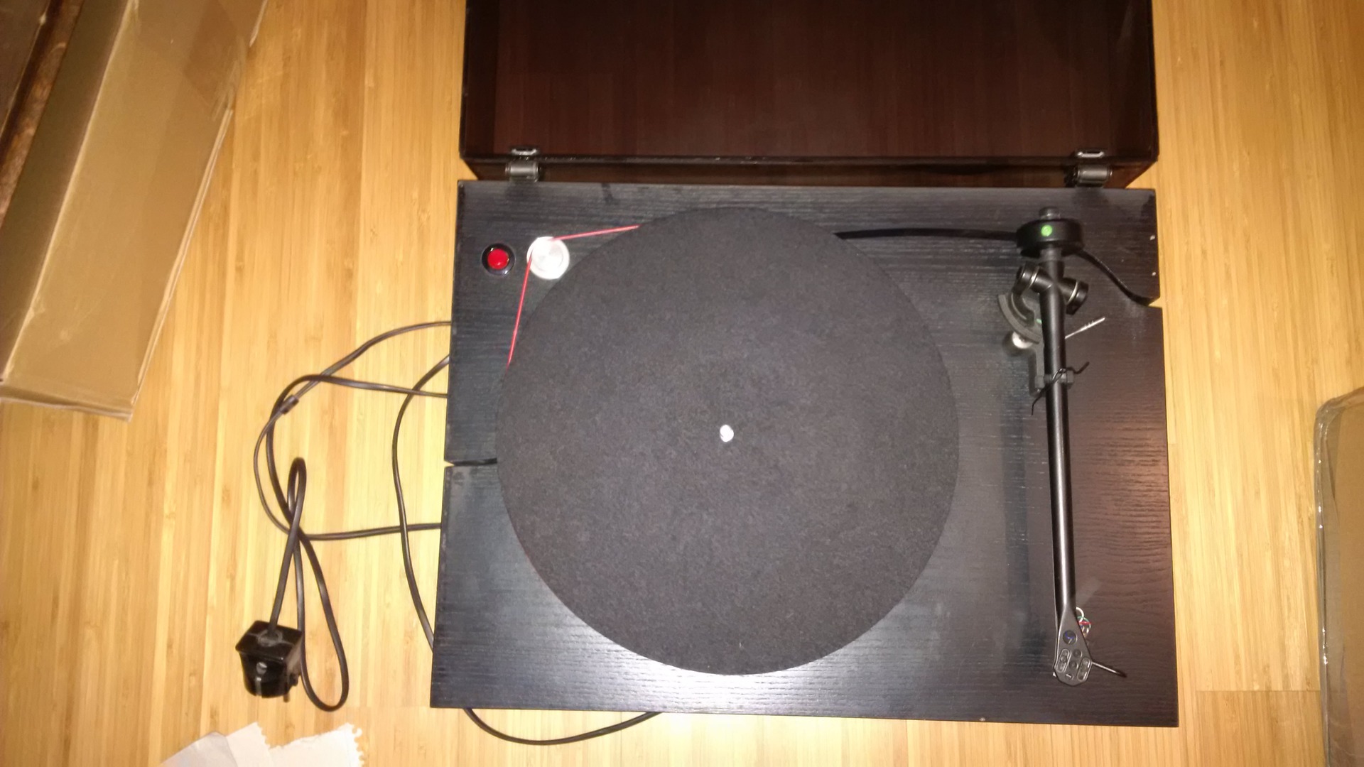

The record player "Alamo" from Moth is a good known record player (nearly identical to Rega Planar and NAD's 533.

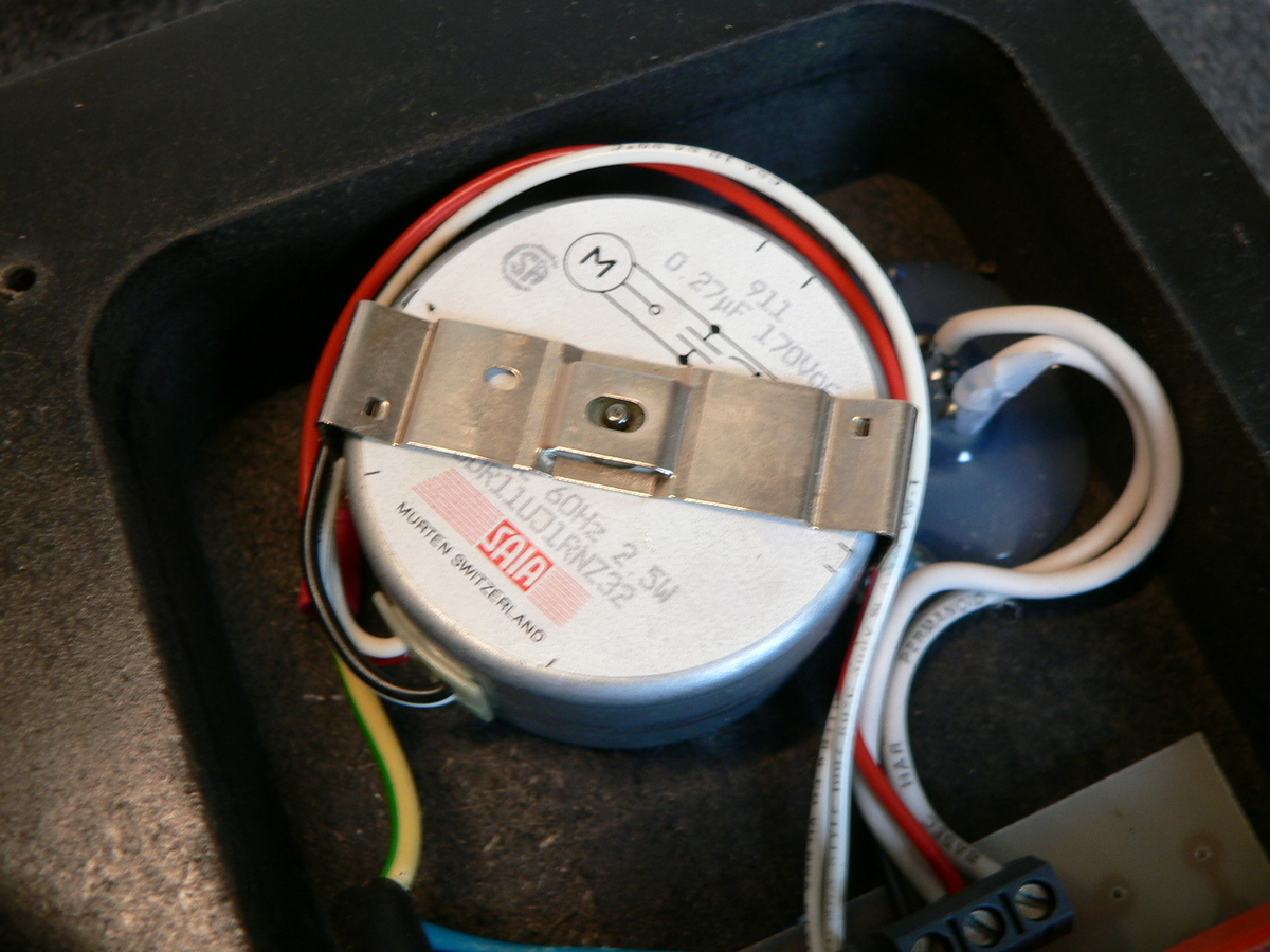

But I have an other model from Moth. Typ: "Kanoot" Unfortunately there isn't similar type from other companies.
The actually device in correct working condition has on problem: the motor pulley's sizes (for belt) is made for the British marked (mains frequency 60 Hz instead 50 Hz).
Therefore in Germany the RPM value isn't right.
Where I get such motor pulley for 50 Hz (to replace the exist 60 Hz version)?
Motor model is follow: SAJA MURTEN UDR11UJ1RNZ32 (SWITZERLAND) - go to second image from post #13, also used in Revolver turntables and some other.
I have now realized another solution to avoid having to laboriously remove the 60Hz pulley and replace it with a 50Hz version.
I remove the capacitors at the motor and introduce this motor control unit (clone from Dr. Fuß) - often incorrectly referred to as a power supply :
Homebrew Motor Control Linn LP12 - Circuit Description wanted for Sine Wave Osc.
To the resistors R28 and R27 I add a 27K resistor in parallel (have a look in the PDF schematic of post #16).
This works perfect together with the 60Hz pulley. The target speed is now (only at 33) a bit right of the middle position of the speed controller knob.

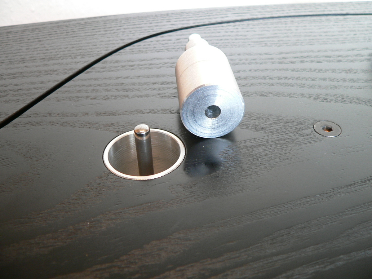

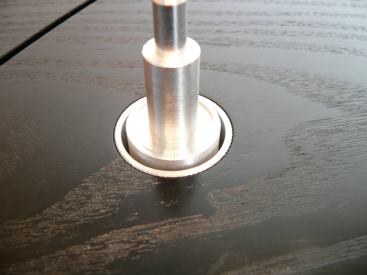

The pulley parameters are dependent of follow:
A. diameters: both from the mains frequency and the outside diameter (belt circulation aera) for the turntable platter
B: groove wide: both from the kind of belt (round/square/flat) and the material diameter
What is a standard UK pulley for you ??
Thank you for your explanation.
If I realize an alternative with DC motor conversion kit I must destroy the presently motor (no screw mounted pulley) and must press this pulley to the new DC motor.
If I get a 50 Hz pulley (the present pulley is definitely for 60Hz - speed control led me note this to slow speed) I would fix resp. clamp and stick on top of the old pulley - the easiest solution.

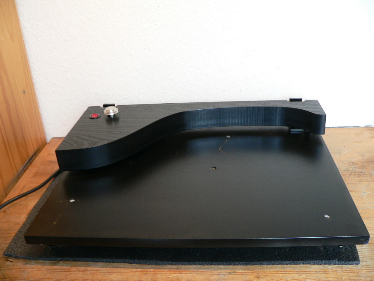

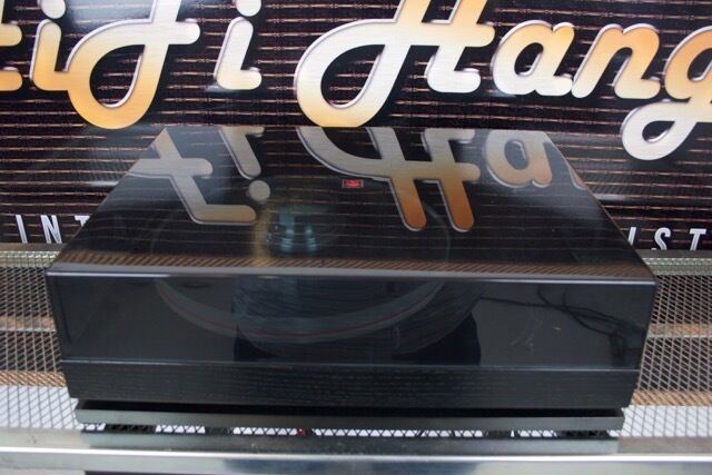

Unknown record player from "Moth Group"
Who knows the model naming of the turntable from the attachment?
This model was above the "ALAMO" and "KANOOTH"

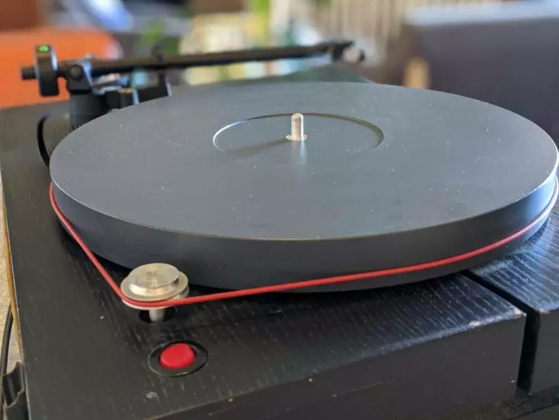

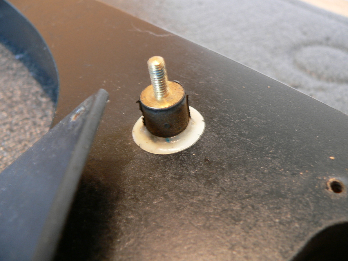

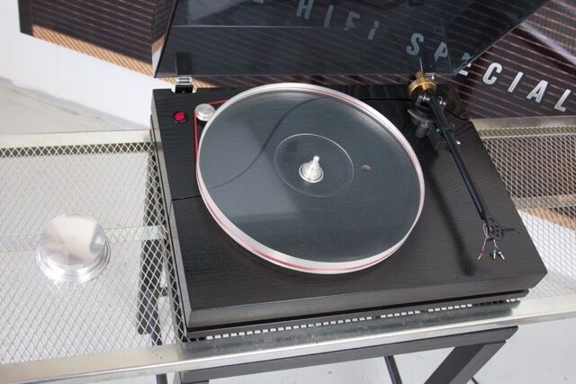

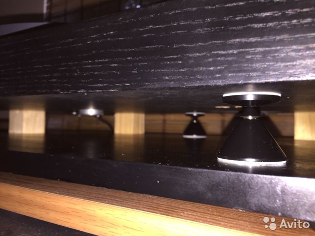

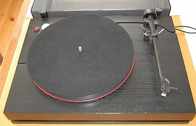

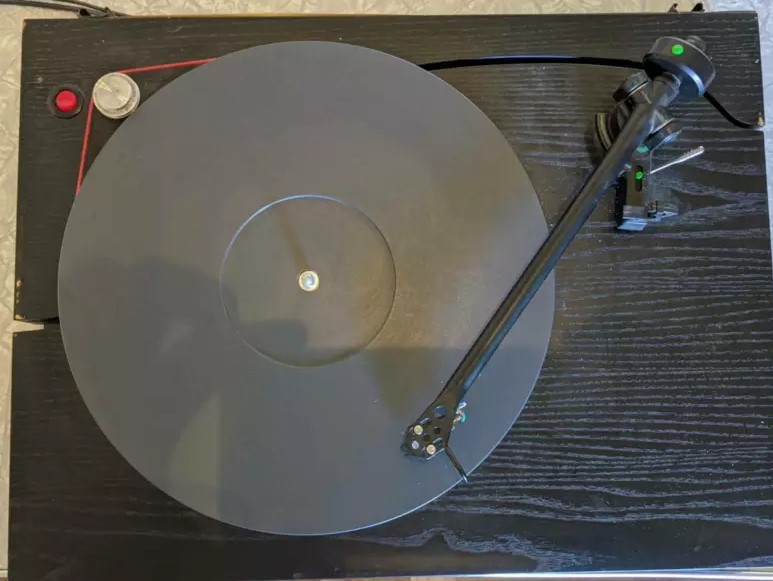

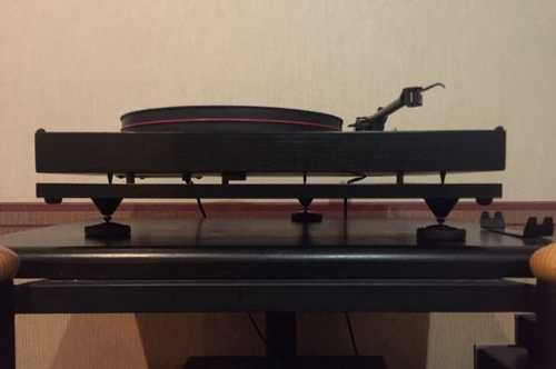

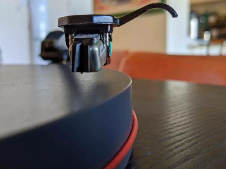

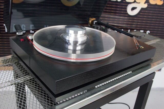

There is the same sizes from the red belt on the model "Super OAK" from Moth. Where is this belt available ?
Some images, that I have found online in the attachment.

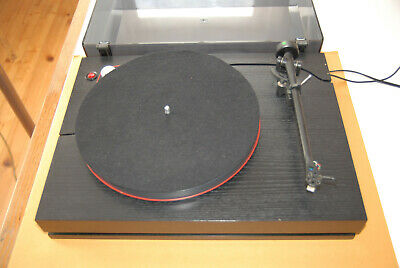

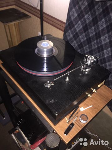

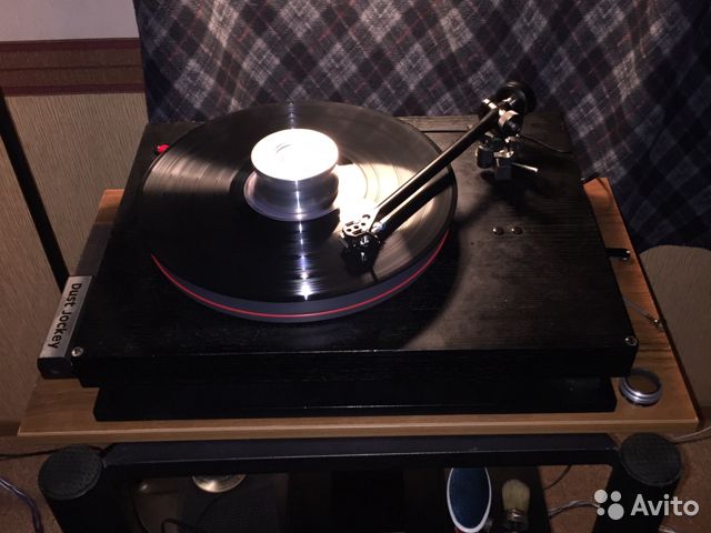

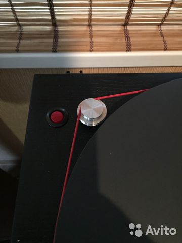

Hello!
This is my first massage here, I believe.
Recently I've bought Moth Super Oak that looks exactly like tt on these pictures. Even redline belt is there. )) Don't know how to attach the pictures.
If you still need it, I can measure diameter/thickness and length/diameter.
I'm looking for spare belt too, although mine one is in good condition.
