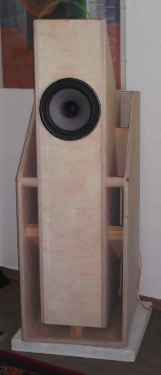

Hello,
it is a superb driver, i made a double horn, no crossover,
measurements and feedback
RDH
hm, that is a "klasse" speaker, great work!! How did you come up with that enclosure & measurements to build it?

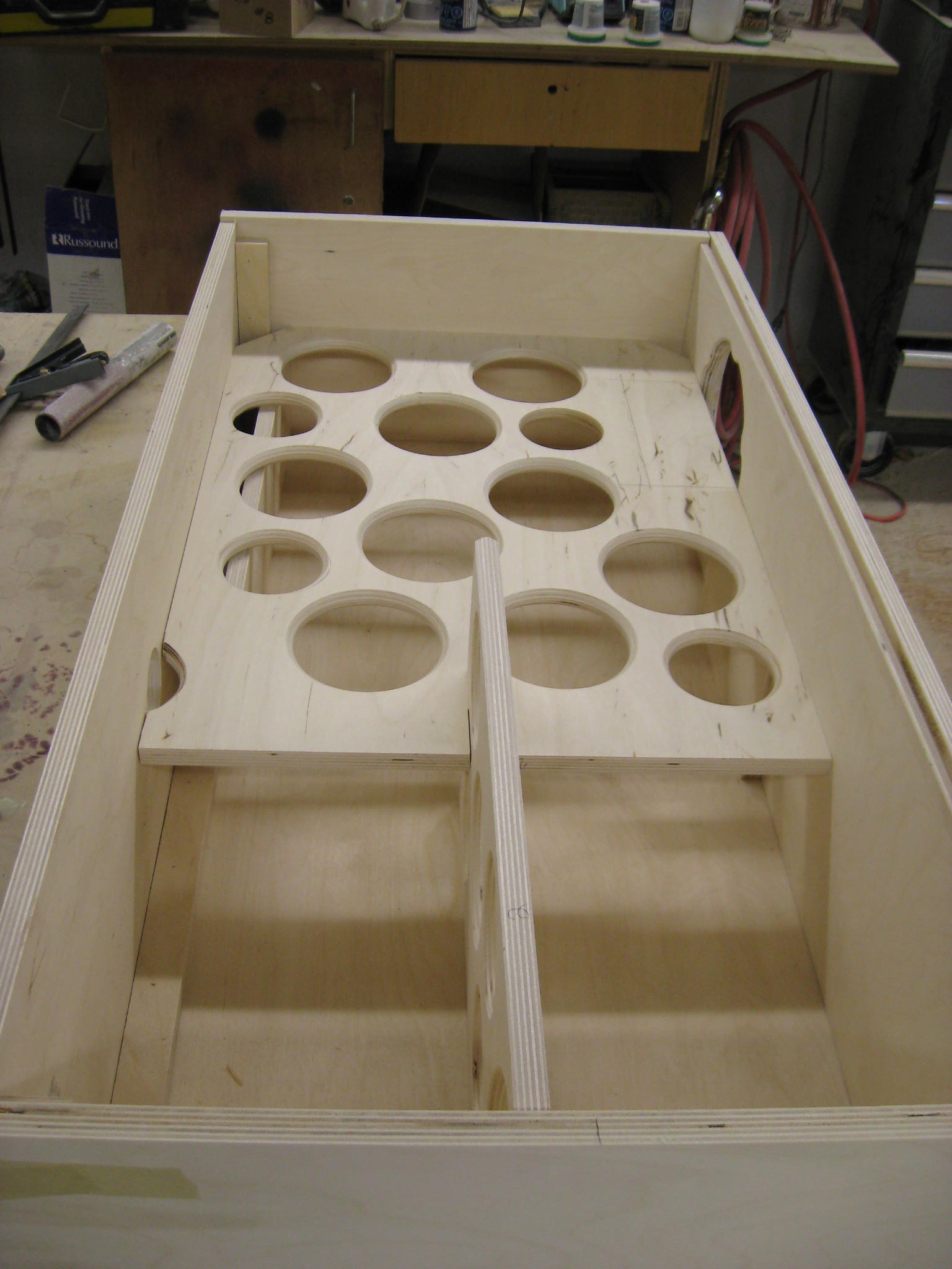

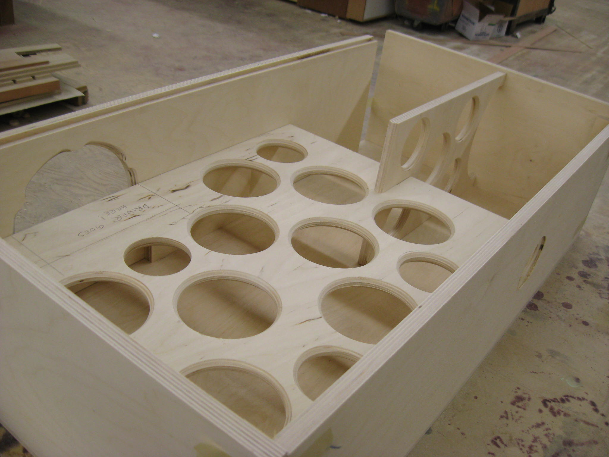

Yes, having assisted Jeff in fabrication and assembly his pair, I can attest the full monty SuperPensil for the A12P is not a compact enclosure - but still not as onerous as some of the large Fostex / Nagaoko manifold horns for FE206 /08 etc.
Here's a couple of photos from the assembly of Jeff's Supers that shows our own take on bracing as well as some of the cleats for the removable back panel. I like to use dadoes on the side panels to add some extra glue surface area and joint stiffening.
Not shown is lining of top portion of inside panels with 1/2" ultra-touch and the fibre fill. This was approx 5 yrs ago, so the amount of fill finally settled on has escaped my recollection.

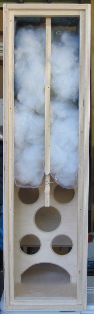

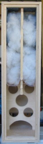

Geez, has it really been 5 years.😱 I haven't changed the polyfil stuffing in all that time. I think the bag had around 560grams in it, divided between the two boxes. I used some dress makers tulle to hold up the polyfil.
