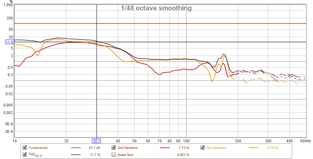

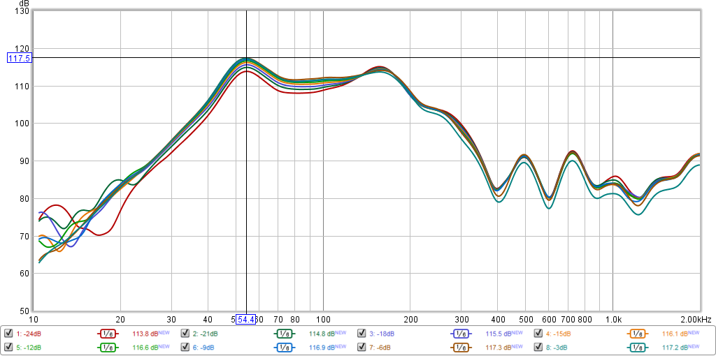

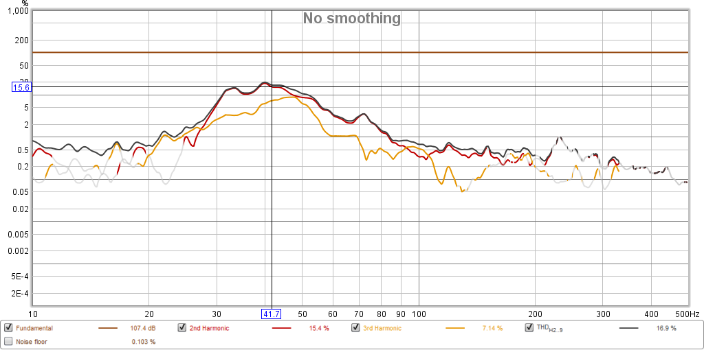

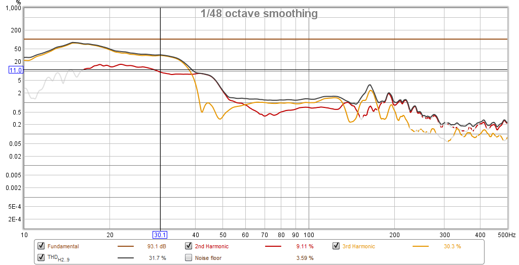

I thought I might share some more info on the distortion / linearity testing just in case anyone's interested, and also provide some background on why I chose to use a 30 Hz HP filter with this build.
For my linearity tests, I usually run some quick sine sweeps (not long enough to heat up the voice coil by any noticeable amount) and use REW (test signal set to -3dB) to measure the frequency response and distortion until it reaches about 10% in the passband (for the Enigma, the passband is about -3 dB +1.5 dB from 38 Hz to 115 Hz). Note: This requires some careful positioning of the mic to get right, which also requires a bit of experimentation - too close to the subwoofer and the mic gets overload, too far from the subwoofer and too much of the environment gets into the measurements. The start and end of the sine sweep also needs to be chosen carefully so you don't end up trying to push the driver significantly pass its excursion limits outside of the subwoofer's passband.
Once I've established the best position for the mic, I redo the measurement, and for each measurement cycle I drop the test signal by 1 dB or 3 dB, depending on how much detail I'm looking for. I usually stop around -24 or -27 dB. I then adjust the measurements in REW by the same amount that I dropped the signal. If the subwoofer remained perfectly linear for each signal level, the measurements will also align perfectly (yes, I'm assuming that the mic remains linear throughout the measurements. In any case, if it doesn't, it will make the results look worse, not better). Vent compression shows up pretty quickly in these tests, based on some of the results I've seen. So does any in-line limiting that may be in place (like the lightbulb type protection that Bose likes to use). Another thing - I choose 10% THD as my limit, but it's perfectly acceptable to choose a higher distortion point, particularly if the subwoofer is destined for PA use.
As for the choice of the 30 Hz filter?
The first image shows Enigma2's distortion when driven at a level equivalent to 70W into 8 ohms. While distortion at 40 Hz is around 10%, distortion at 30 Hz is almost 32% at the same signal level and continues to rise below that, and it consists primarily of odd-order distortion, a clear sign that the driver is exceeding its linear excursion limits.
The second image shows Enigma2's distortion at 6dB below the "70W" reference. Distortion at 30 Hz is now much lower, at just under 12%. So, it stands to reason that if I use a HP filter at 30 Hz (e.g. 24dB/octave, -6dB at the corner frequency of 30 Hz), then I wouldn't have to worry about the driver being overdriven at any frequency at or below the subwoofer's passband, once it's driven at 70W or below.
In reality, I am being over-cautious doing this, as the vast majority of music doesn't feature any information below 40 Hz (and a good portion of that doesn't have much below 50 Hz either), but I wanted the new driver in the Enigma2 to have the best chance of survival, given the environment that it's going to be used in (and what tends to happen at that bar). Maybe after a few months, if it has survived intact, I'll move the HP filter down to about 20~25 Hz, to minimize its impact on the subwoofer's passband.
The third image shows what the impact of such a filter can have on the distortion profile. No, that's not the Enigma - that's the measured distortion for one of my brother's KSubs. The KSub is an active 4th order bandpass design using 2 12" drivers, and from the distortion profile, it looks like there's a 35 Hz (or even higher) HP filter applied. The inband distortion of this KSub was quite a bit higher than I expected, but I didn't have the time to take it apart and find out why.

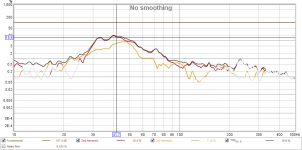

For comparison purposes, here's a linearity test of the Bose AM7 bass module that was replaced by the Enigma2. The result is not as clean as the Enigma2's, and I suspect at least one of the drivers in the AM7 bass module has some sort of mechanical damage. Not only is it noticeably non-linear around 50 Hz, but the non-linearity is the reverse of what I'd expect to happen (instead of the output compressing, it actually expanded a bit as signal level was increased from -24 dB to -3 dB). And there's definitely some sort of limiting going on at -3dB - check how the graph deviates from the others about 200 Hz.
I'm going to be picking up the AM7 bass module tomorrow to take a closer look at it, and to see if I'm correct about the drivers.

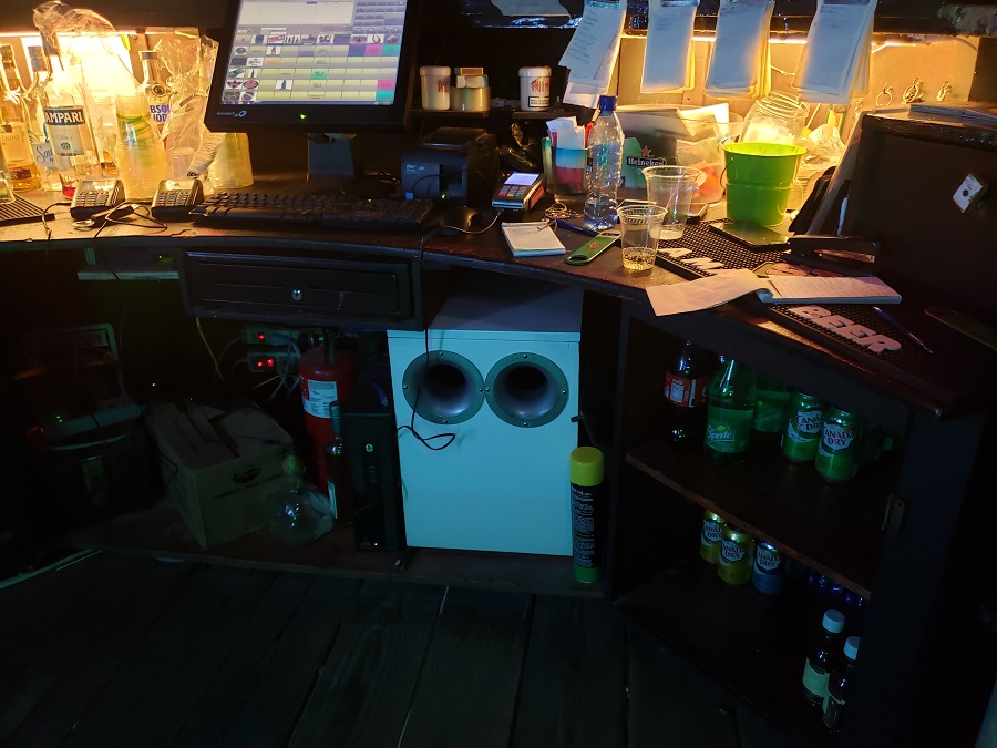

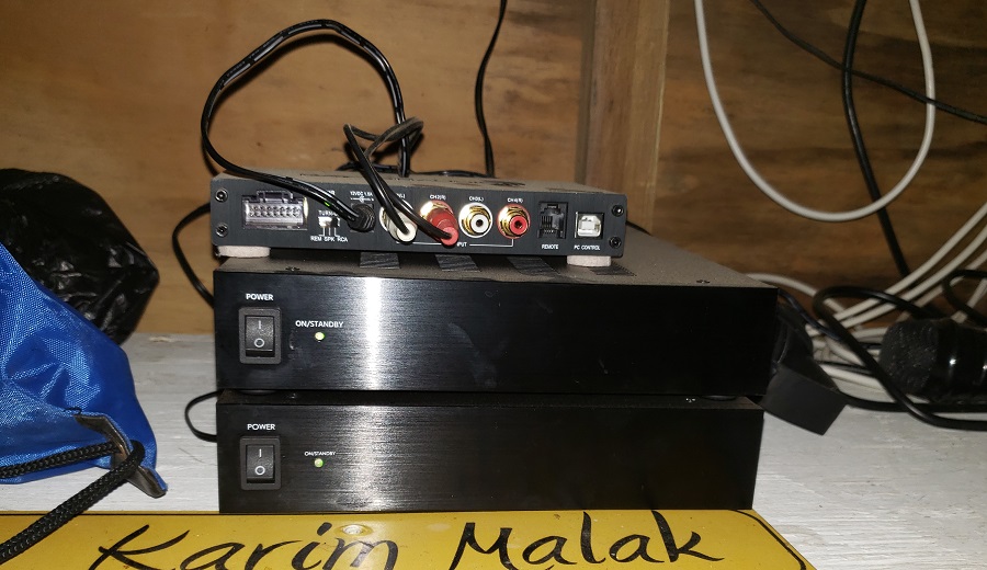

Some quick pictures, taken of the sub in operation.
First one with the sub located under the bar (yes, yes, yes, not the ideal location - I wanted to put it in a corner to get the best results, but the bar is small, they'd already wired up that spot for a subwoofer, and there were no corners available!). Sigh - that's the kind of thing that happens when the audio guy is called in AFTER the bar is built to give advice and produce solutions. Well at least the subwoofer's bandpass arrangement makes sure that no-one can easily throw a drink on the driver (unless of course they throw said drink through one of the vents).
The second one shows the amps and DSP-408 hooked up. Sort of a "temporary" install, as they were going to do some cleanup work at the bar and I didn't want to do anything really permanent before that happened. If you know the size of the DSP-408, you'd know that these amps are pretty tiny. Dust appears to be an issue. In the past, I've made plastic inserts to protect important equipment input/output ports from dust (or just taped them up) - looks like I'll have to do so for that DSP-408.

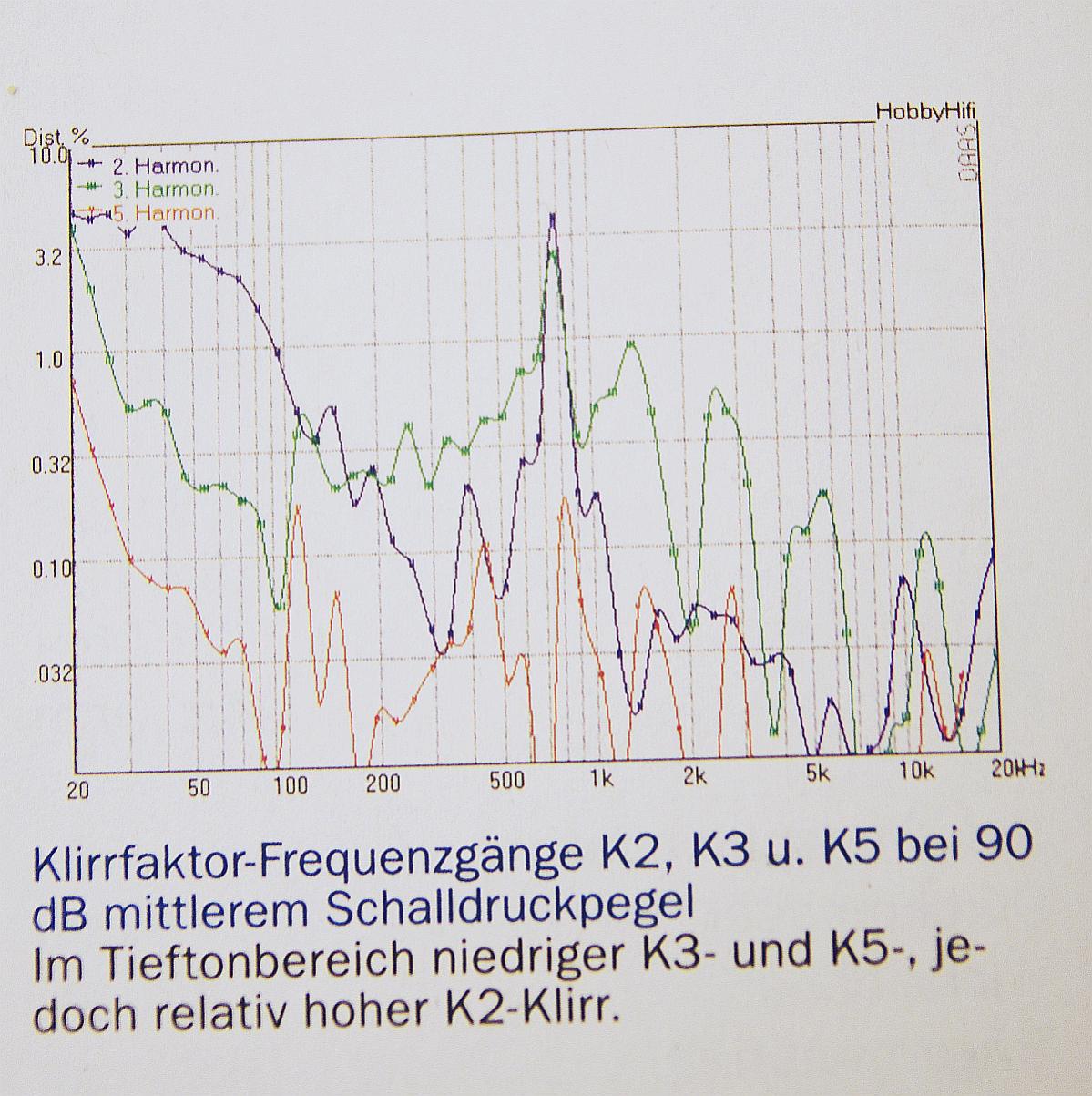

Here's a measurement of a Wavecor Subwoofer (SW280WA01), with the same Xmax as his driver, which exceeds 1% distortion at 100Hz at just one single Watt!. And 5% at 30 Hz. Again, at just a single one Watt.
You want to report me? Yes, please do so, but please give a prove that what I said is wrong and post a measurement at SEVENTY WATT of ANY BP subwoofer with a single 10" driver with 10% or less THD at 30 Hz and 70 Watt!

When I referred to "10%", I was referring to the subwoofer's useable PASSBAND, which is about 38 Hz up to about 115 Hz, going by the -3dB points (some people go by -6dB points, others by -10dB points, I prefer not to engage in that sort of marketing-speak).
Go back to my previous posts and you'll see that I always make a point of referring to the passband when quoting the distortion figures for the subwoofer. 30 Hz is BELOW the subwoofer's passband. Distortion there is higher of course at 70W, hence the use of the HP filter that I referred to in Post #87.
Now, if you have a problem with the measured distortion that I've quoted for the subwoofer in its passband, then take it up with the creators of REW, the software I use for measurement purposes. Because the results of the measurements are pretty clear on that subject and there's not much you can get wrong in the measurement process.
BTW, that graph you provided really doesn't prove much, because there was no mention of what alignment (if any) the driver was used in for that measurement, and you know that will have a significant impact on the measured distortion.
