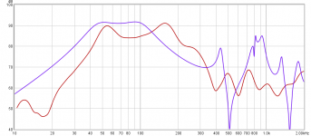

Here's how the sim'd response of the DA270-equipped sub (blue) compares to the measured response of the Bose AM bass module (red) that it's replacing. I suspect that the Bose bass module was damaged, but I didn't have enough time with it to test it completely. So please don't take this as the "official" response of that model. It's from an AM7 set, btw, not an AM5 set.

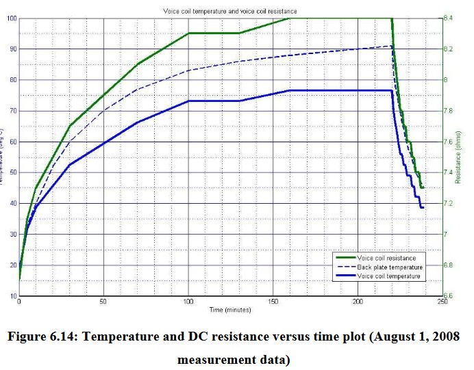

He also wrote:
6.3.3 Drawbacks and limitations There were a number of drawbacks and limitations during the experimental process. With the available equipment, it was impossible to directly measure the voice coil temperature. Instead, a thermocouple was placed very close to the voice coil on the magnetic structure. This gave a reading that gave a good idea of the heat transfer that was taking place in the driver. To find the actual voice coil temperature, the DC voice coil resistance had to be monitored and then used to calculate the temperature.
So, yes, he did your method but now please look at this graph:
You can clearly see the exact correlation of the pole plate temperature and VC temperature. You can also see that it is not, as I already said, a linear development but a curve. And, if you've paid attention and actually read the paper, he said that that the back plate always had a higher temperature than the VC of about 15°C. (7. p45, 2nd & 3rd paragraph). When the magnet temperature reaches its top plateau, the VC temperature still rises though, meaning you have to stop there. That means, it doesn't matter how much the resistance is increasing since you only have to observe the 'saturation' of the magnet because of the correlation. And that's exactly what I was telling you already.

*sigh* You obviously did not read the paper yourself. Or understood it.
...yes, and look at the horizontal scale of that graph. It's in 50 MINUTE segments. I want a build a solution that will trip the circuit breaker if the driver sees 100W for more than a few SECONDS. How is it applicable to what I want to do?
No-one is disputing that! What you have failed to show however is how is it relevant to what I'm trying to accomplish.

I didn't think that either initially. Adam Hill described the mechanisms partly in 4.6, p22ff. He did a mistake though:
Additionally, the larger the air gap (both wide and deep) the greater the heat transfer capacity.
That's wrong because a higher distance would mean, the pole plate could not take up as much heat as a close distance by radiation. That's easy to verify, start your soldering iron and put a finger 3cm away from it and then 1cm. The shorter distance does indeed transfer much more heat and it's practically just readiation. The air gap depth does provide more heat transfer though, that was correct. The same goes for the air, a tighter air gap creates a higher air velocity and the faster air will transport more heat away from the VC. The losses are higher but the cooling is improved. That's also why you won't find raised spiders in PA drivers, that would eliminate a lot of the air velocity and movement. The cooling is much more important in PA than in Hifi and that's why they have often such elaborate bore patterns for the back pole plate at the diameter of the VC and sideways air channels between basket and pole plate.
I'm not very fond of that paper since he didn't describe how he measured the VC temperature. I got the suspicion he just calculated it from the resistance and did not measure it directly, since he only mentioned the equation.
Anyway. A possible explaination for the magnet being hotter than the VC could be because the VC could dissipate more heat through the air because of its movement.
Actually he did. under section 6.3.3. "With the available equipment, it was impossible to directly measure the voice coil temperature. Instead, a thermocouple was placed very close to the voice coil on the magnetic structure. This gave a reading that gave a good idea of the heat transfer that was taking place in the driver. To find the actual voice coil temperature, the DC voice coil resistance had to be monitored and then used to calculate the temperature."
So it looks like he just calculated it from the resistance.
It doesn't make sense to me that the supposed source of heat (the voice coil) would be at a lower temperature than the sink (the magnet structure). Heat flows from hot to cold, not vice-versa. He mentioned that he used the DC voice coil resistance, which implies that he used DC voltage to take the measurement. As the coil is a lot smaller than the magnet structure, it likely cools a lot faster, so perhaps the difference is due to the amount of cooling that took place between when he was doing the FR measurements and when he switched to using a DC input to measure impedance. With that in mind, I'd have done the test slightly differently - used a pure tone @ Fb, use that to calculate impedance, then switched to the MLS and sweep signals for FR.
It does not dissipate 100W, ~2-3% go into the movement. 😀
It's still dissipating 100W - some into sound and the rest into heat 😀
As there is little space to invert the woofer, is transforming the enclosure to a parallel 6th order
I tried looking at that - the chambers are too small. I couldn't get any driver to work and produce a response that I felt comfortable with.
Converting the box into a series-tuned 6th order BP and using an Eminence pro audio driver did look interesting (discussed earlier in this thread), but the cost to do that would have been considerably more than the ~$40 I've spent on the replacement driver.
