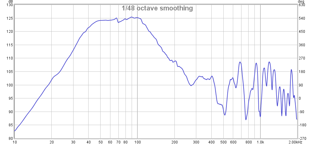

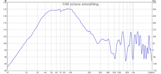

"Enigma 2", using the Dayton DA270 driver, raw response. +1,-3dB from 39 Hz to 120 Hz. Except for one or two minor peaks, all of the out of band noise is 20+dB below the passband, and the first (and most annoying) out of band resonance (around 400 Hz for this design) is significantly reduced.
I haven't finished working on the box yet (still have to experiment with lining the vented section, to see if I can get the out of band noise down even lower), but this looks very promising.

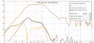

Distortion measurements also look pretty good, considering the limited Xmax of this driver, which suggests that it will start being noticeable @30W around 40 Hz (it definitely is not a subwoofer driver, LOL). Note that the THD is primarily 2nd order HD - the acoustic bandpass filter is doing a good job of keeping the higher harmonics down, and it looks like the box dimensions and layout are also nulling out 3rd order HD at 40 Hz. I could claim that was by design, but it's pure luck 🙂

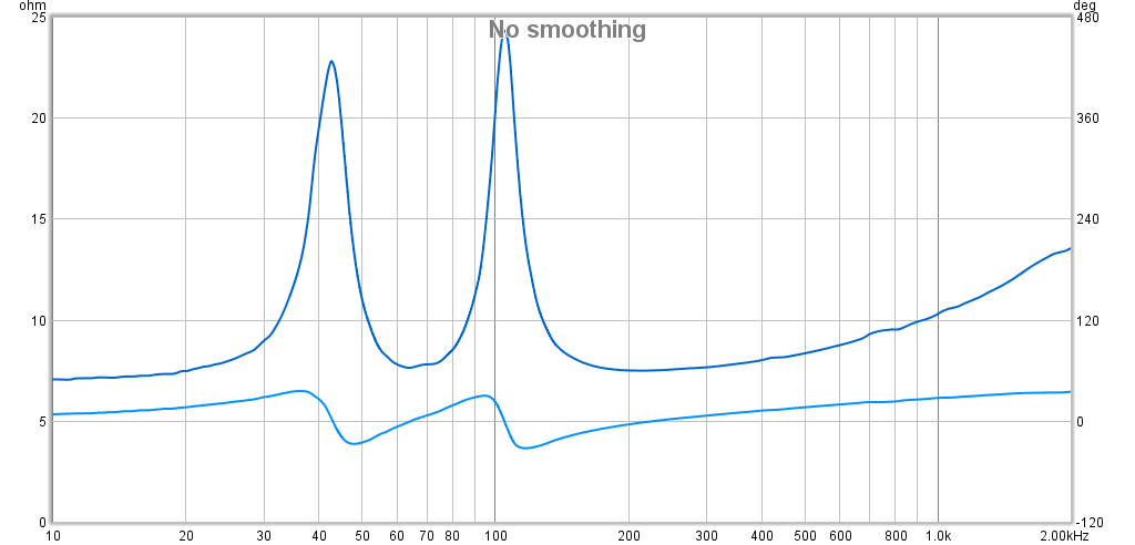

Looks like I built this box well. The impedance peaks are 22.8 ohms and 24.3 ohms. There's likely a way to estimate the box losses from the difference between the sim'd and actual impedances, but I don't know how to do this. In any case, this means that the driver is only going to see 35W and 33W at those frequencies, if driven with at 100W amp.
I don't doubt your box works fine but the almost equally high impedance peaks do not imply it works well. In the old days it was a rule of thumb the two peaks had to be almost of the same height, nowadays there are tons of speakers which divert from that rule and work very well too. Back then it was an easy way to approximate how a speaker (sub) works since the fast Fourier transformation could not be applied because of lack of processing power and a correct low frequency measurement was impossible for most folks because of the requirements of the measurement (nearest reflection surface, measurement distance and room modes/influences). A lot of non-equal-height-impedance-peak speakers sound great and there are quite some speakers which fulfill the equal height impedance rule but sound awful. In reality this rule applies only to a narrow range of Qts/Qt (~Qb3 ideal) and can divert a LOT from that to get great results since the room gain and frequency response is different for every setup and room and personal taste.
That's not what I was using as my point of reference. My point of reference is the magnitude of the impedance peaks predicted by the sim, which assumes no losses. The closer the measured impedance peaks are to the sim, the less "lossy" the box is.

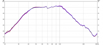

I had an opportunity to do a few more power tests this weekend. Some notes:
I used my car's 1.2kW (into 4 ohms) amplifier to do the testing, as my usual test amplifier was not available. I had to add 8dB of gain at the deck to achieve 23.3V at the deck's volume setting of 40, my usual volume setting (unless it's the weekend). This is interesting, as that means that at the amps' normal gain setting, my car's two 12" subwoofers that present a combined 2 ohm load to the amplifier would only be seeing about 43W total, or about 21.5W each, if my calculations are correct. No wonder my car's system seems to have so much headroom at bass frequencies...
- I was able to driver the subwoofer with up to 23.3V until measured distortion got over 10% in the passband. The THD significantly increased below this (as predicted by the sim'd driver excursion). Going by the distortion graph, a 30~35 Hz 12dB/oct HP filter will increase the subwoofer's power handling as far as THD is concerned.
- 23.3V works out to about 68W into 8 ohms, or 70W into the subwoofer's measured minimum impedance in its passband. Current draw at that impedance works out to 3A.
- The subwoofer's output remained very linear right up to that distortion limit. I suspect that this is one of those bandpass builds that sounds very good at higher and higher SPL levels - until you don't hear any sound at all, LOL. Who says that small signal parameters produce sims that are only accurate at small signal levels? 🙂
- Leaving the amp's gain at the point where it was generating a 23.3V sine sweep, the subwoofer played back a wide selection of music for about two hours without showing any audible signs of distress. It was also loud enough to provide background level music at the bar IMO.
- The inline PTC did not trigger during the testing. I suspect that was due to the length of the sine sweep test signal, which was not long enough (the PTC device needs to see double the rated current for at least 5 seconds before triggering). It also did not trigger during the music testing.

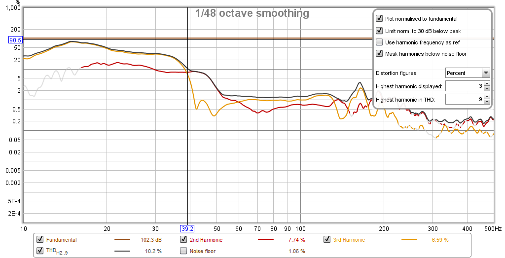

...and here's what the THD looks like (normalized to the FR) at 23.3V. Even at that level it remains around 1.2% from 50 Hz up. Below that the driver's excursion starts to have an impact, and at 39 Hz it's at 10%. That's why I think at 30~35 Hz HP filter should help reduce reduce distortion and increase mechanical power handling, if necessary.
Those little bumps just about 160 Hz? There's something buzzing inside the enclosure at high input levels. I haven't figured out what it is yet. It's quite a bit outside of the subwoofer's useful passband in any case.
