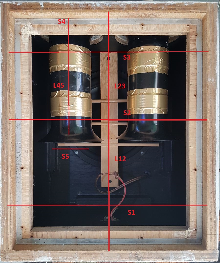

Based on this image, looks like you have the vented magnet in the ported section. I say the speaker should last for awhile since the motor is getting cool air while playing.

Will the subwoofer hold up under long-term use? Well, it's only been a week, but it has been used every day of that week for fairly long periods. If it doesn't blow first, I'll do an impedance check on it in a few months to see if there's been any change.

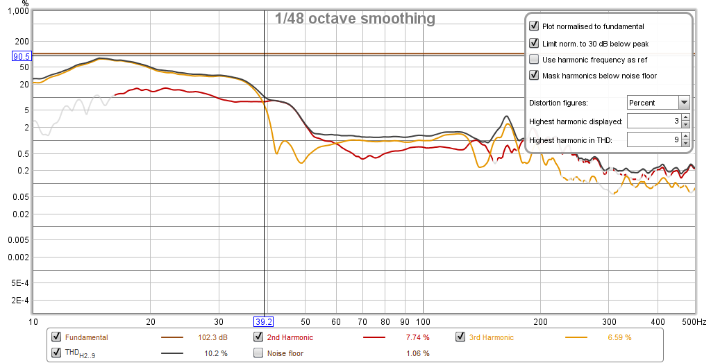

Hmm, so what else is distortion but what you just mentioned ?? Good grief man, are you trolling me or something? 🙂
Yes, *some* mechanical noise may make it out of the port - most of it however is filtered like basically everything else above the bandpass subwoofer's upper cutoff frequency, because the vented chamber acts as the LP filter - and ANY sound that originates in that chamber is subjected to that filter, including any distortion and mechanical noise generated by the driver. The Enigma is actually pretty good at doing just that, as is measured out of band noise is 15~20dB below its passband, when measured with a sine sweep. Even when driven to its 10% THD limit in its passband (which occurs around 40 Hz, and at 23.3V, the equivalent of 70W into 8 ohms (the driver's power rating, btw), measured distortion at higher bass frequencies (where most bass in music is found) is significantly lower. At 50 Hz it's just above 2% and above that it's around 1% or less. Good luck hearing that when playing sine waves, much less music 🙂. When playing most music, the only indicator that this sub is at its limits is that it just stops getting louder.
