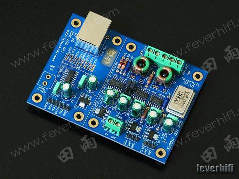

My suggestion will be simply ditch this SPDIF thing. Check out this nice I2S solution. And yes, it is available now! Interested? 🙂

Here is the link of the reclock assembly selling for RMB138 (about $18 usd). I do not understand why the price is even lower than a so call low jitter XO in US or Europe. Also I am sure that selling at this price will no way may the seller rich.
http://www.feverhifi.cn/viewthread.php?tid=1067&extra=page=1
