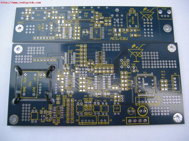

The photo I posted above is a FIFO/DDS solution for a CD transport done by a friend. Yep, it's for the transport output! You can put the same thing to the output side of transport, really. Unfortunately this board was done back in 2006, not available anymore. I also have another one which does the I2S. Again, it's long gone, too.
People around me dont pay much attention to this anymore because everybody is working hard on SDD/HDD player solutions. When you have a 1GB SRAM buffer, you can simply dump the whole CD into the buffer then read the data out with a low jitter clock.
This is why we did not do much on reclocking in D1V3. Simple reclocking cant do much good. Instead, we expect you to have a good digital source then the little DIR9001 will be just fine.
Oh, the PIC thing. It's similar to the Lavry solution, just much simpler. Again, the hardest part is not in coding the processor. 🙂
